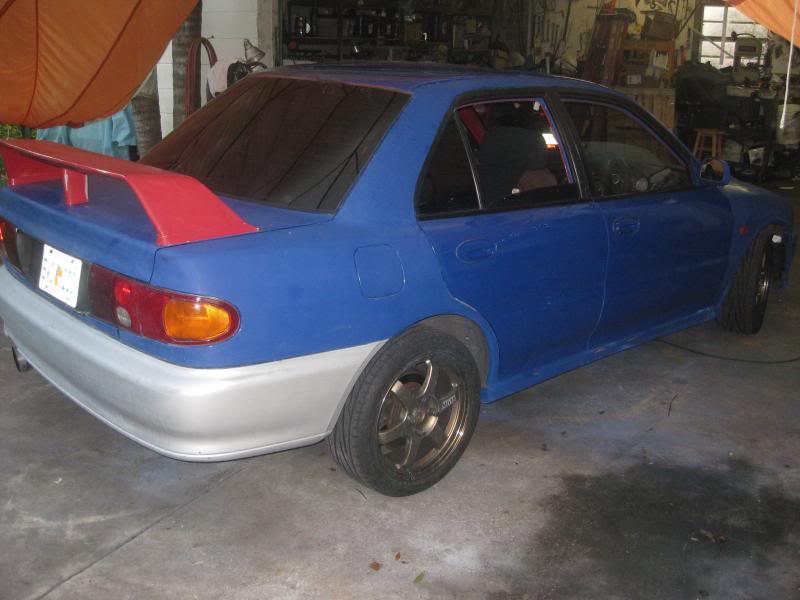

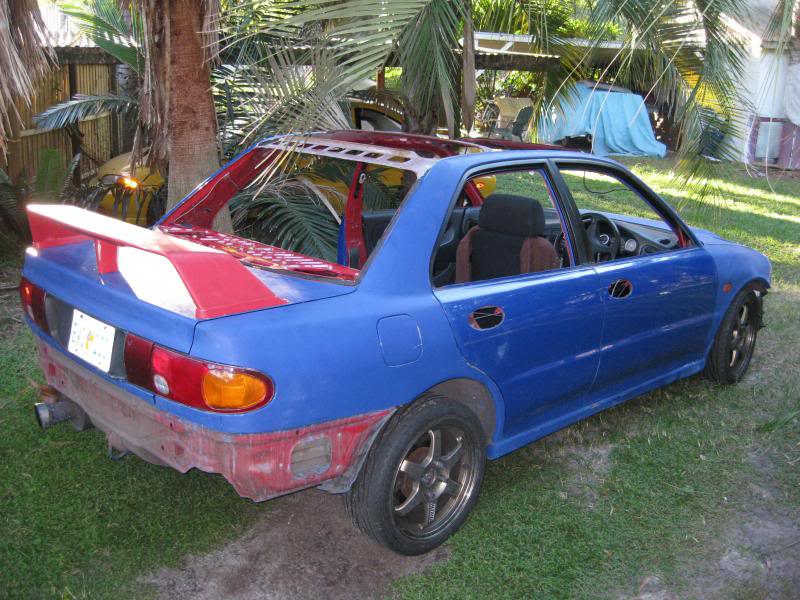

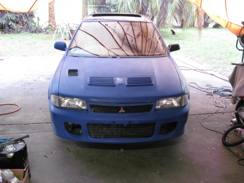

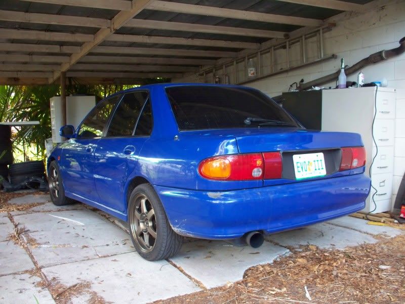

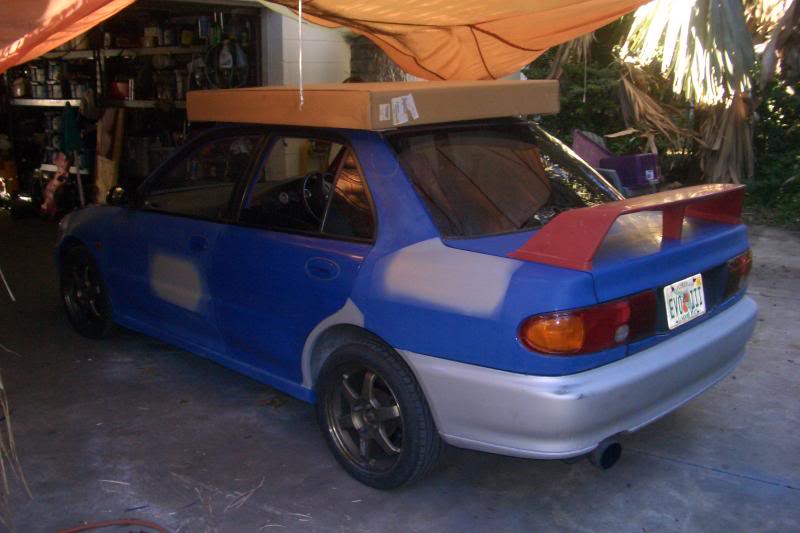

finally committed to repainting the car. car is soo much fun to drive I couldnt take it off the road. car was 2750lbs with 460whp at 24psi. finally upped the boost last week to 29psi. feels like a hole other car. now with the car partially stripped she weighs about 2600lbs. wow is all I can say. driving her at this weight. wish it could stay this light.

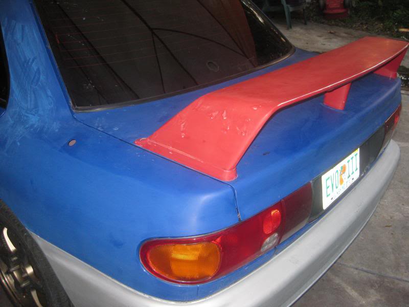

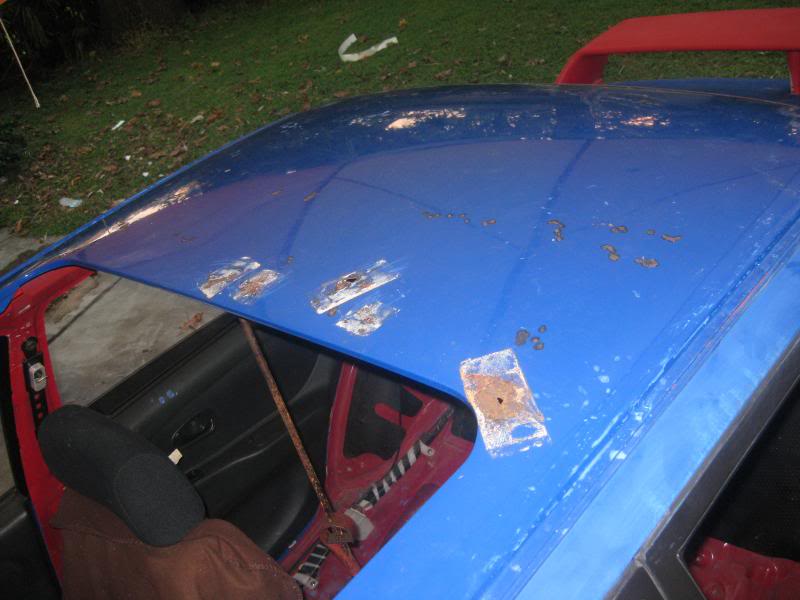

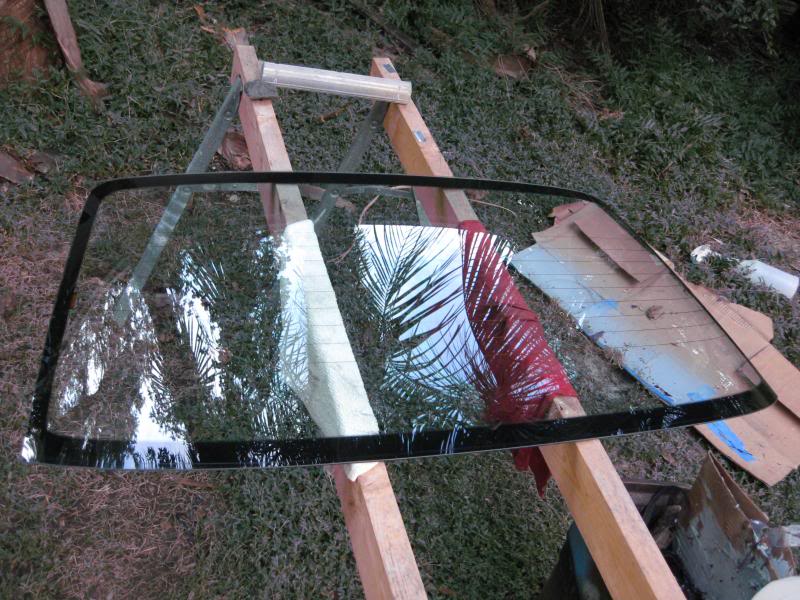

roof is in pretty bad shape. and the moment I lowered the sunroof assembly I knew it wasnt going back in. rear glass without wiper is easy to come by and cheap.. cleaner looking without. rear power ant not needed. can run stick-on windshield type when and if a radio goes back in.. rear speakers were still in car so they are coming out. going back to the original wing. I like it mostly because its much easier to see through rear veiw. but I think its cleaner looking as well. last I found some front springs from an acura that have the same spring rate as what I have now but are lighter. new paint does have weight. but will be happy if I loose 50lbs here. especially since all the weight is being removed from topside of car. will handle noticeably better. I tried wingless but didnt like the look.

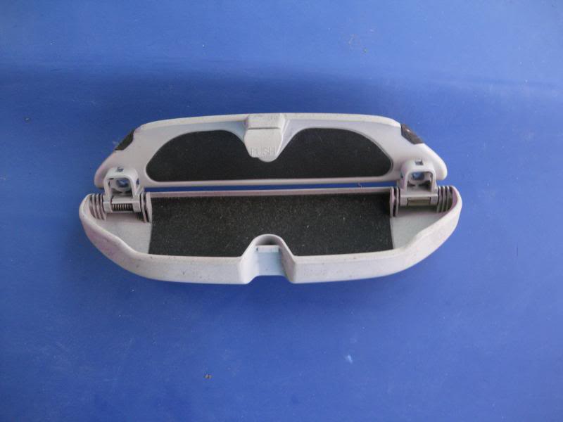

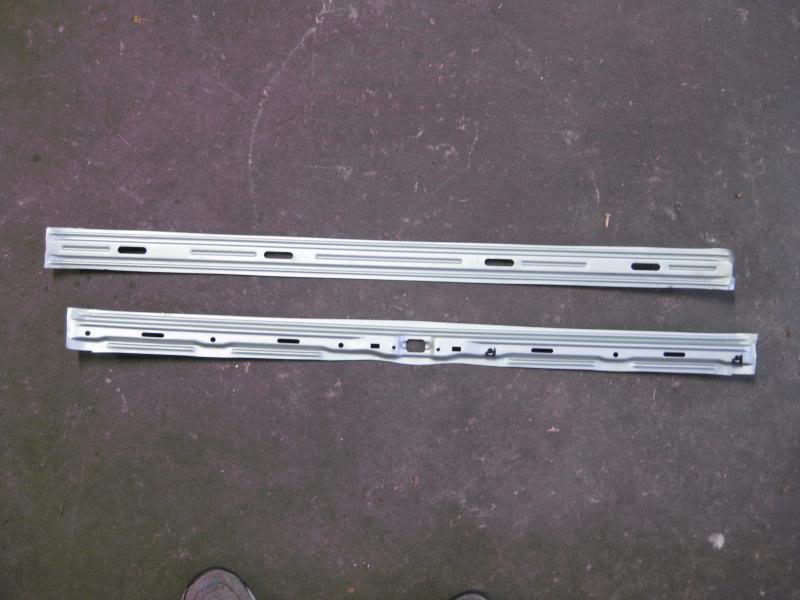

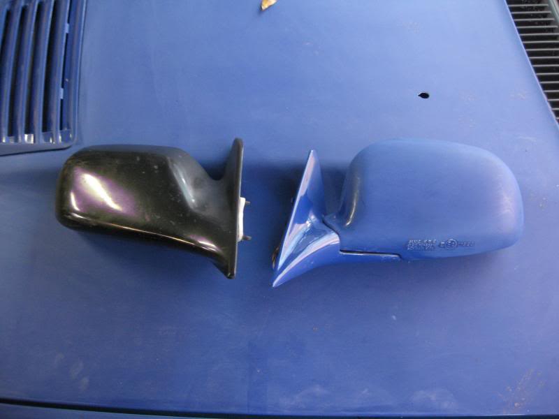

picked up some parts today from salvage yard. headliner, roof supports, rear glass, for the new roof. also picked up some lightweight manual mirrors. picked a cool sunglass holder that mounts in grab handle spot. (for the evo 4)

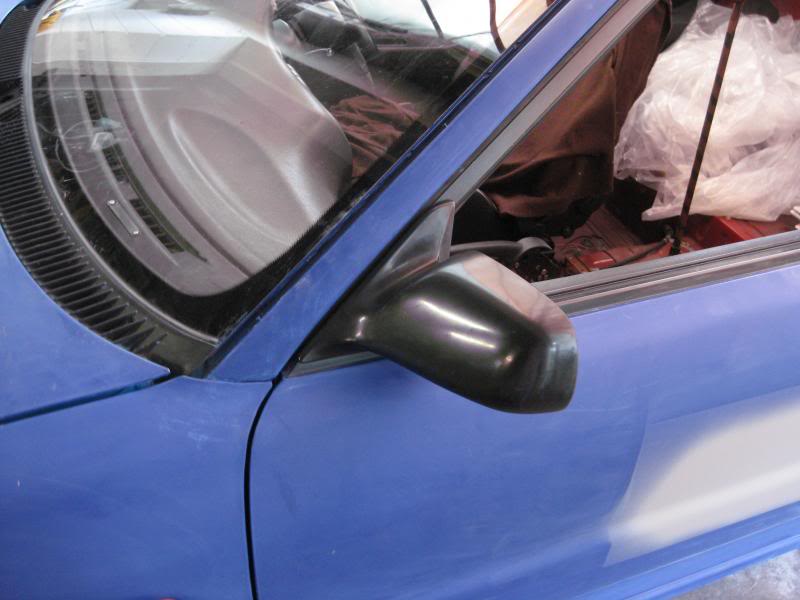

spent a couple hours trying mirrors from various cars. settled on mirrors from a 1991 corolla. very little work to make them fit. shaves 4 more lbs. less frontal and better aero. but look like they belong on the car.
