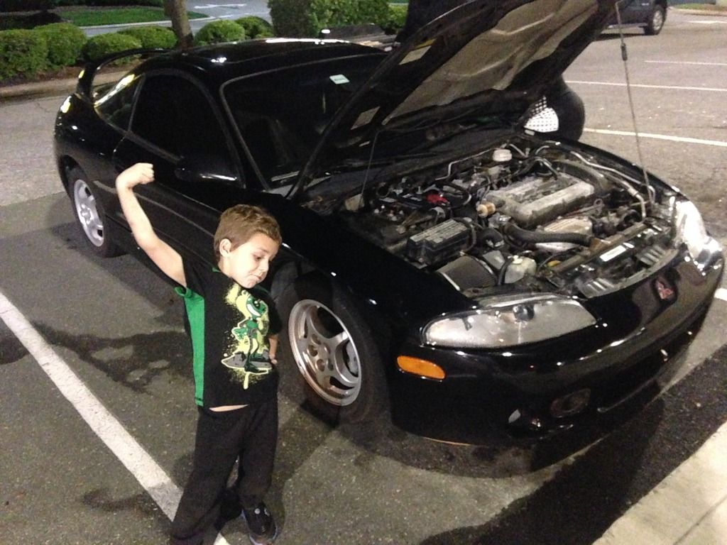

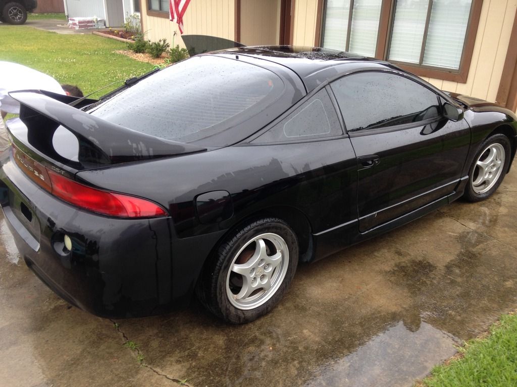

So heres some pics after the 2.5 hr drive to get it. With my son posing! Lol. I dont know what face he is making?

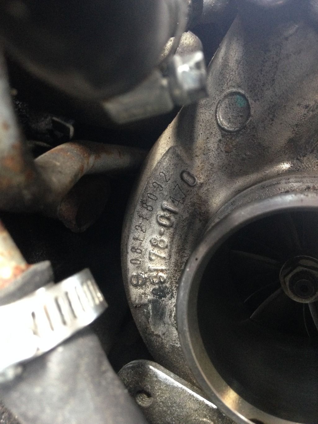

Found out the car has a 16G on it. IDK what injectors or tuning it has? I assume 550s? It starts up and idles perfect. Or...may be stock ones with a 16G? IDK. Any idea on how to ID injectors?

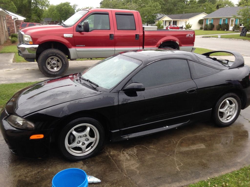

Got it unloaded and washed. A/C works - heat works-all works! Gonna try and buff the faded rear bumper, get a tasteful front lip and use quick disconnects.

Found out the turbo is a MHI Evo 3 16G.

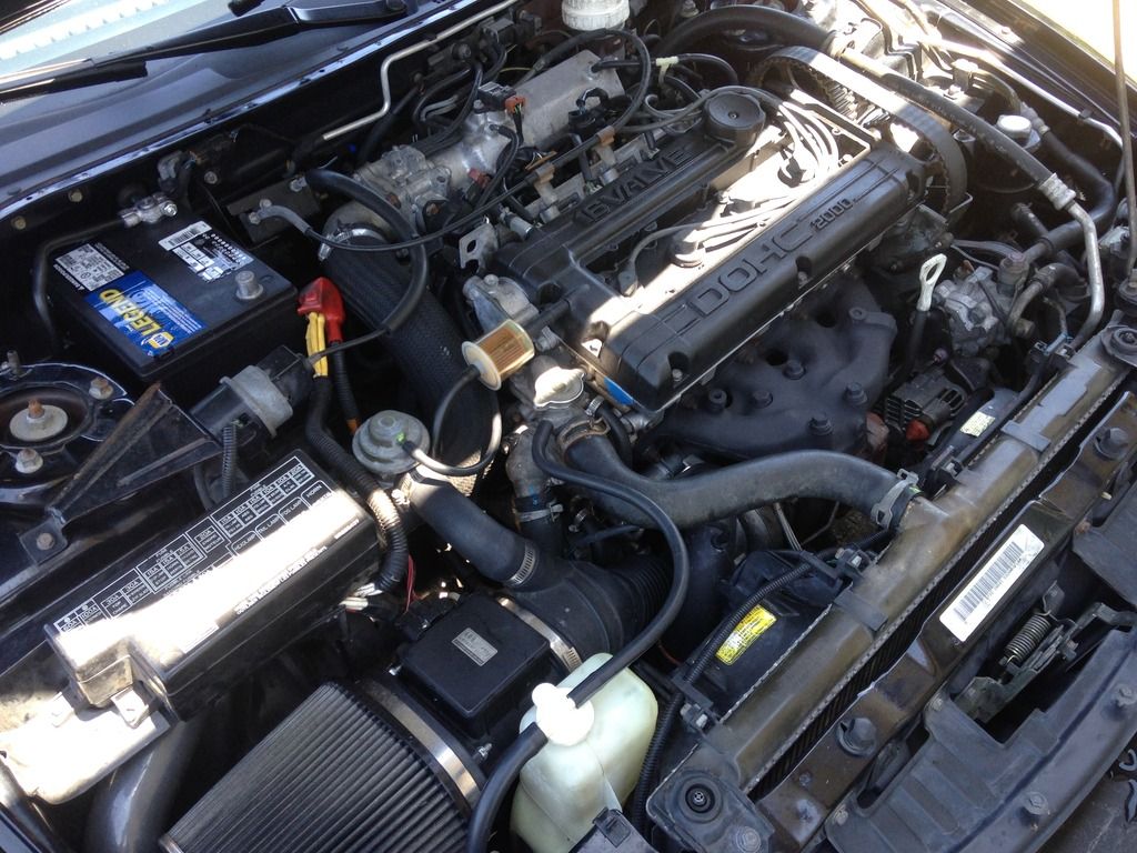

Found out the car is on stock fuel - not even a rewire. So I have to stay at stock boost less I run into issues. I plan on doing a pump rewire ASAP.

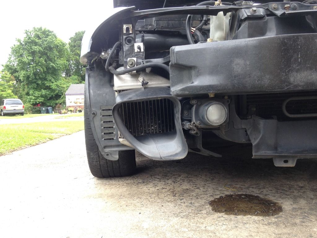

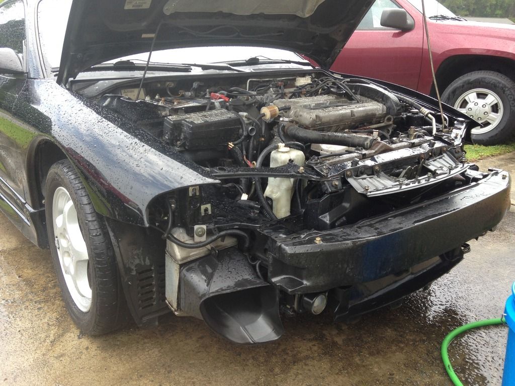

Pulled the bumper, it needs a little love - cleaned behind the bumper - looks mint. Pulled the headlights to clean and polish them up.
Pic:

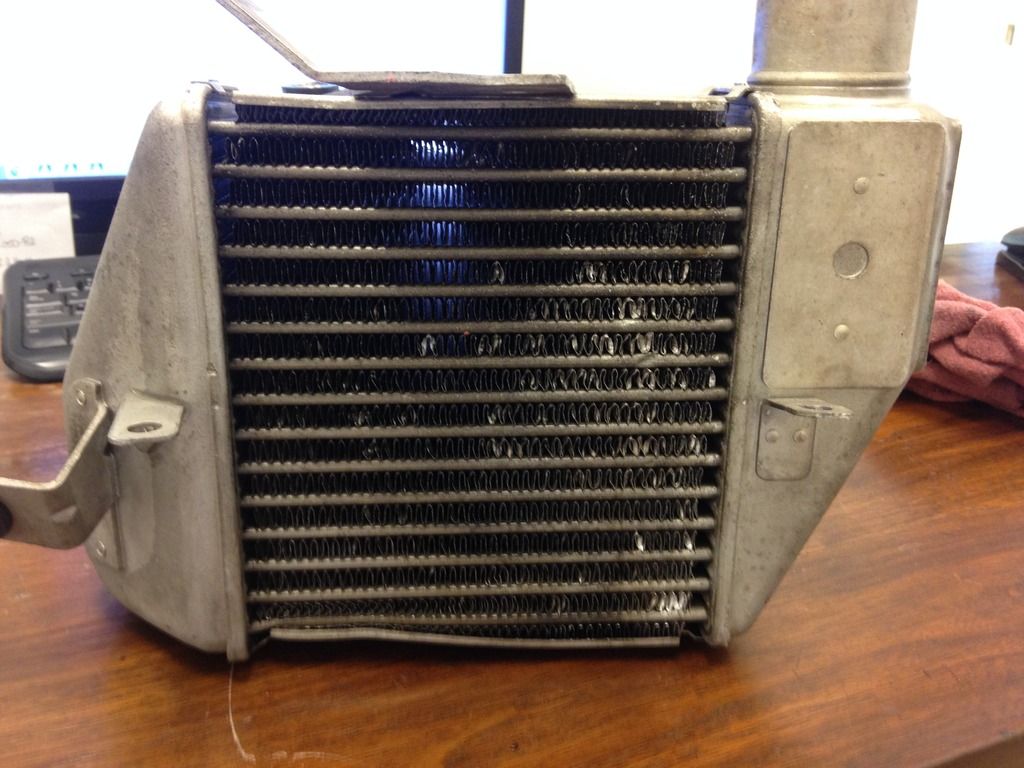

The SMIC was pulled as well because is was grody.....pressure washed it - getting new clips to hold the duct on proper and at work today I will clean the inside of it. I dont plan on going with a FMIC at least for awhile as my power plans are modest. 300 whp - full interior

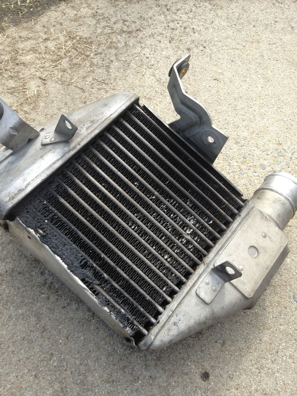

Took the SMIC to work, cleaned it out. Got new clips for the duct work. Found so far in this SMIC a rubber cap the size of a half dollar and a gob of rtv....I assume the PO tried to block off the BOV recirc? Bad pic.....sorry it was "jiggling".........
Pic:
All cleaned up....inside and out. Still not MINT - but a whole lot better than it was.

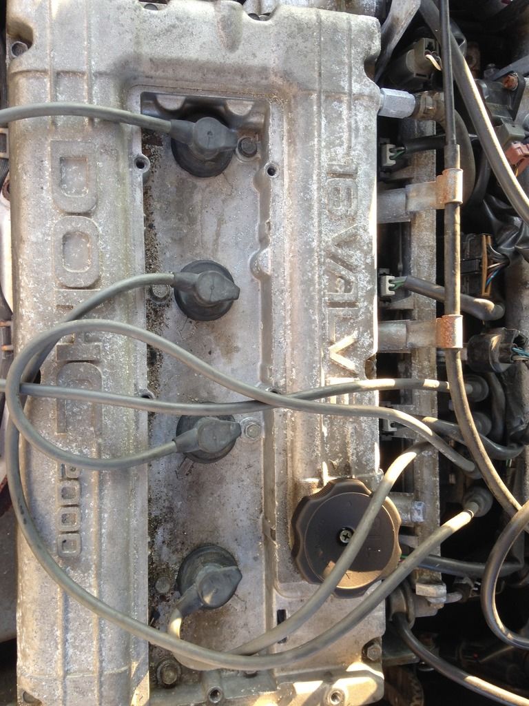

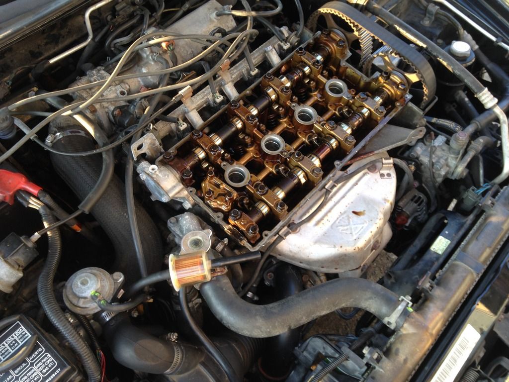

Pulled the valve cover today. Cleaned it at work and have begun to wrinkle black it out.
No sludge under the cover. Thats good. Will update.

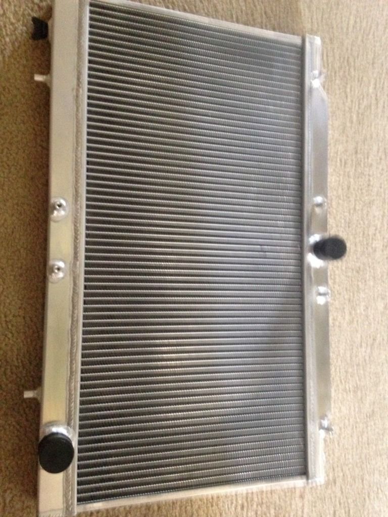

Really need a radiator. Anyone have a second hand one for sale? Prefer an aluminum unit.

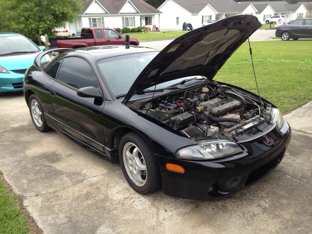

Still here......some updates.
Valve cover back on - cleaned up some brackets and painted them up.

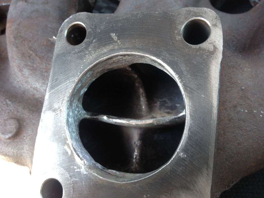

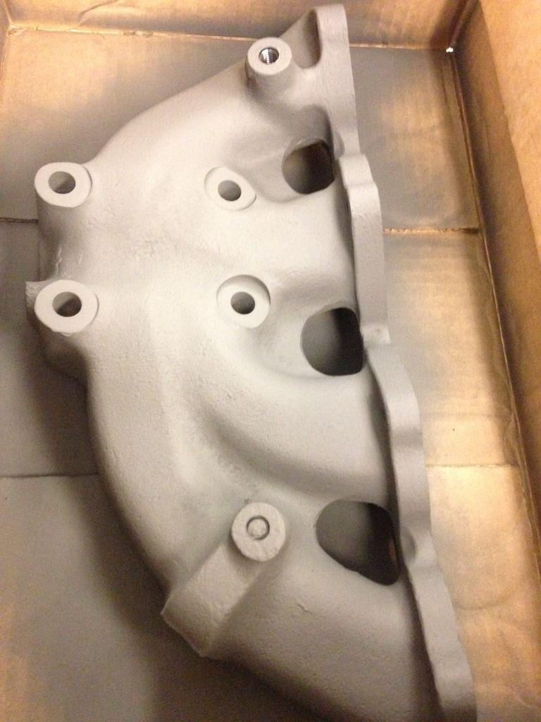

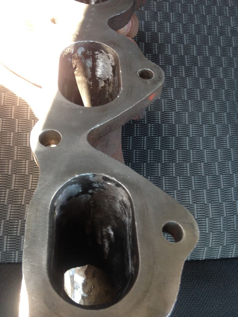

My manifold was beginning to crack. So scored one off of FB , and ported it along with some clean up and paint.

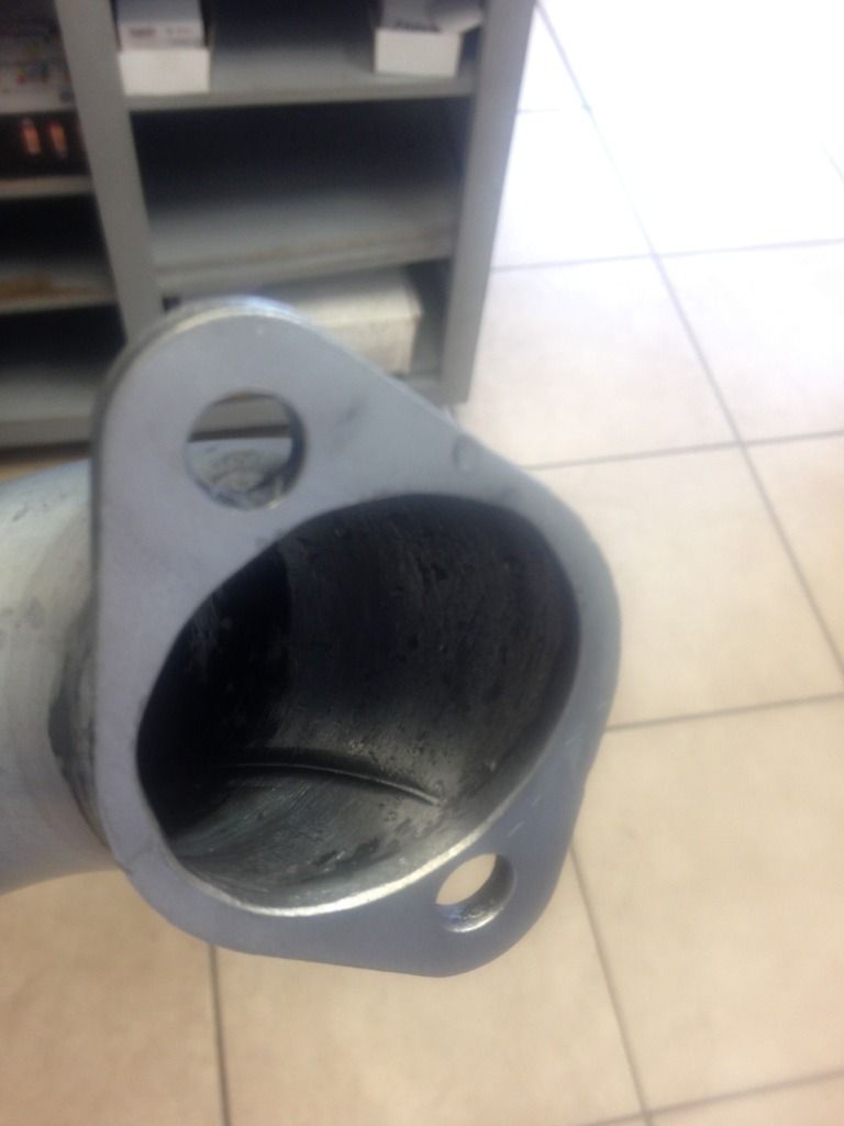

Ported the J pipe. Which I later found out was pointless.....

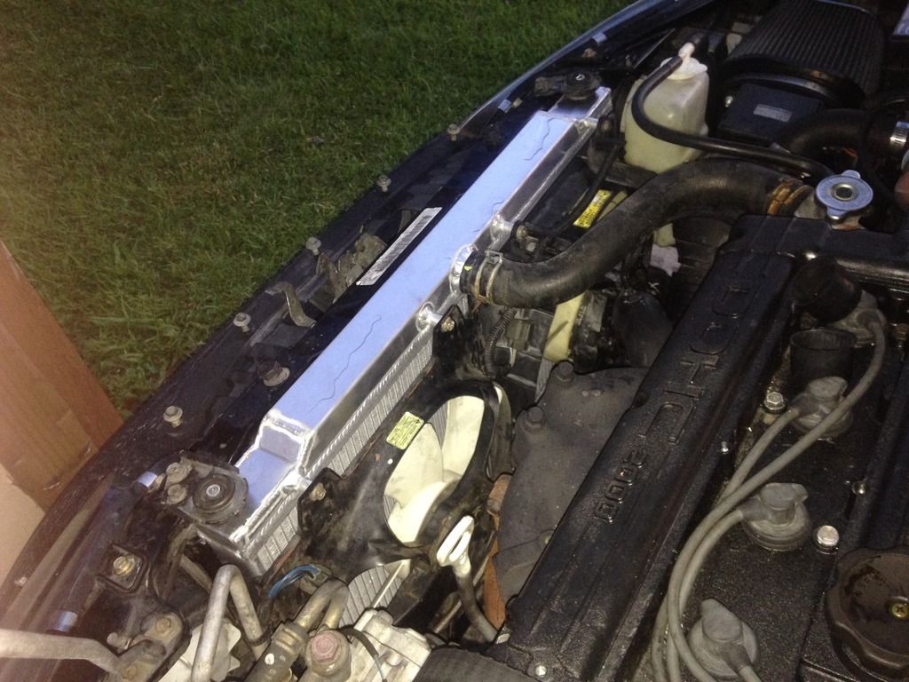

Found a radiator. CX Racing. - very nice actually.

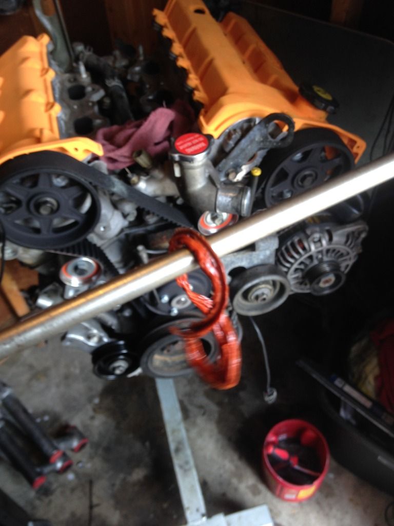

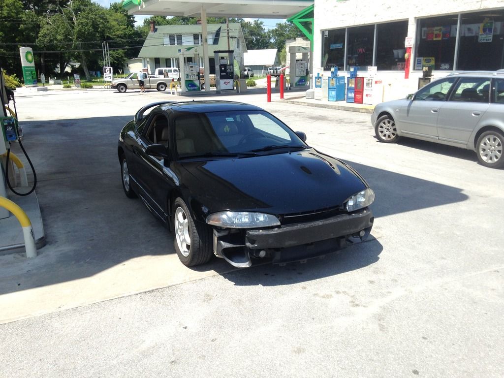

Drove it down to the gas station. Still no gears over I guess third? Trans is in process of coming out to rebuild. Some nice parts going in. Kiggly front clutches - IPT end clutches - valve body rebuild with IPT shift kit (translab) - maybe a larger cooler?
