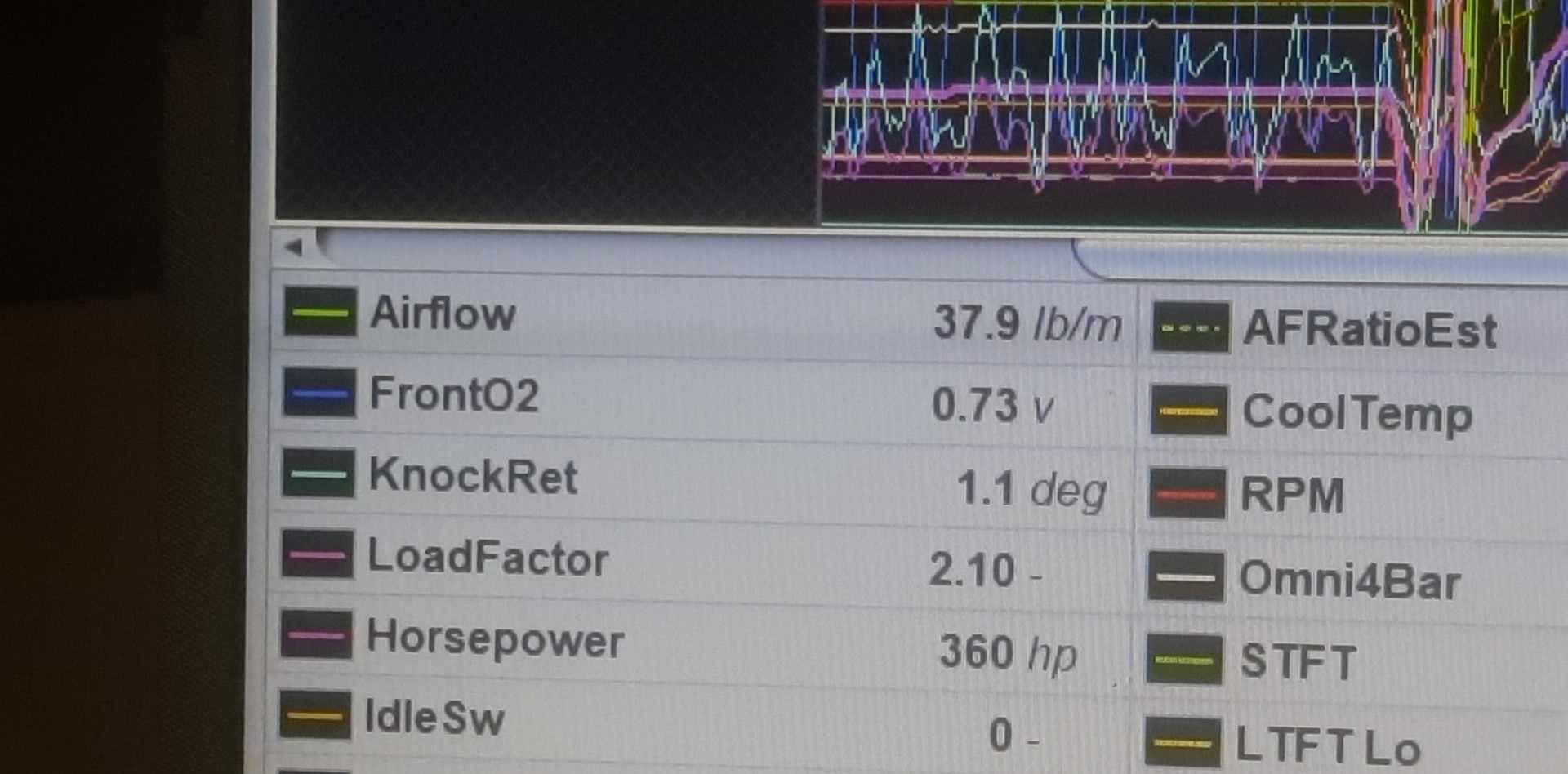

Getting better as we go. Car got a nice E60 mix tonight and was playing around with it a bit. 20psi on the 20G and we're right there at 38lbs/m. No changes in timing yet still only 13° up top, I believe im running out of fuel pump though. I noticed in the log during the pull it goes from E58 down to E53 by 7k RPM along with my AFR tapering from 11.3-11.5 up to 11.9 and it's only a 255 pump so time to get something bigger put in it. Super happy with it so far!
Awesome Build. At what point of boost pressure did the AFR taper to 11.9? Just curious because Im running a 255 as well.
This was a pull that started at 17psi creeping up to 21psi by roughly 6400RPM on E60, but im also running a 48psi base fuel pressure (need a new adjustable fuel pressure regulator. It won't let me go any lower) so I'm not sure if having that higher pressure will affect yours the same or not.
