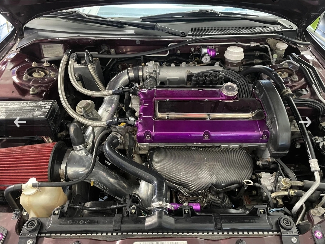

Mods-Bolt-on
Ported Small 16g
- Evo 3 o2 Housing
- Forced Performance Race Manifold
- Evo 3 Intake Manifold
- 1g n/t Throttle Body
- Punishment Racing Front Mount Intercooler
- 1g BOV
- 3" Turbo Back Aluminum Exhaust
- Fuel Pump rewire
- Prosport boost gauge
- Prosport oil temperature gauge
- Prosport oil pressure gauge
- Prosport water temperature gauge
- Innovate DB air/fuel ratio gauge
- Battery relocation to trunk
- Powder Coated Valve Cover w/10 AN Fittings
- Calan VS3 Catch Can
- Fuel Lab 515 AFPR
- Walbro 450 LPH e85 fuel pump
- FIC High Z 1650CC Injectors
- Galant 97 A/T alternator
- Hallman Pro Boost Controller
- Upgraded 3/8" fuel return line
- Megan racing radiator
- Hybrid racing radiator fan
- radiator fan factory wring bypass
Mods-Engine
- Evo 9 Valve Springs & Retainers
- ARP Head Studs
- Revised 3g lifters
Mods-EMS & Logging
- ECMLink V3
- Innovate LC-2 Wideband (Uninstalled atm)
- Speed Density
- GM Ethanol Sensor
- GM IAT Sensor
- Autometer 2246 Fuel Pressure Sensor
Mods-Drivetrain
- XTD Stage 2 Clutch and Pressure Plate
- XTD Lightweight 11 lb Chromoly Flywheel
- Genuine B&M Short Shifter
- Solid Shifter Base Bushings
- Solid Brass Shifter Cable End Bushings
- 675 gram Shift Knob
Mods-Handling
D2 coilovers
Parts Wishlist
Greddy Type S BOV
