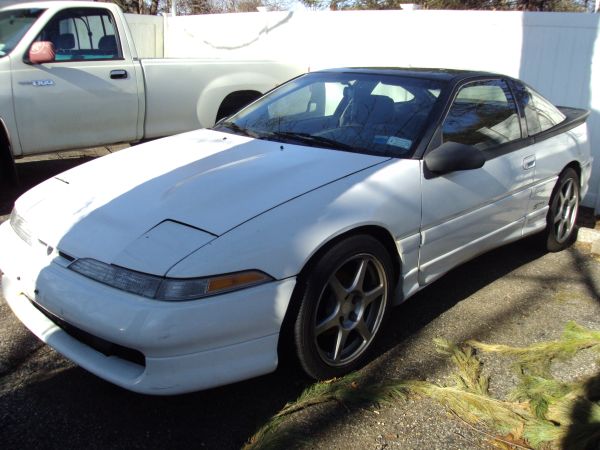

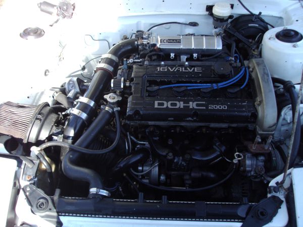

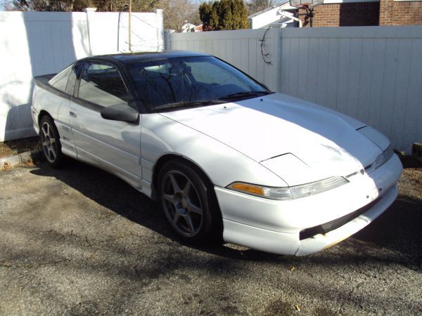

Here's a few pics. I'll post some better ones after a good wash and wax. Its dirty as hell right now. More pics to follow.
Looking good you got her home thats all that matters now dig into her and see what she needs and start the mods.
Good looking Panda! Must be really clean for you to justify flying out there to inspect/buy it.
Things that look out of place (visual opinion, of course): 1g intake/maf
That snorkel really kills it:p
But seriously, any plans for it?

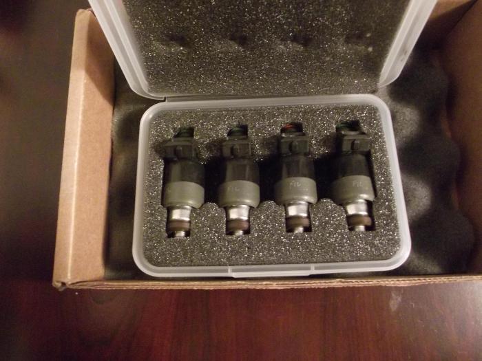

Well a small update. I got my injectors in today.
FIC 550's
Just waiting on the 2g maf so i can install them together. I will be taking and posting extensive logs, including data from a lm-1 handheld. I ran a set up like this in the past, but i'd like to have some solid data this time on just how close they work together.
I decided on the FIC 550's over a set of evo 560's. The FIC's flow a true 550cc at 43.5psi of fuel pressure. Which should bring the "cancellation effect" of the combo with in a few percent. A margin the ecu should have no problem with. But again i'll post the info i find.

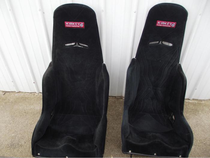

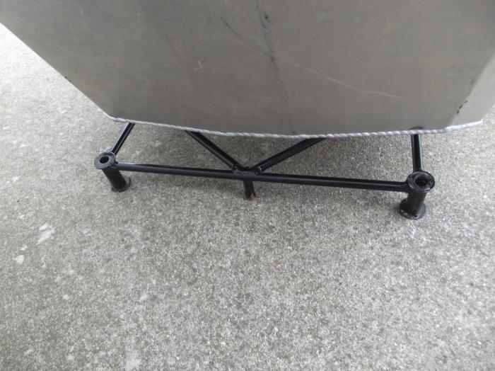

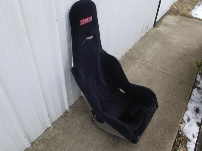

1. I picked up a nice set of 15" Kirkey racing seats with pads. The site lists them as 13lbs and honestly they dont even feel that heavy. These things are light. An added bonus, they came with a set of custom chromoly tube seat brackets powder coated black.

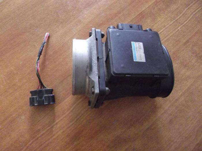

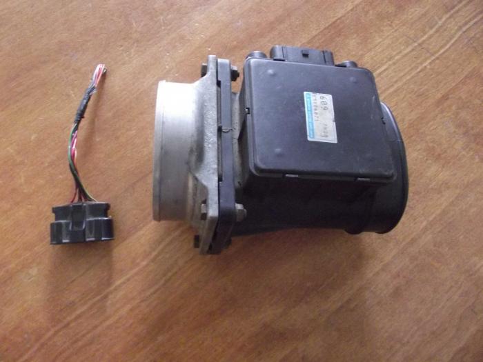

2. Got my 2g maf w/pigtail and filter adapter from ups.

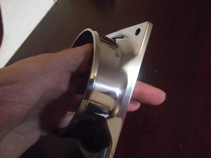

Its been hard finding time lately but I finally polished the filter adapter. That thing was ugly.
Here's a before and after.

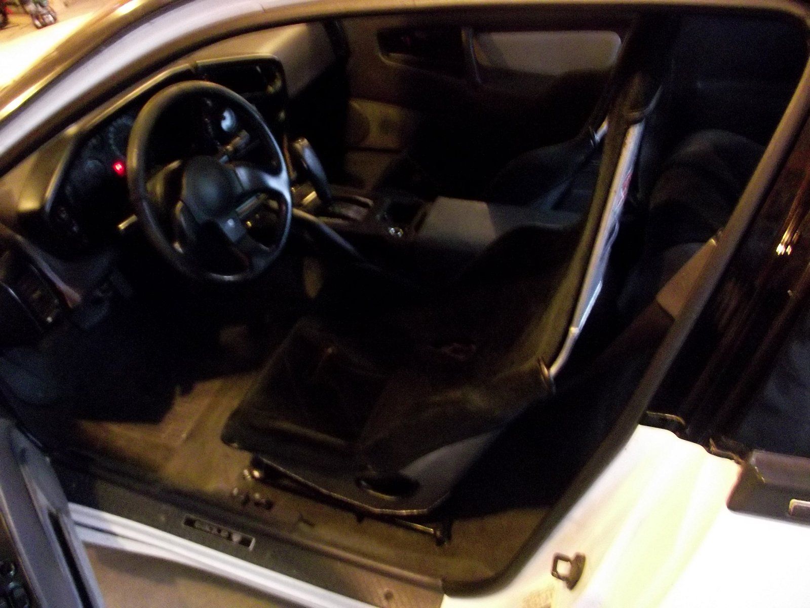

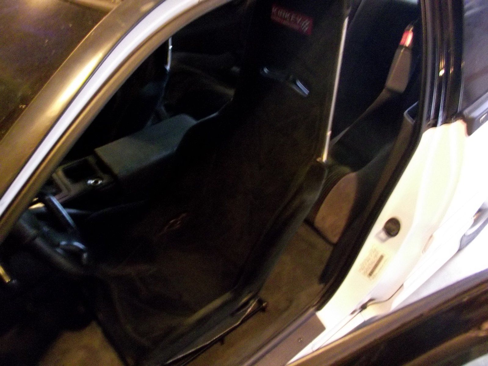

I got the kirkey seats installed. The pics i took turned out so dark that there was no point is posting them up. But the next nice day i'll take it out and get some good shots.

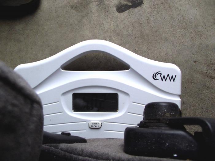

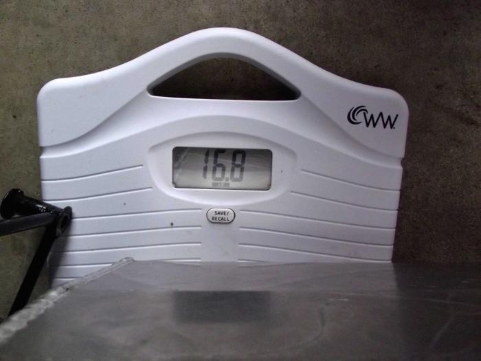

I did however manage to weigh them against the stock seats before the install.
Stock cloth seats w/brackets - 58.2lbs
Kirkey seats w/custom brackets - 16.8lbs
That's a loss of 82.8lbs from a simple seat swap. Not too shabby.

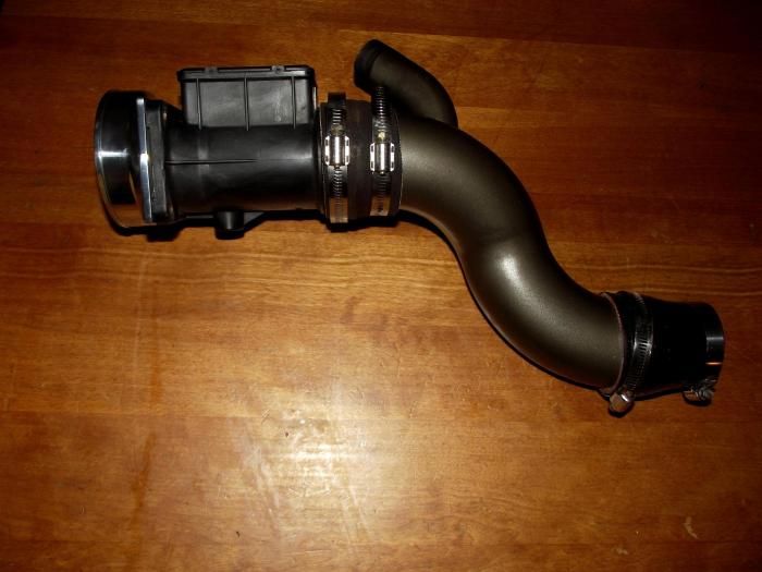

1. I finally got rid of the snorkel:hellyeah: I got my 3" dejon intake pipe with the a longer coupler for better flow down to the inlet. Cleaned and wet sanded the maf housing. Looks almost new, specially paired with the newly polished adapter and new dejon pipe.

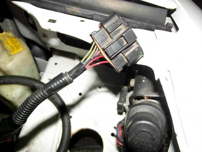

2. I wired up the 2g maf pigtail into the harness. Pretty happy with that one. Looks oem.

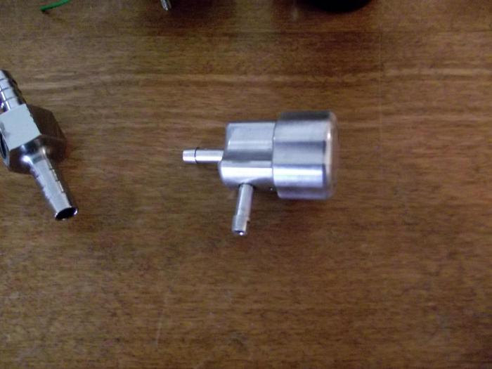

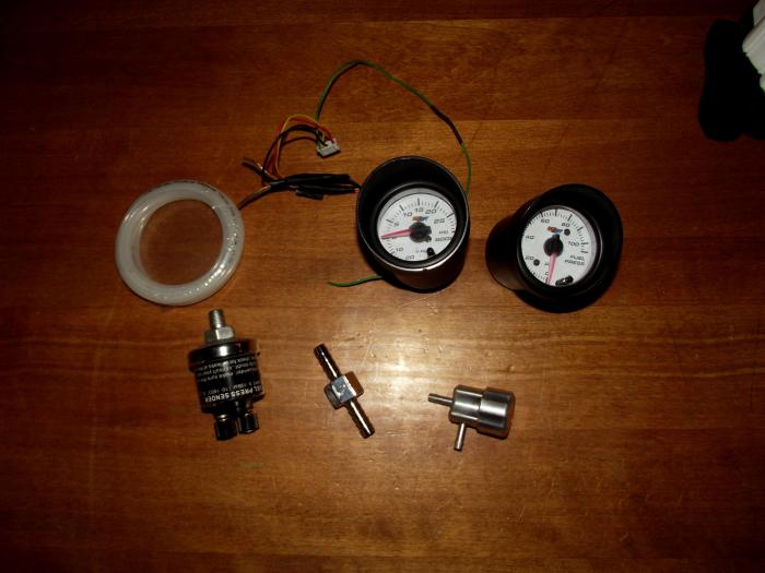

3.My buddy had some parts laying around so i picked up a boost gauge, fuel pressure gauge, and a Joe P. Pro Z billet mbc off him.

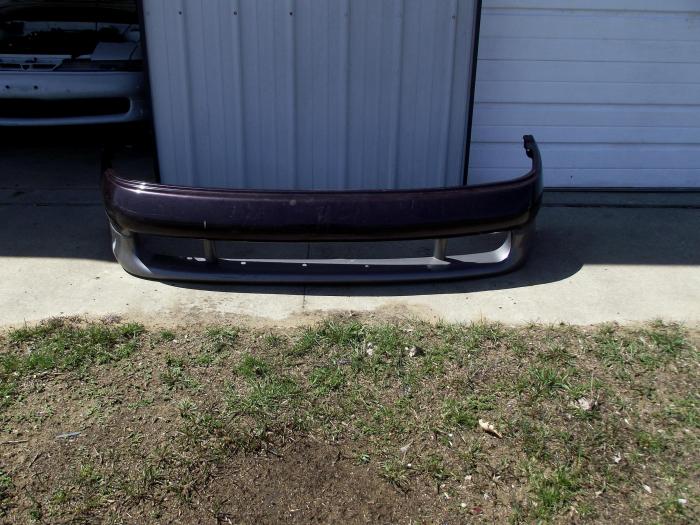

4. I grabbed a mint front 1ga bumper from a local part out. Zero cracks and all the mounting tabs are still intact. I thought about trying my hand at painting. Plan is to spray it white to replace my current bumper which has a crack and a decent scuff mark underneath.

The injectors look beautifully packaged! LOL
Yea aren't they? haha. Really, thanks though, they work great.

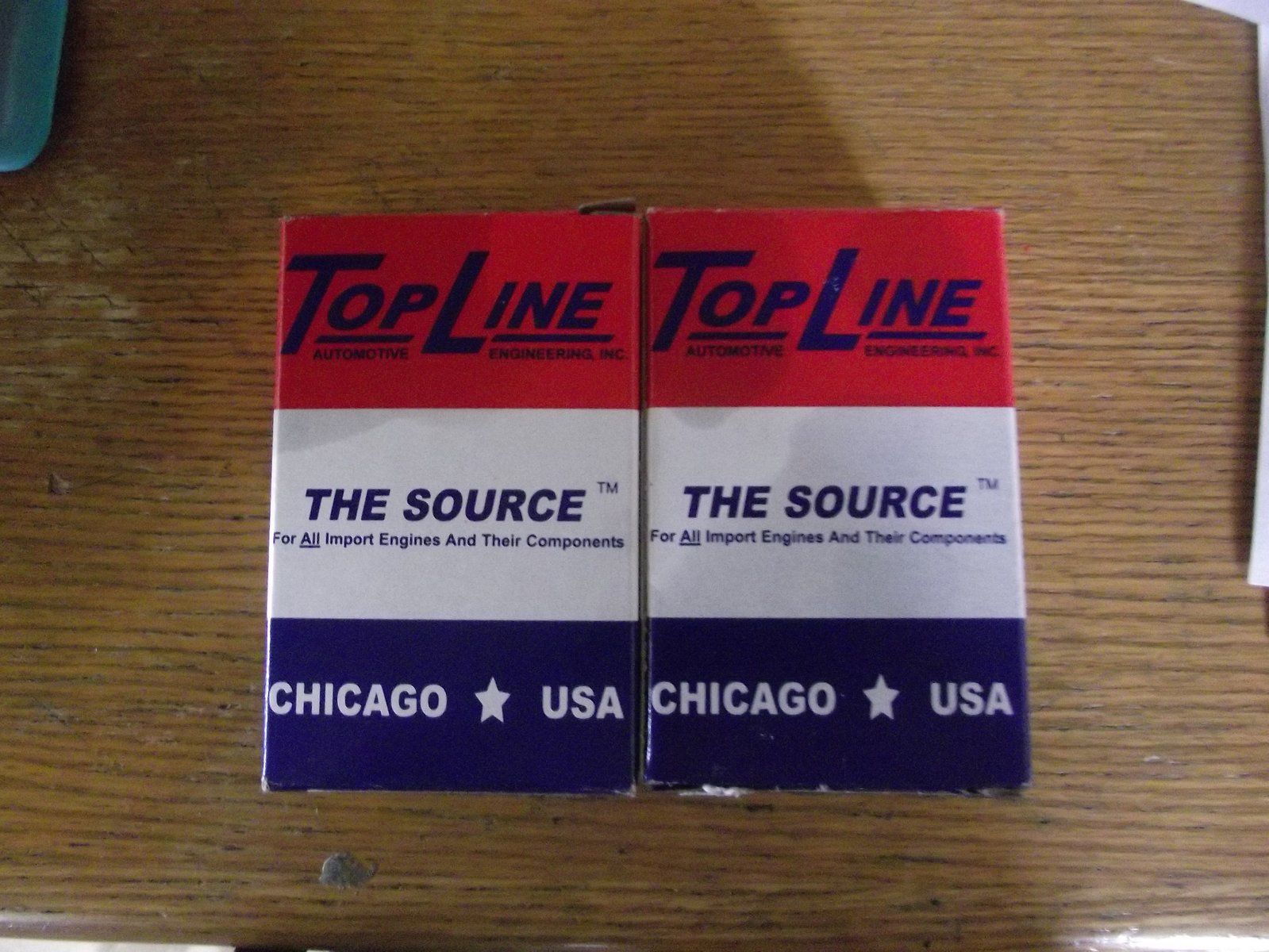

Swapped out the noisy lifters for a new set of 3g lifters. No lifter tick is an amazing thing LOL.

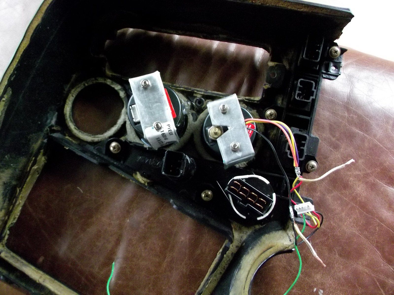

Wired up the boost and fuel pressure gauges.
A quick shot of the brackets i rigged up. I'll get some shots of the finished product soon as well.
