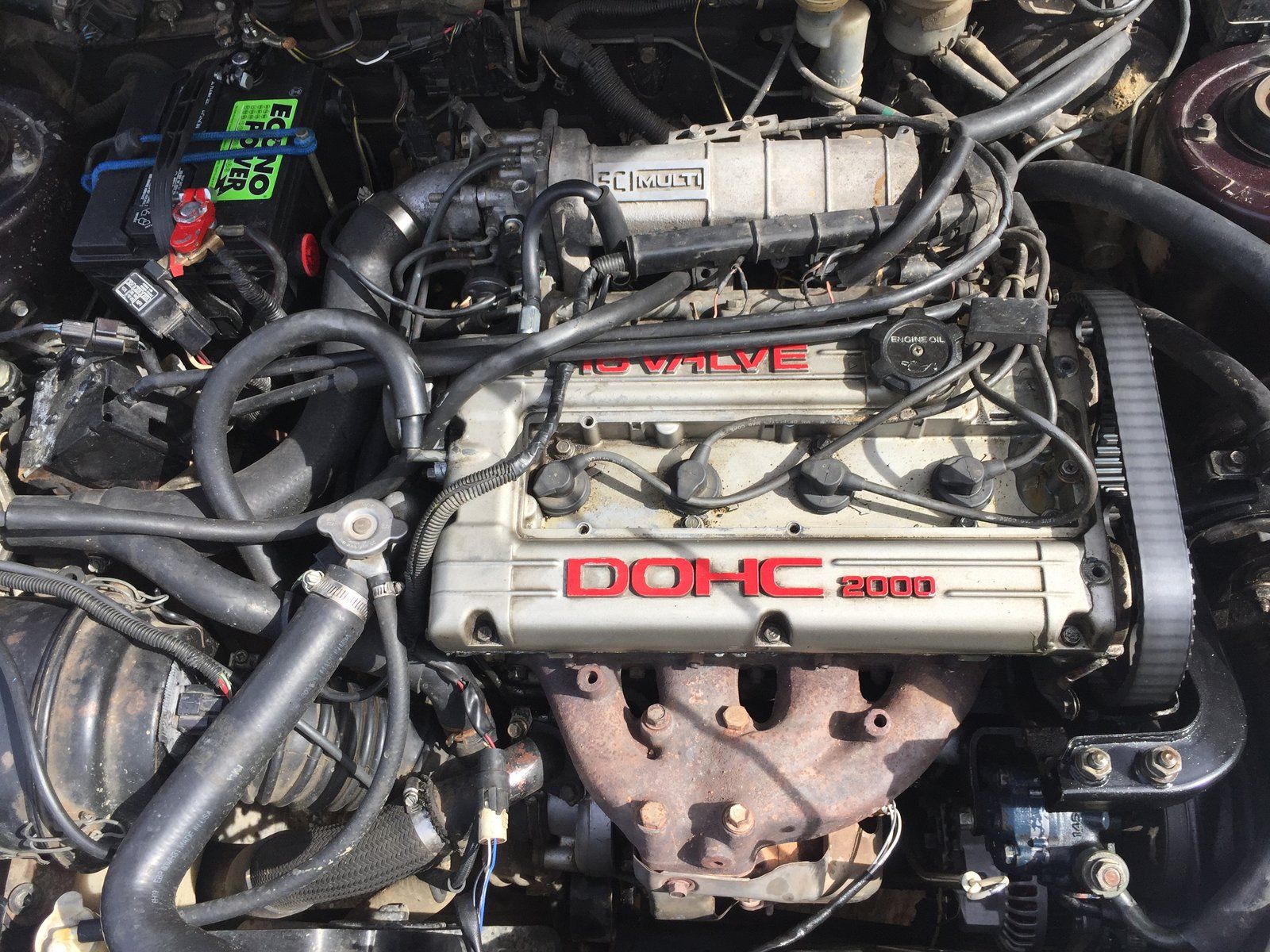

By looking at it’s carfax, I could see that it sat for about 7 years until late 2016. The P.O. said the engine was rebuilt and all stock other than the paint and ebay exhaust welded onto the stock piping. Electrical bug, Power steering was shot, some oil leaks from a cracked valve cover, and idle issues were the few things I knew before purchasing. When I got it home the coolant housing was dry so I flushed it/filled with new and made sure there was no air in the system. I also noticed the wastegate arm was never hooked up to the flapper so I connected it (bad idea). Replaced the power steering pump and it turned like butter. I then took it to my mechanic and put it on a lift and noticed there was a chunk of bellhousing missing from the tranny and my passenger axle barely connected to the tranny. They put on a new axle and while driving it home the dipstick popped out spilling oil everywhere. I also noticed that my coolant was all brown and low even after the flush.

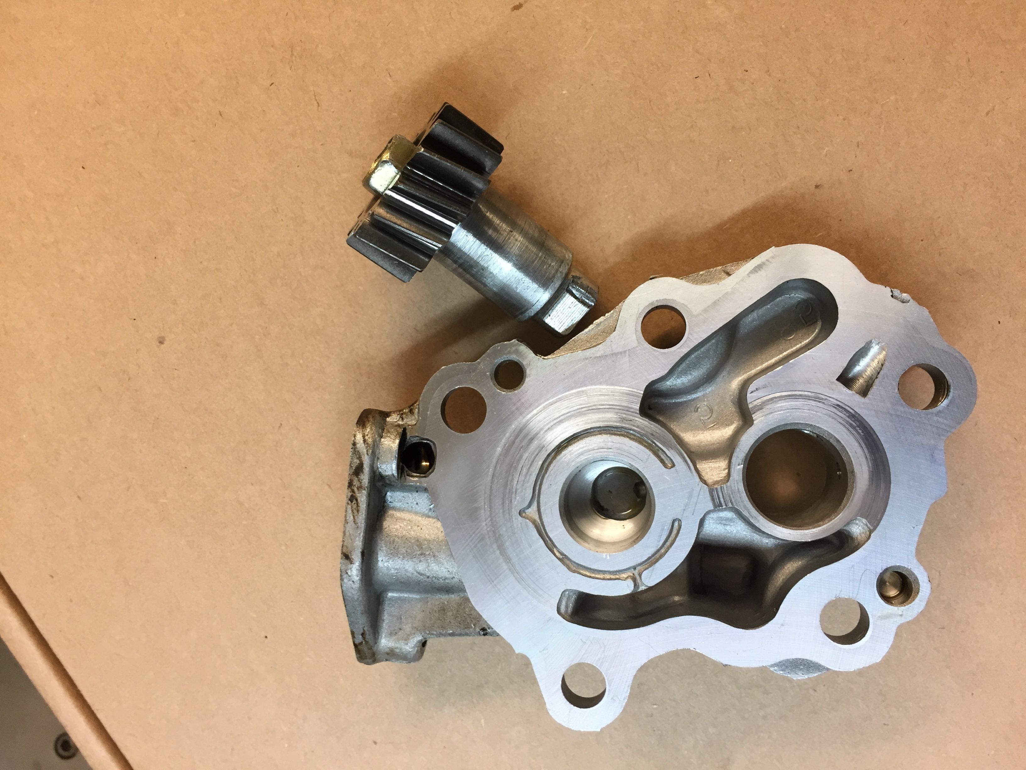

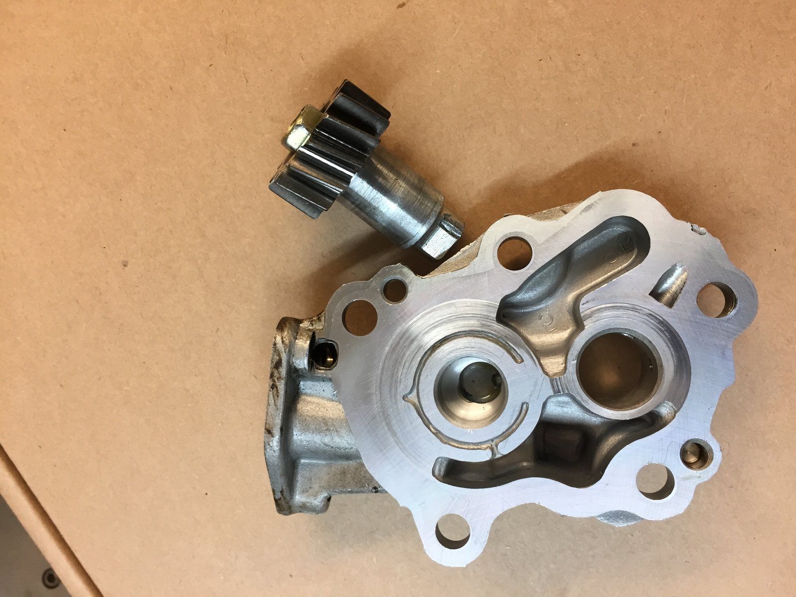

Long story short, on my way home from getting fresh tires, the head gasket blew while driving uphill a block away from home. I now realized that the car was most likely pushing coolant before I purchased it. The wastegate was disconnected for a reason.. The ecu installed was fried and was for a FWD NA, the pistons in the original turbo block were NA pistons as well. Another discovery which would have probably led to engine failure was the use of a balance shaft delete stub with no oil groove commonly found on ebay. After realizing all of this, I knew I had to go over everything and start from scratch.

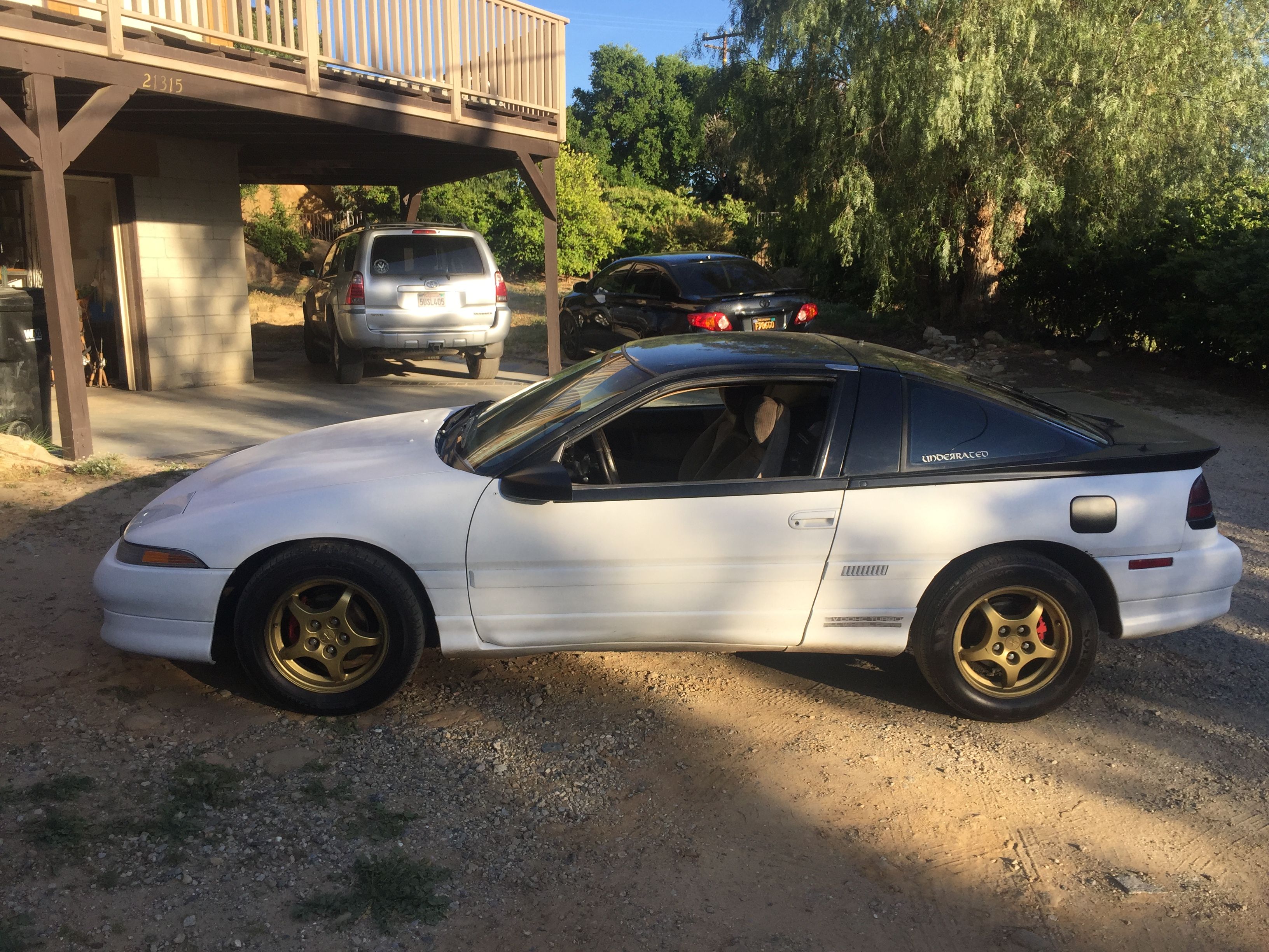

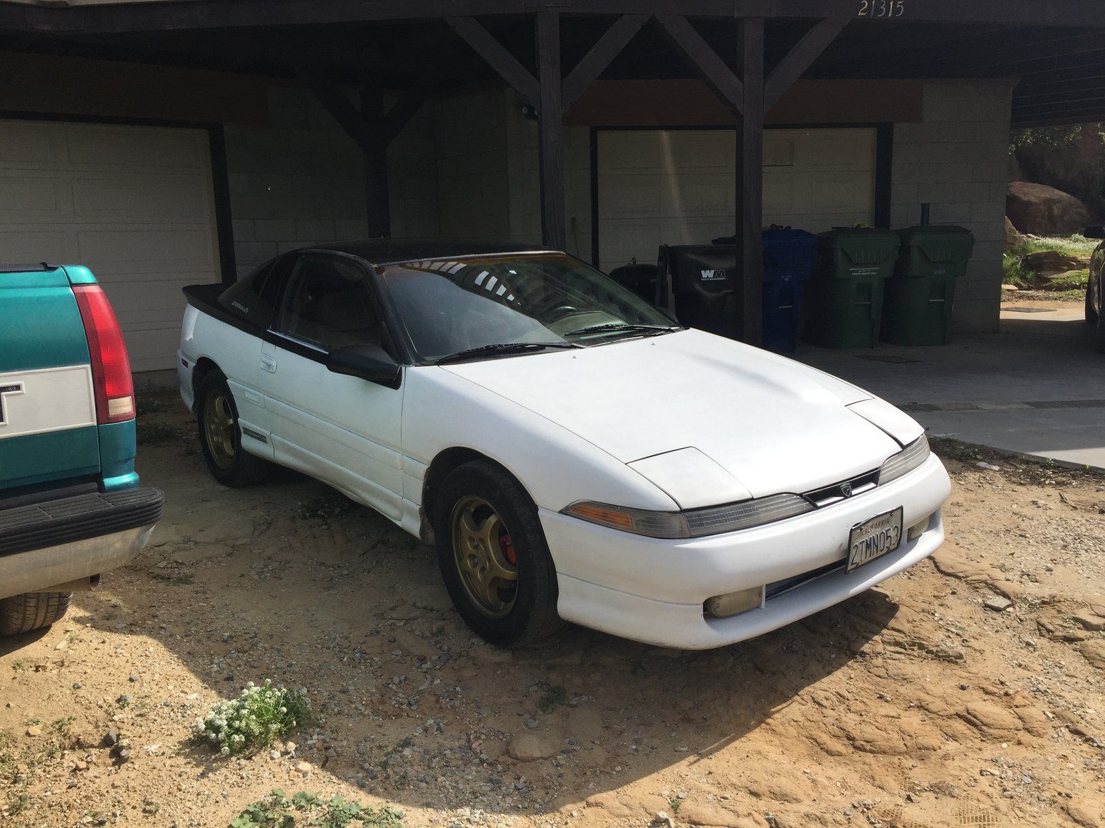

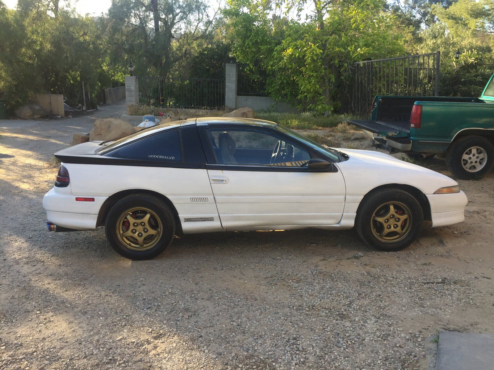

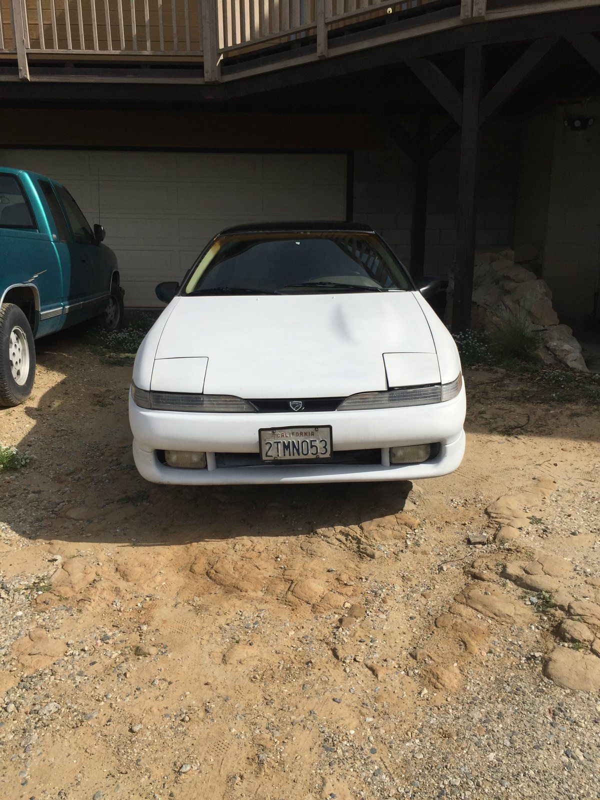

After a little cleaning up (pre-hg failure)

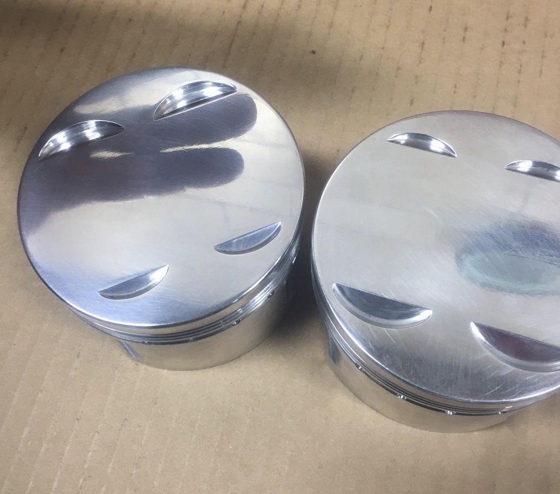

What not to use for BSE:
