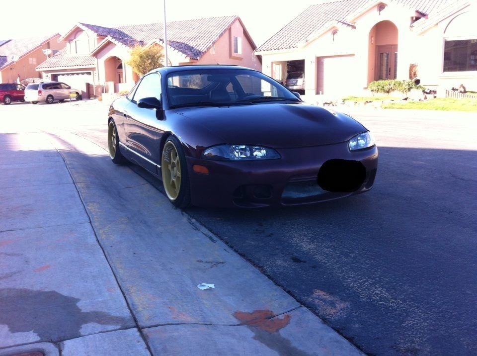

I wouldve never thought of the washers thing for the rear, is it eir if only the rear has the exagerated camber? because thats the way it is and i dont like the fact that i bottom out at least 2 a day even wit proper precautions haha
Lowering my car 2" front and rear threw the back out way more than the front. Before I got my camber kit I ate through a set of tires on the rear in 2 months. 1 month for the inside of the tire, then flipped it and rode on the other side of it and got a month. Granted I was doing 120 highway miles a day to/from work.
Fronts were perfectly fine though I did put a kit on the front too.
