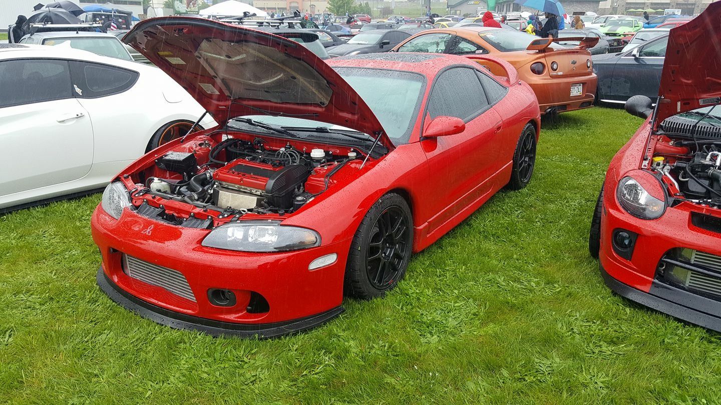

Automotion 2017 came around, and despite the terrible weather, it was still a great time as always! Here's a few random pictures from the weekend!
I ended up winning best dsm again at this show. Only a few showed up, but still happy.

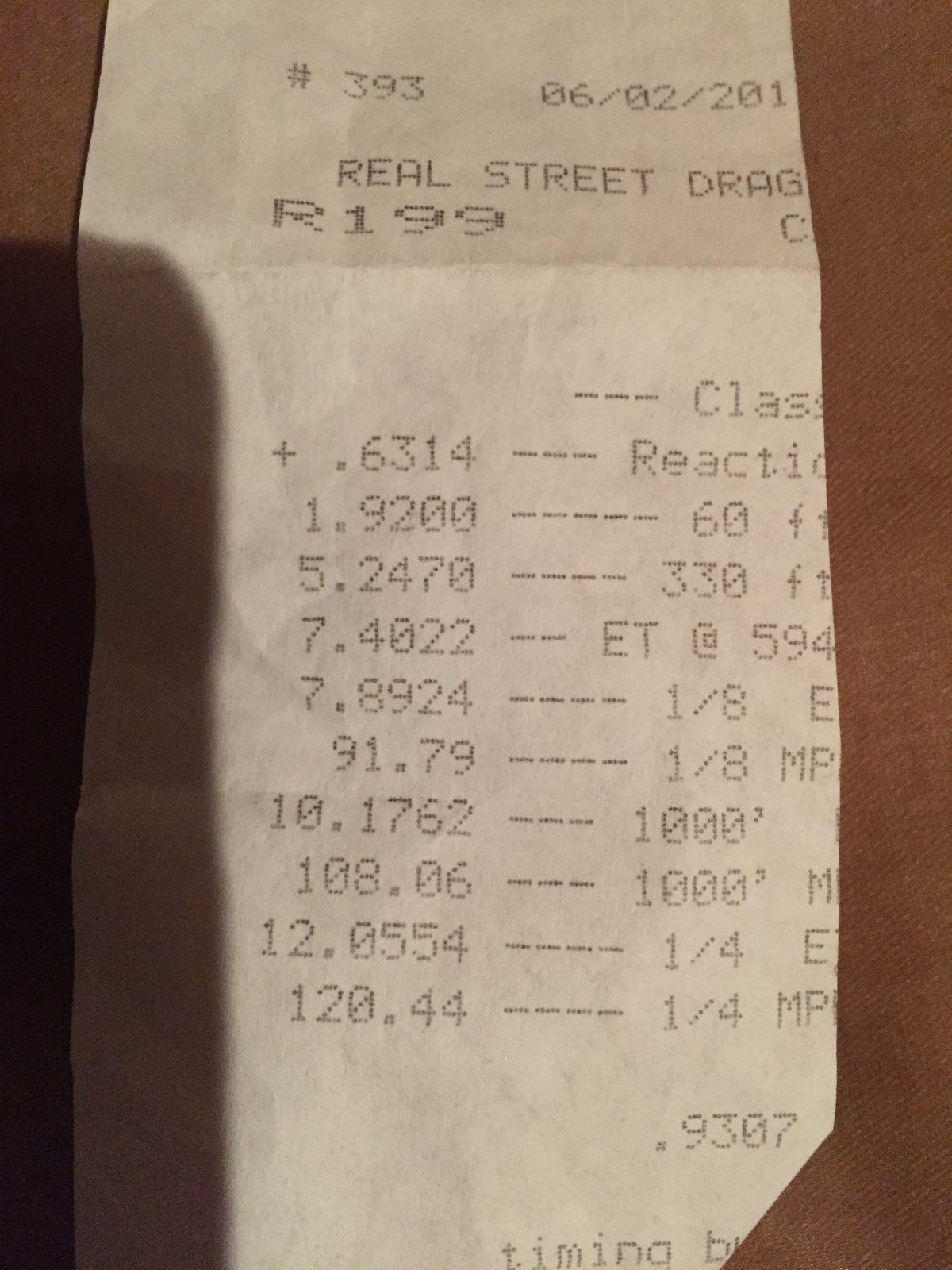

A couple of weeks after Automotion, I finally hit the local drag strip. On my final pass I ended up with this time slip. So close to the goal!
I'll be shooting for that 11 second timeslip the next time I'm at the track. I need to work on my launch and I'm there!

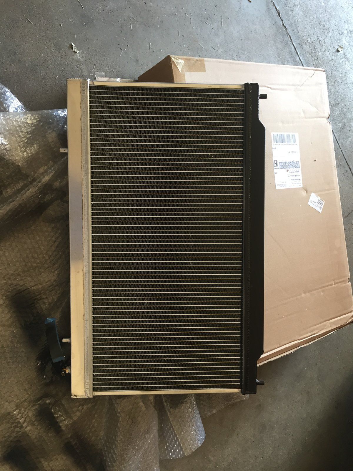

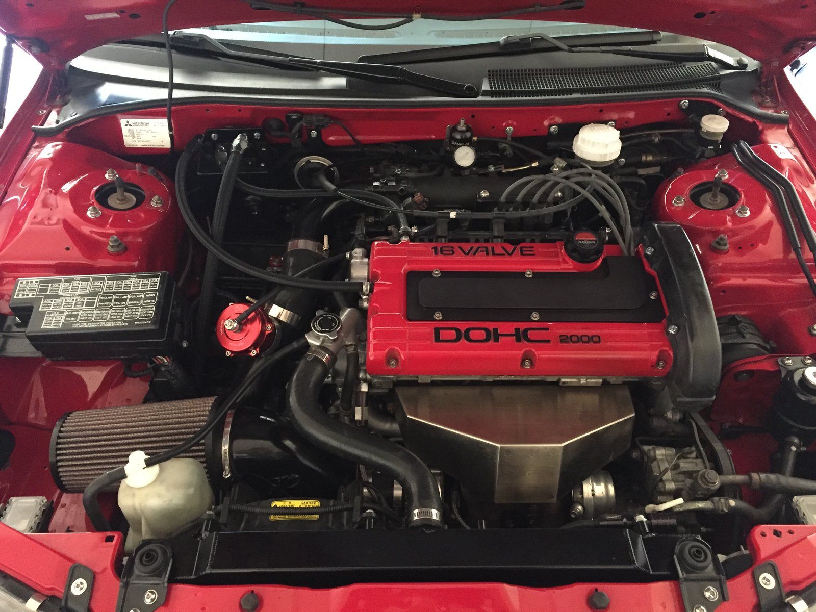

I finally decided to get rid of the stock radiator since the upper water neck was starting to turn brown which tends to lead to it breaking. I went with an eBay no name brand aluminum radiator at the recommendation of many other dsmers. It fit great and seems to be of pretty decent quality. I painted the upper tank low gloss black to match the rest of the bay.

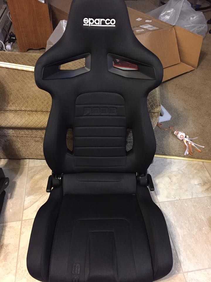

So the winter plans! First off, I have been slowly collecting parts to do a black/gray interior swap from a 99 model year car. I'll be doing new carpet, new oem floor mats, and last but certainly not least, a pair of Sparco R333 seats up front. I have wanted some nice feeling seats for a long time now, and I finally pulled the trigger on a set. These will really add to the driving feel of the car since I won't be sliding all over the stock leather seats anymore. I"ll also be doing a few other things inside the car to update the interior and give it an overall better feel while behind the wheel.

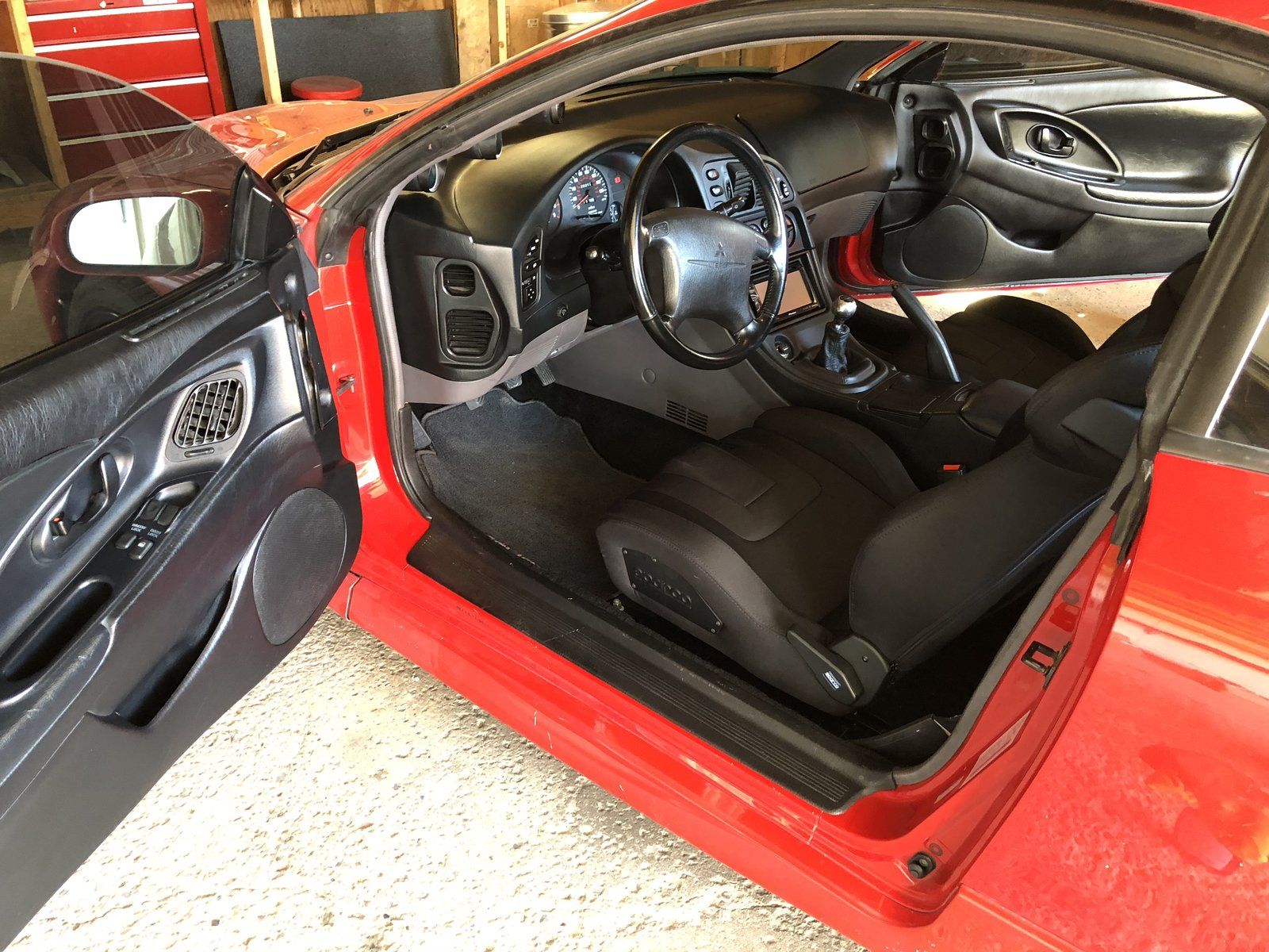

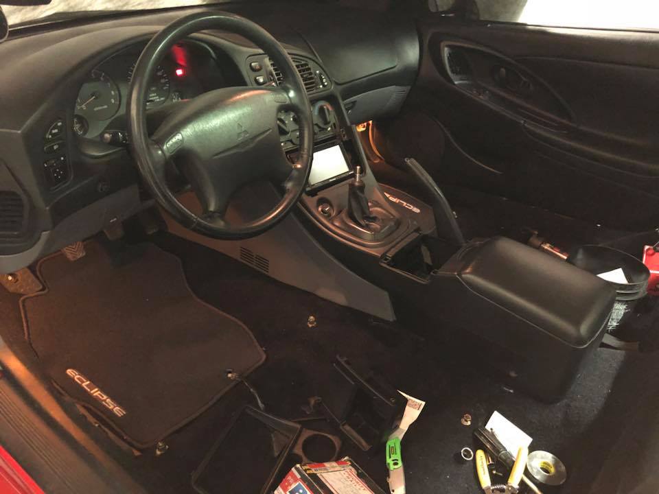

Well I am finally done with school so I've had much more time to work on my car. I have the interior swap nearly complete. I ordered a replacement black carpet set from stockinteriors.com. The rest of the parts for the '99 black interior swap I found from a guy on craigslist this past summer and the local junkyard. I'm only waiting on a few parts for the interior such as a new shift boot, seat sliders, and mounting brackets. Here is the current state of the interior as it sits right now. One of my favorite things that I got for the interior were the black oem floor mats that extremepsi has on their website. They really add a nice touch to the interior, and match the carpet perfectly as well.

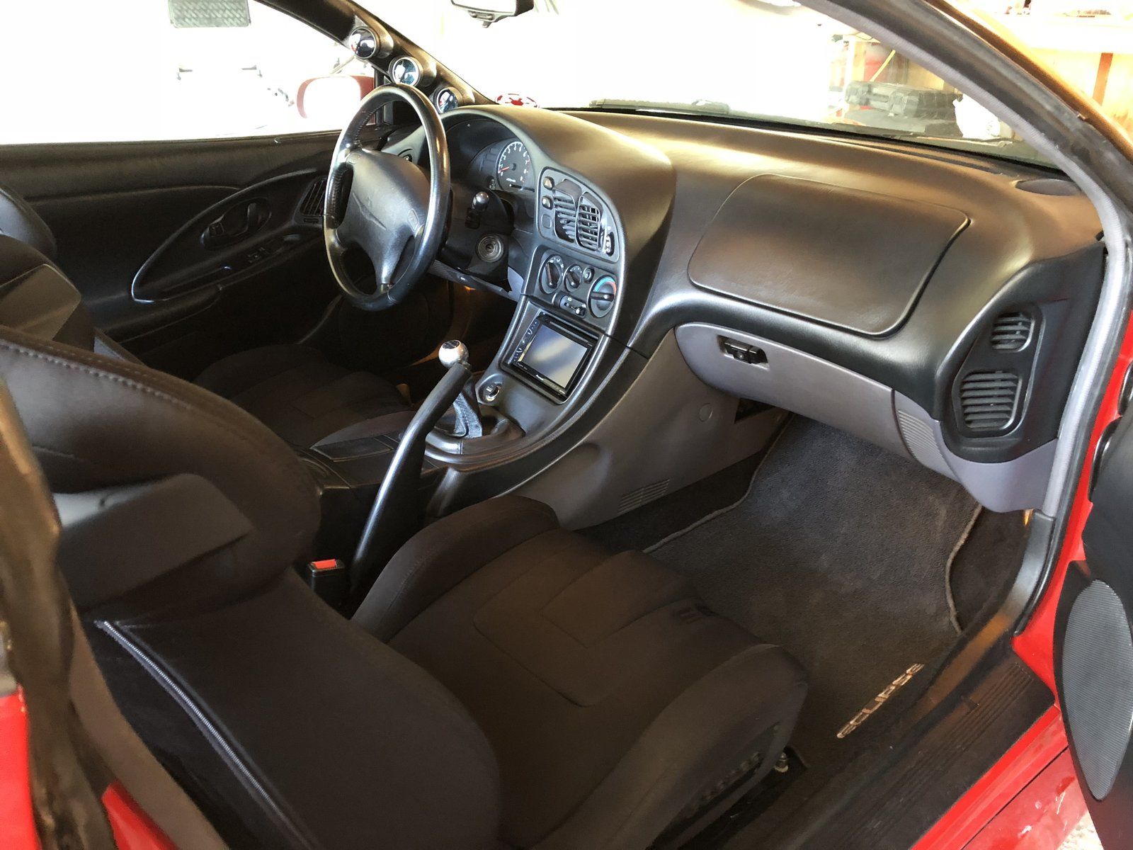

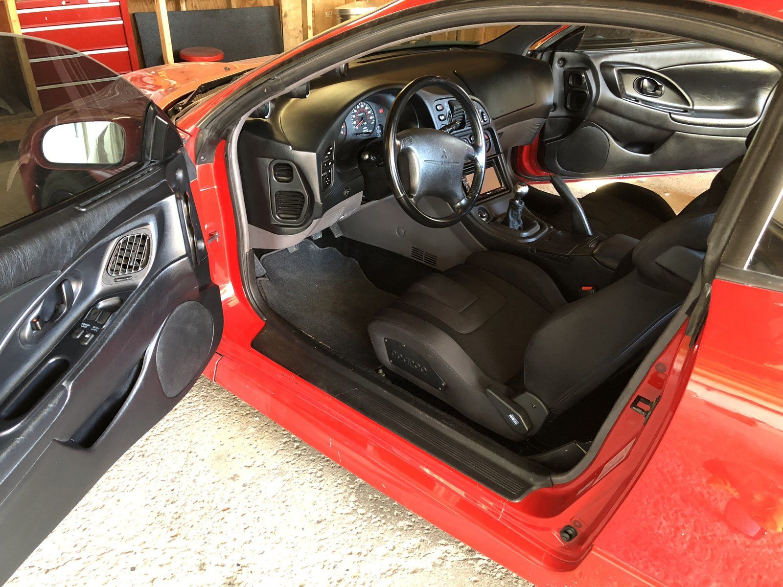

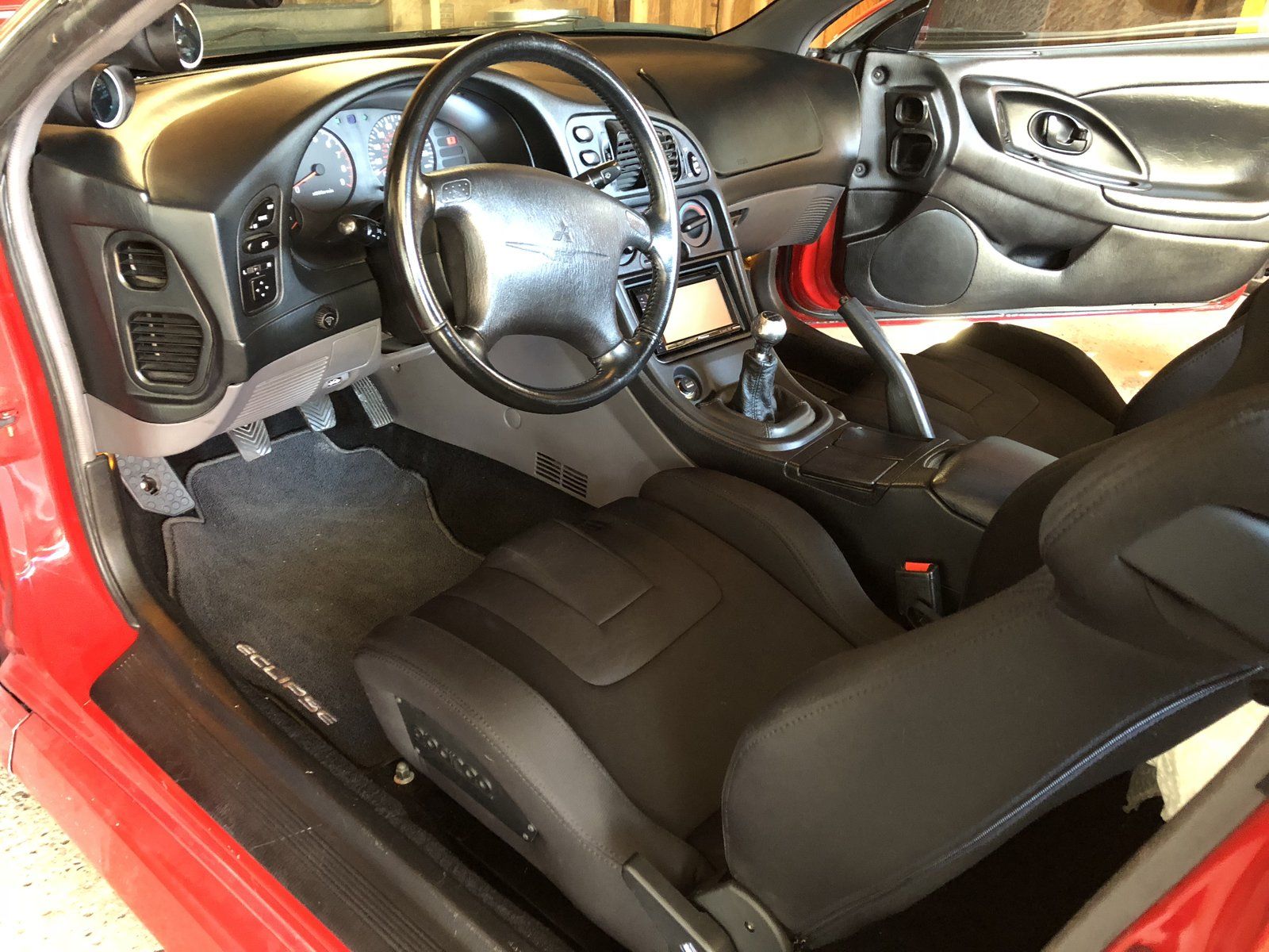

Well, I installed my seats yesterday with the sparco sliders and planted brackets, and they sit way too high. My head just about touches the headliner. It appears that wedge engineering’s brackets sit a bit lower than planted’s brackets so I may give them a try. However, the way it sits right now, it will not work. I also purchased a set of fic 1250cc injectors that I am going to get cleaned and flow tested. Those should give me some room as I was nearing 100% idc in the colder weather.
I run the wedge engineering brackets with the Evo 9 Recaros, brackets are nice but are also taller than the oem mounting location. I haven't put a helmet on yet but will have to tilt it back a little to fit comfortably, I'm 6ft for comparison.

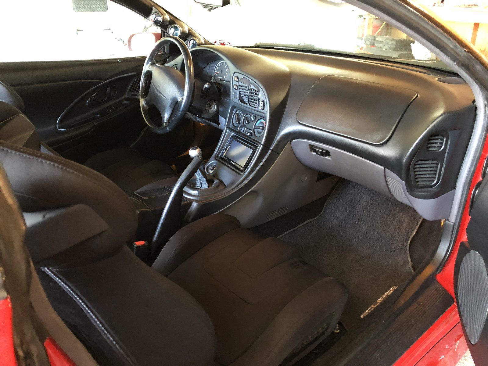

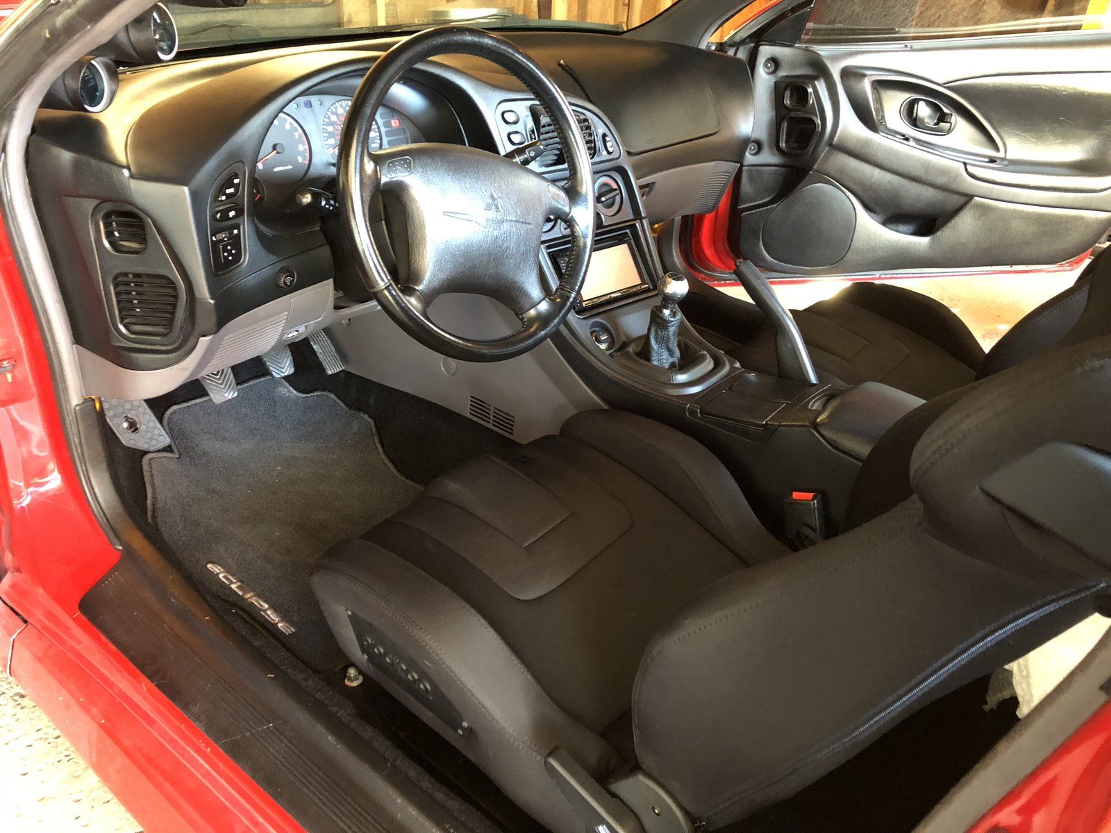

I finally was able to get the seats to fit in the car nicely. I ended up buying a set of wedge brackets and removing the “E” shaped riser from them, which allowed for proper head clearance. Now that the seats are in, the interior swap is pretty much done!
I am overall very very happy with the decision to do the interior swap, I was really starting to hate the tan.

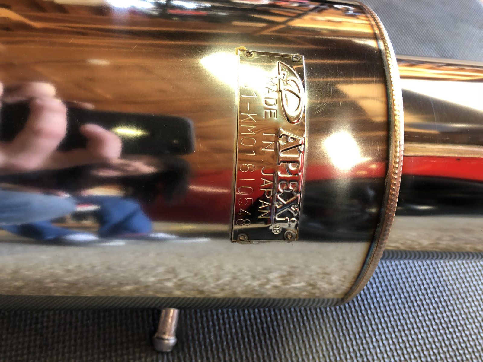

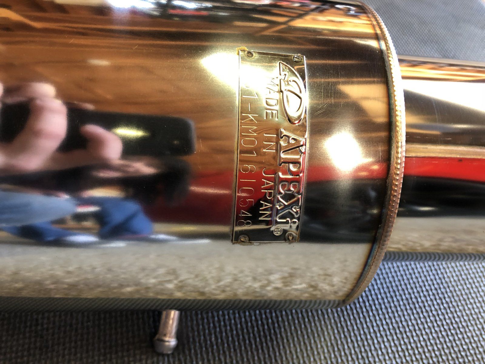

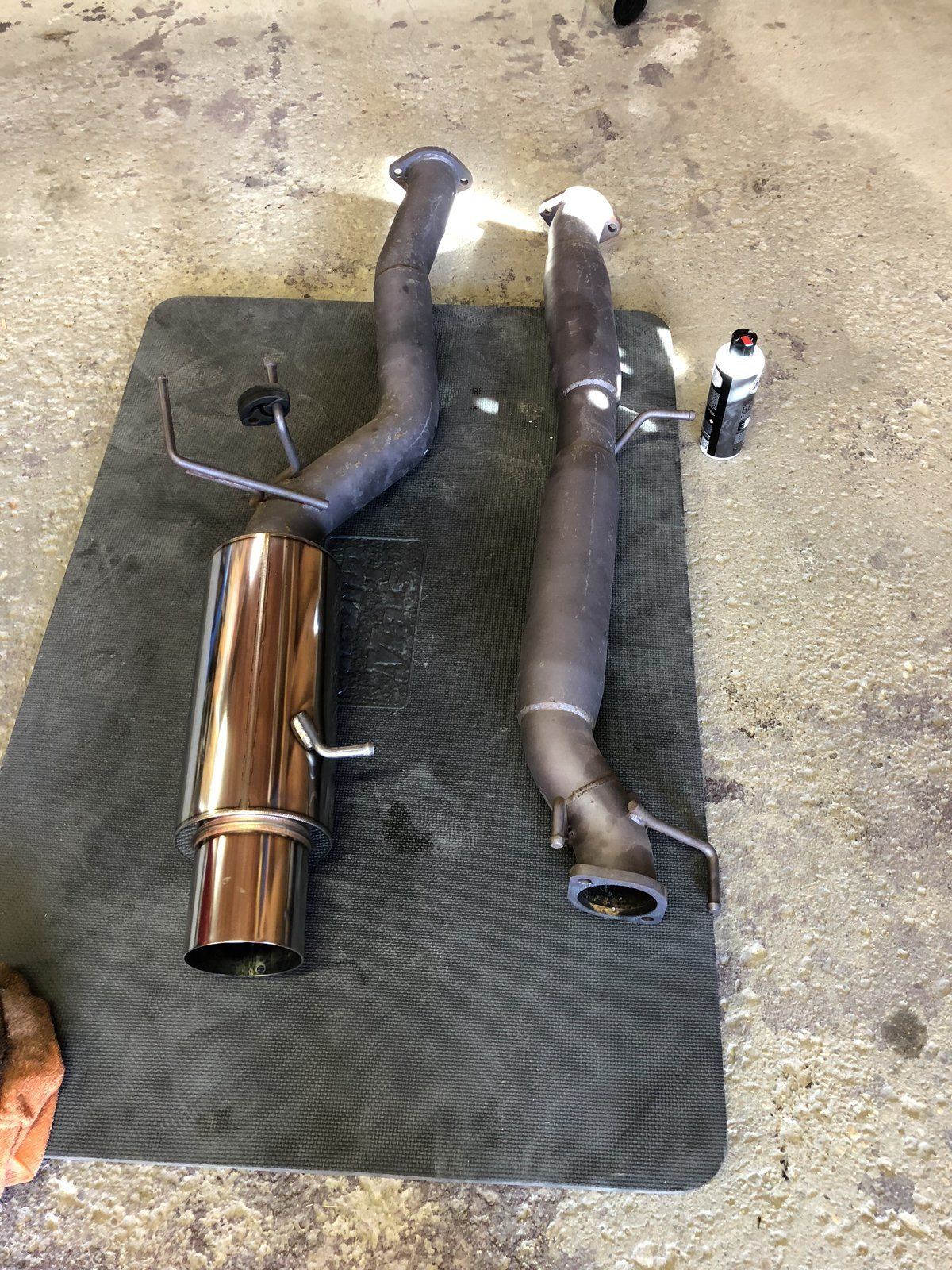

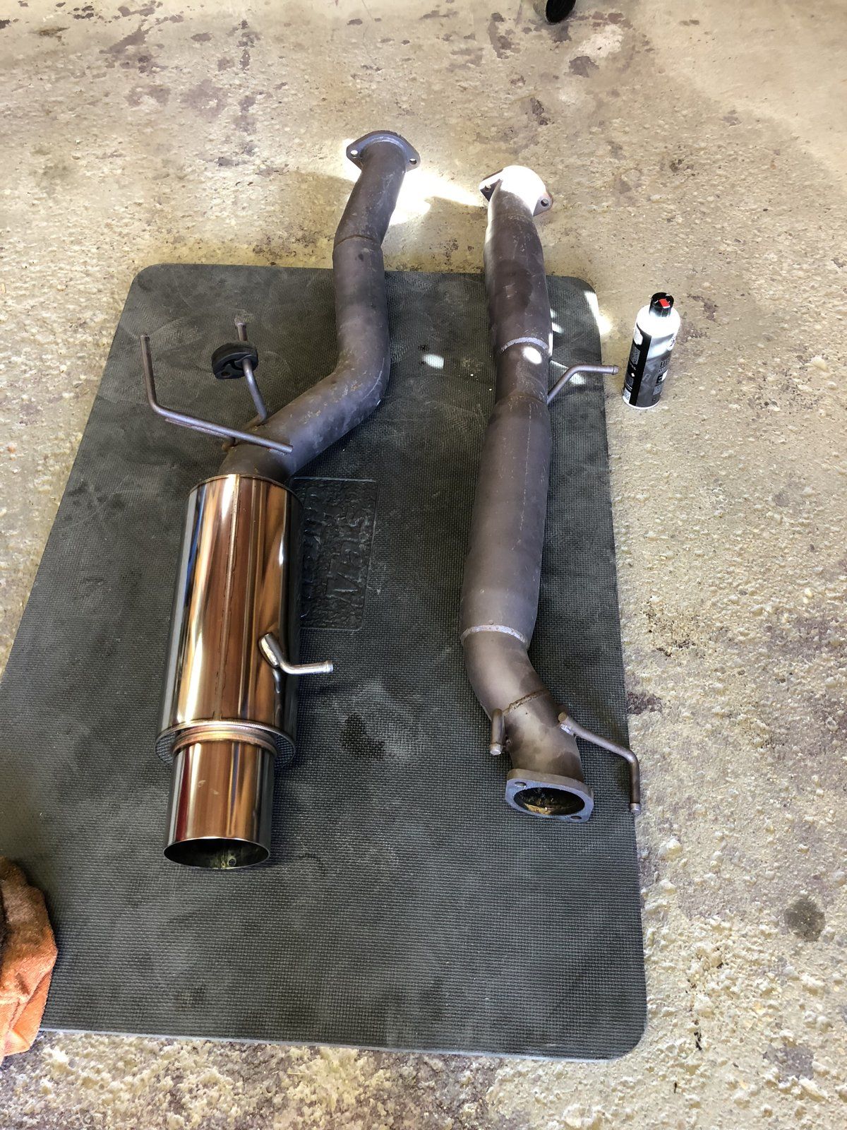

I also wanted to change up the tone, and the look of the rear end. While I did lile the Thermal R&D catback, I thought it was pretty quiet and just not for me anymore. I picked up a lightly used Apexi N1 catback. I have it installed now and I like the sound and look a lot more.

I was wondering if you could send a link (if you still have it) to the wedge brackets you bought because I’m also having the same issues with the seat sitting too high.
