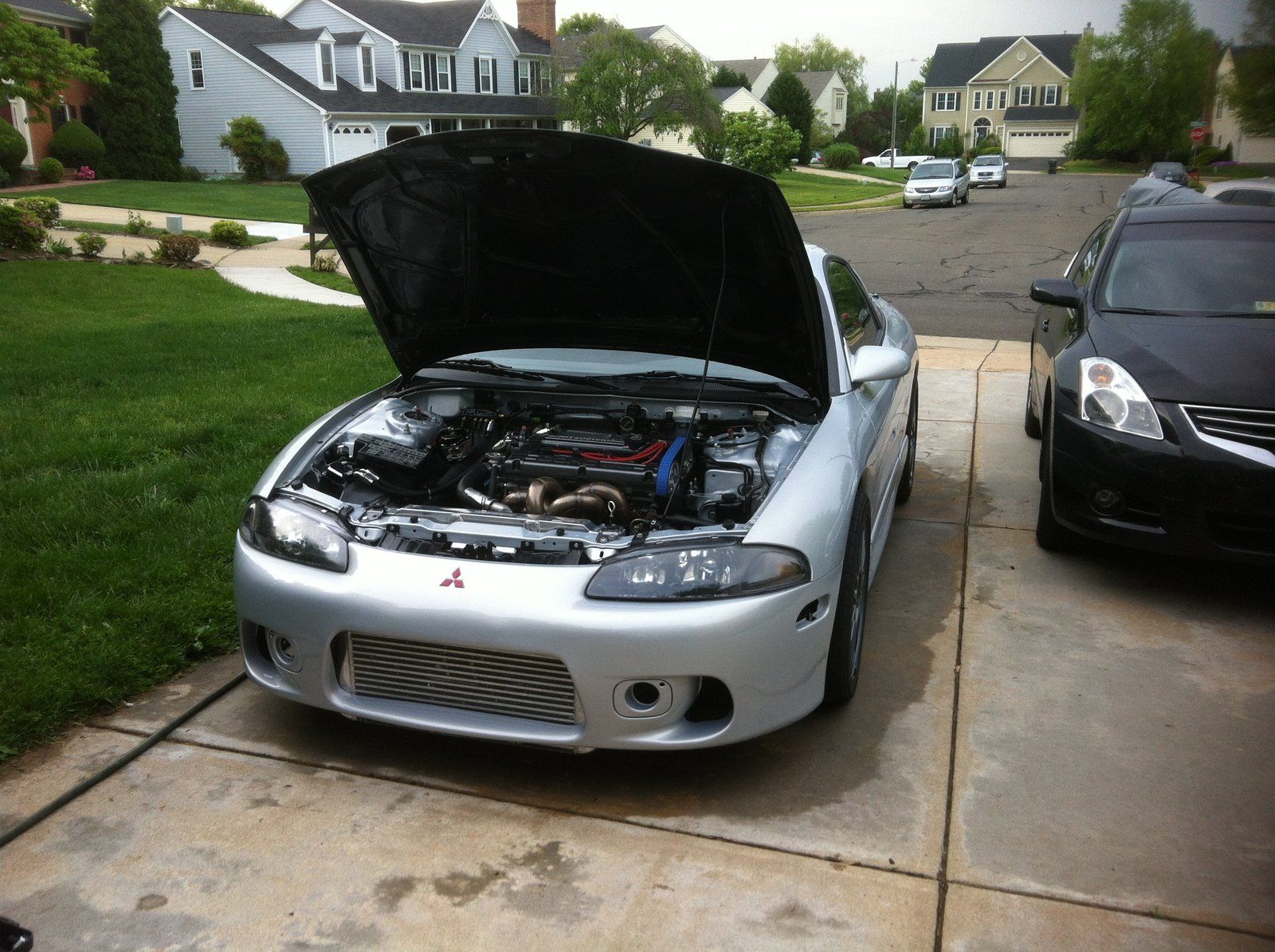

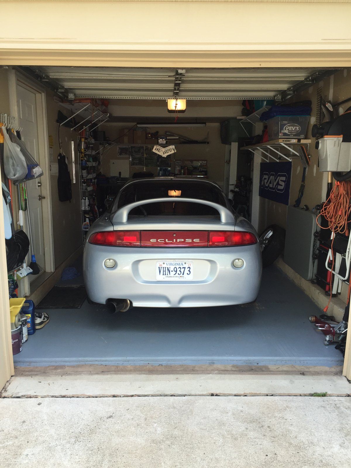

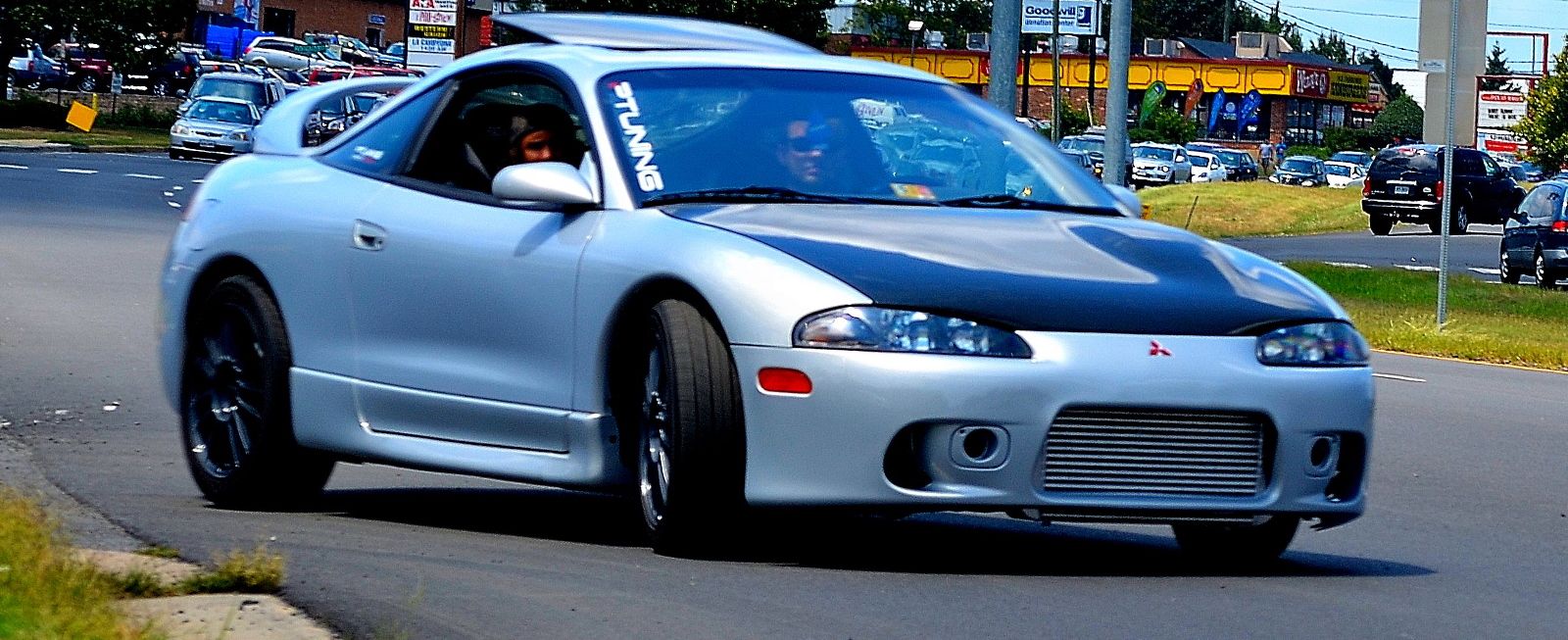

So... This past Friday I took a drive down to Richmond, VA and officially became part of the DSM community again. I bought a 99 GSX with Black interior and 87K miles on the chassis. Looking over the car and negotiating with the old owner was a long process. It actually got a little heated at one point, but I believe we came to a fair number that we both could agree one. Especially after seeing what other GSX of the same condition have been selling for this year. I believe he knew the car was going to a good home. He has seen my old build. What's funny is when I decided I wanted another DSM, I was looking for a 99 in black or white. But when I saw this one listed on CL. I had to go look at it. And I'm glad I did. It has everything I wanted in a GSX minus the color. I just think silver cars blend in with all the other Hondas and Toyotas on the road. I paint it sometime in the future. The trip home my nerves were completely shot. My mind had thought of every possible thing that could have go wrong. But about 50 miles in I settled down, and really started to enjoy the car for what it was. I was actually really surprised by how well the Tein coiloves handled the road. And felt like home being in the car. What I love about these cars, is that you never really see them on the road anymore. It's an awesome feeling having people drive by you and looking hard at the car. Almost like they didn't know Mitsubishi built something like this. Anyways that's the story behind the car. Glad to be apart of the community again. :dsm:

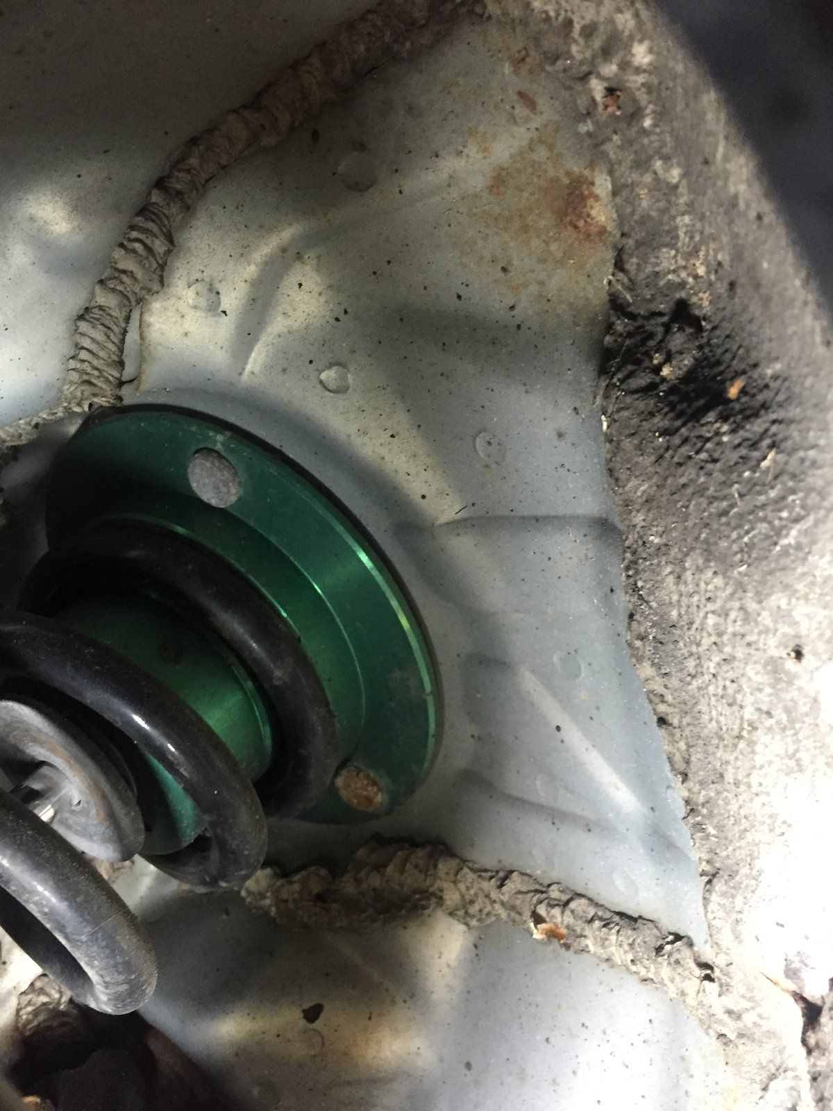

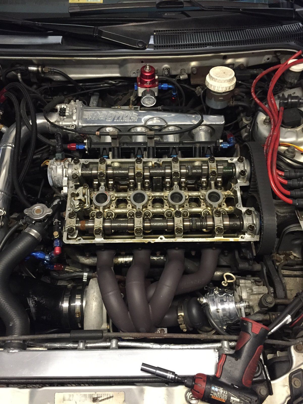

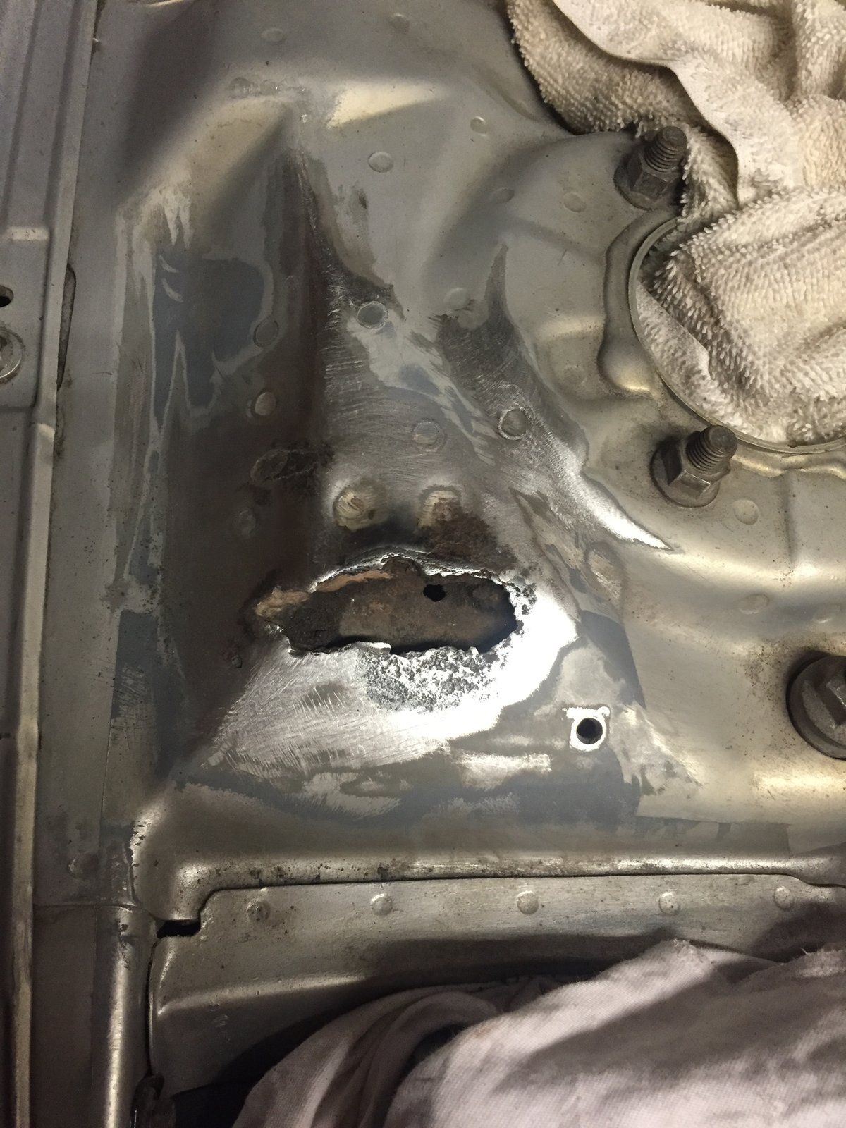

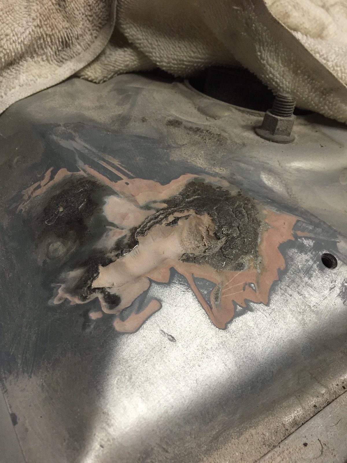

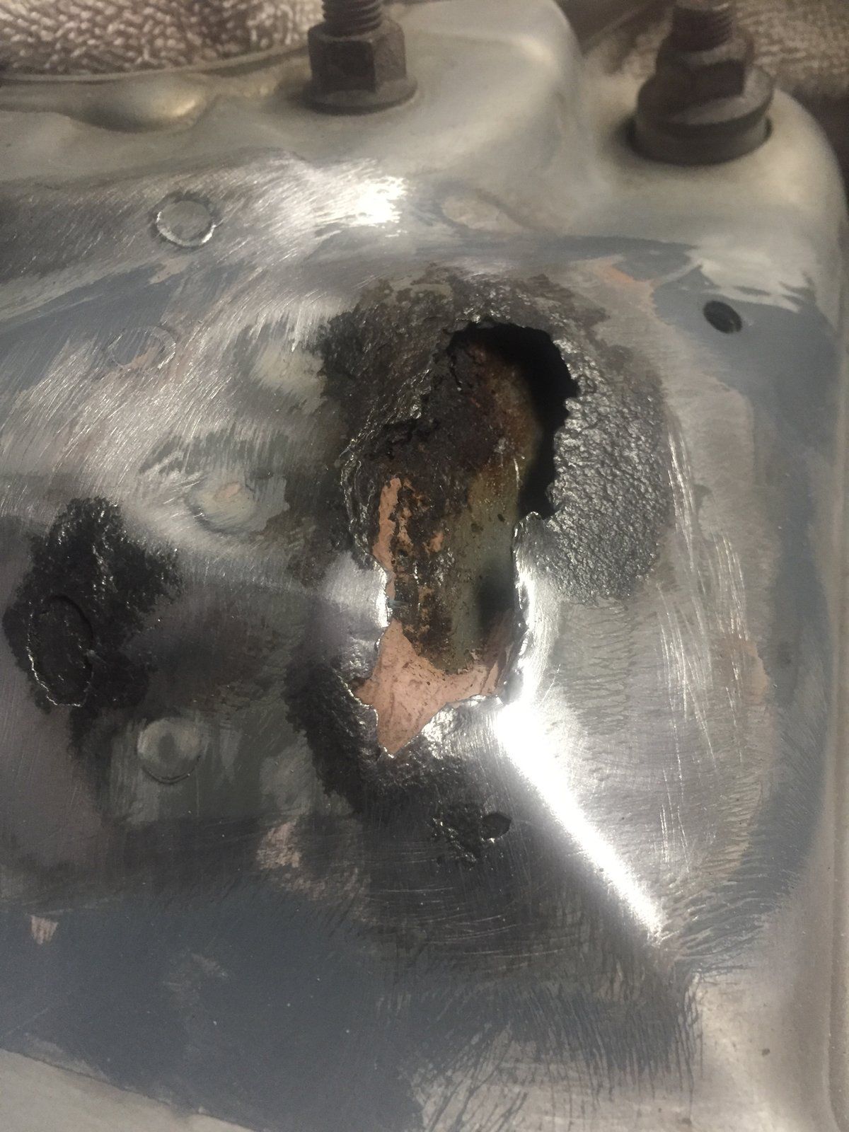

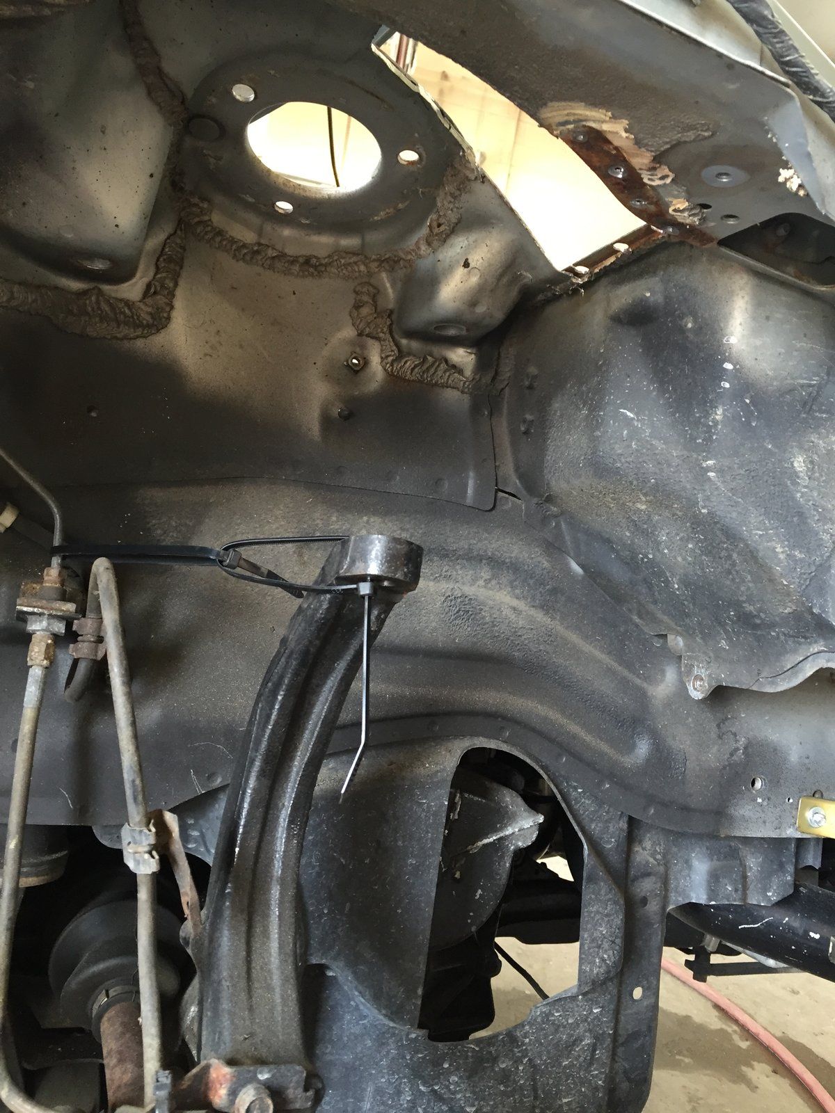

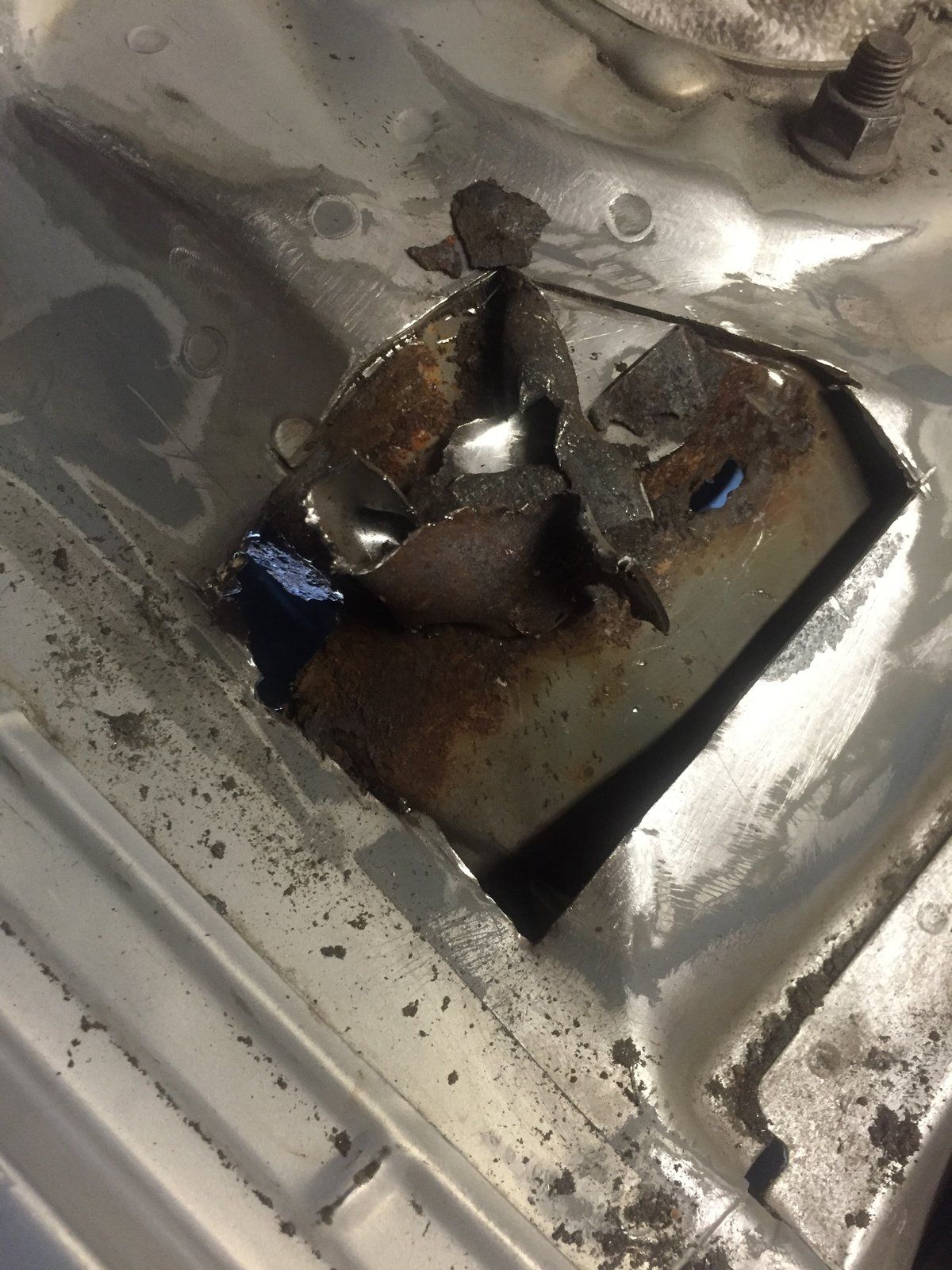

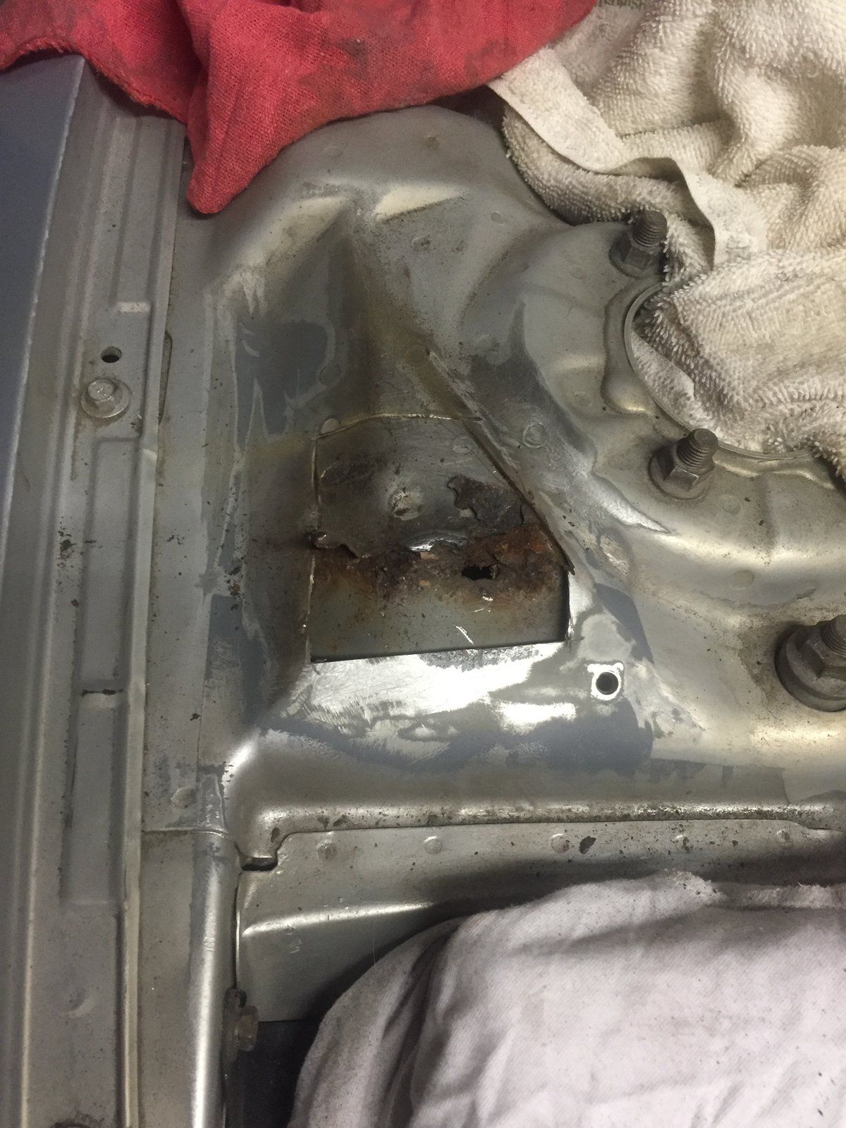

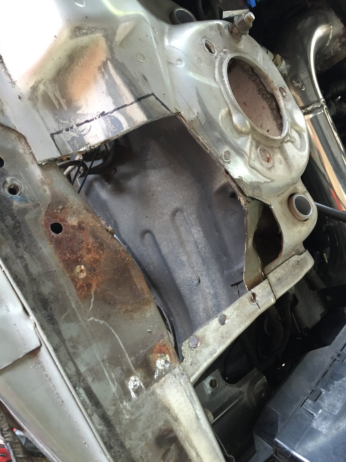

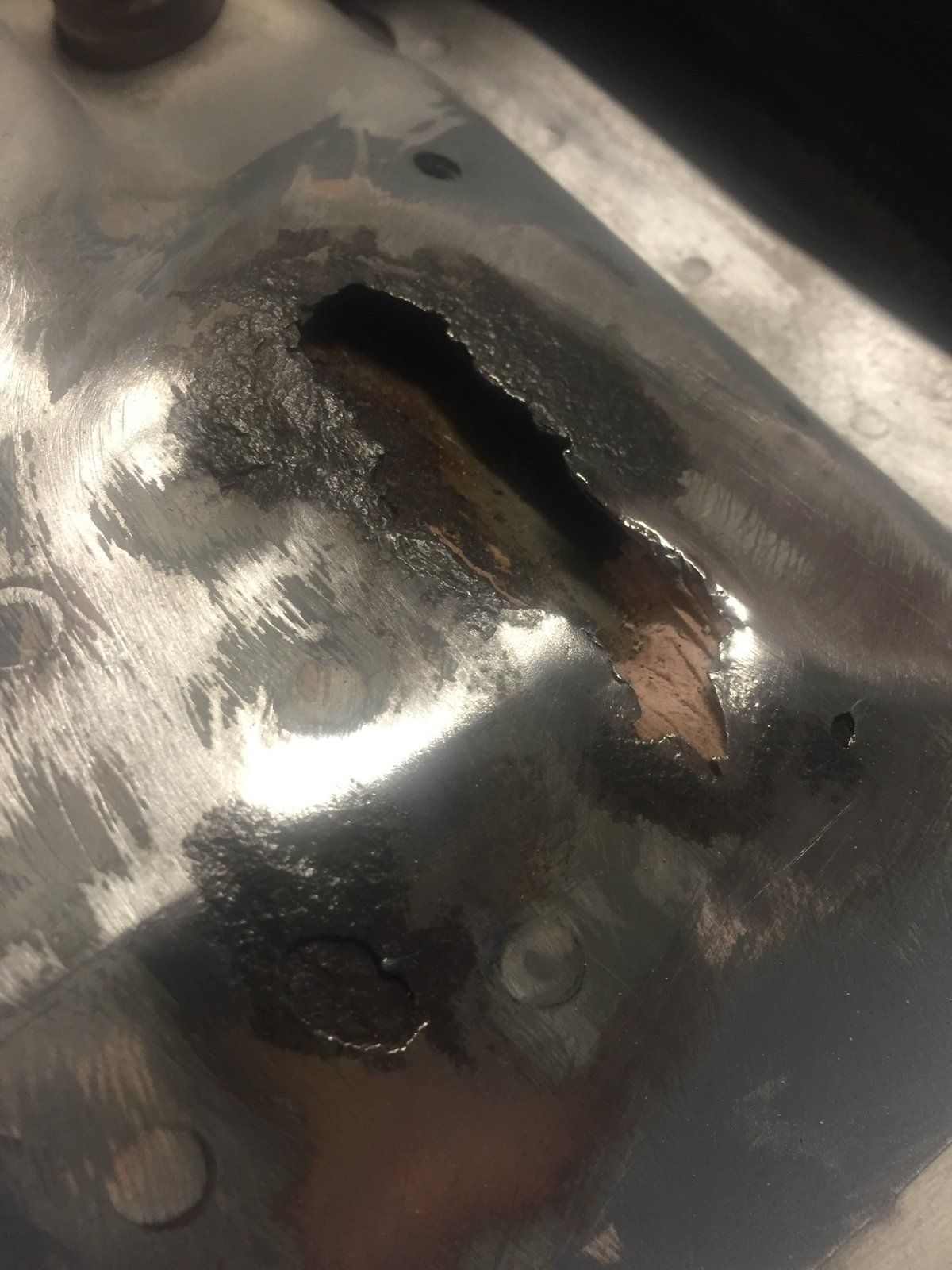

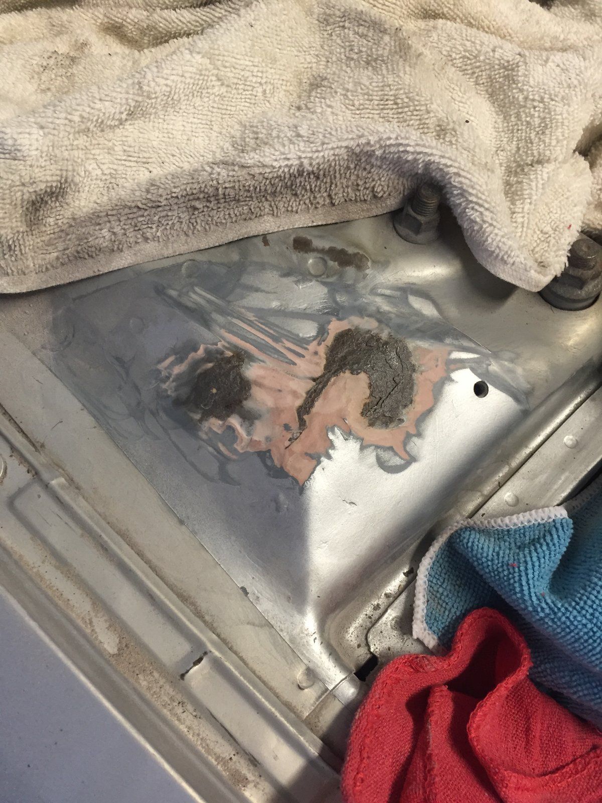

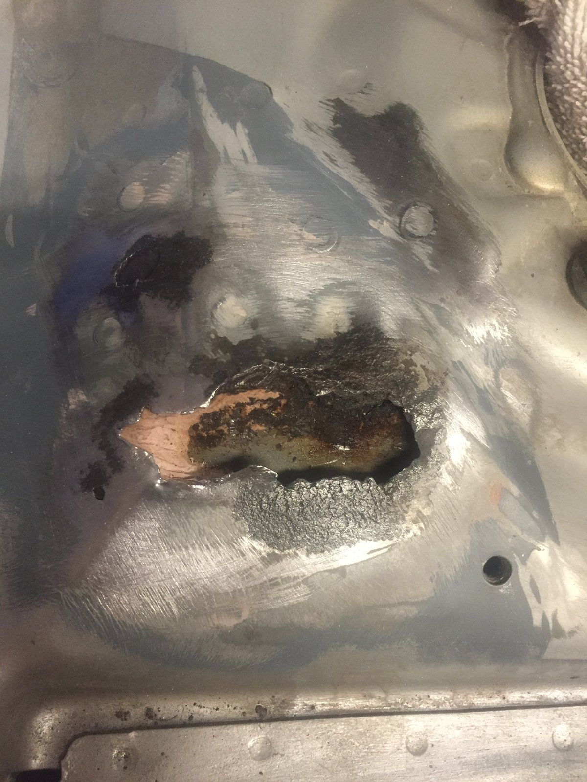

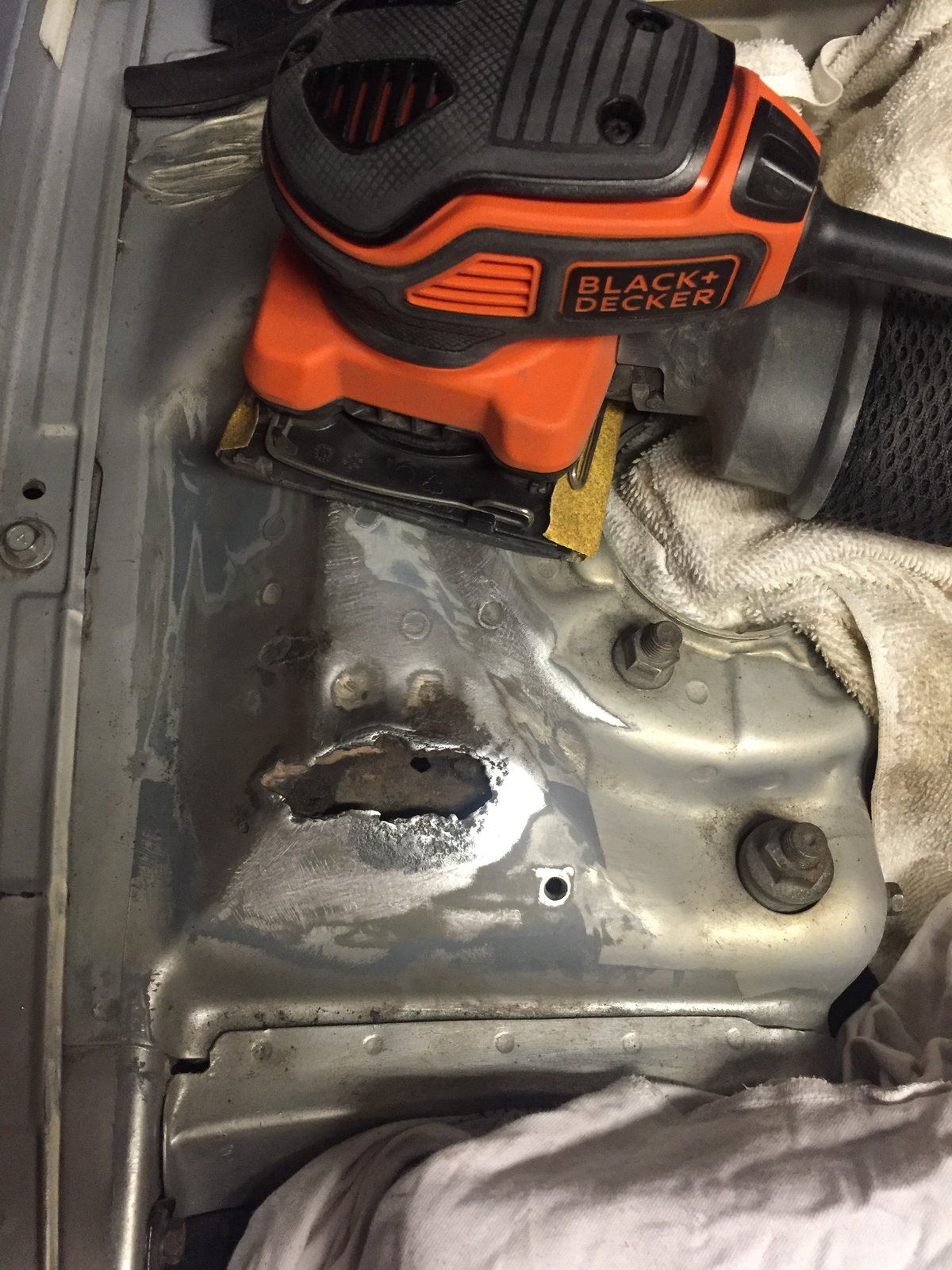

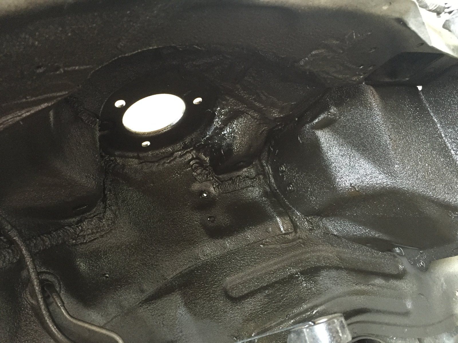

In this post. I decided to attack the Leaking Valve cover gasket. And start figuring out how bad the passenger side strut tower rust is. Obviously there was an attempt to fix the rust. Which looks like a hack job to me. Not sure why bondo would be used. Its very deep in certain places and honestly will probably need to be cut and welded... To be continued.
On another note. I will be buying fresh spark plugs and belts this week. Need to get the car ready for the retune.

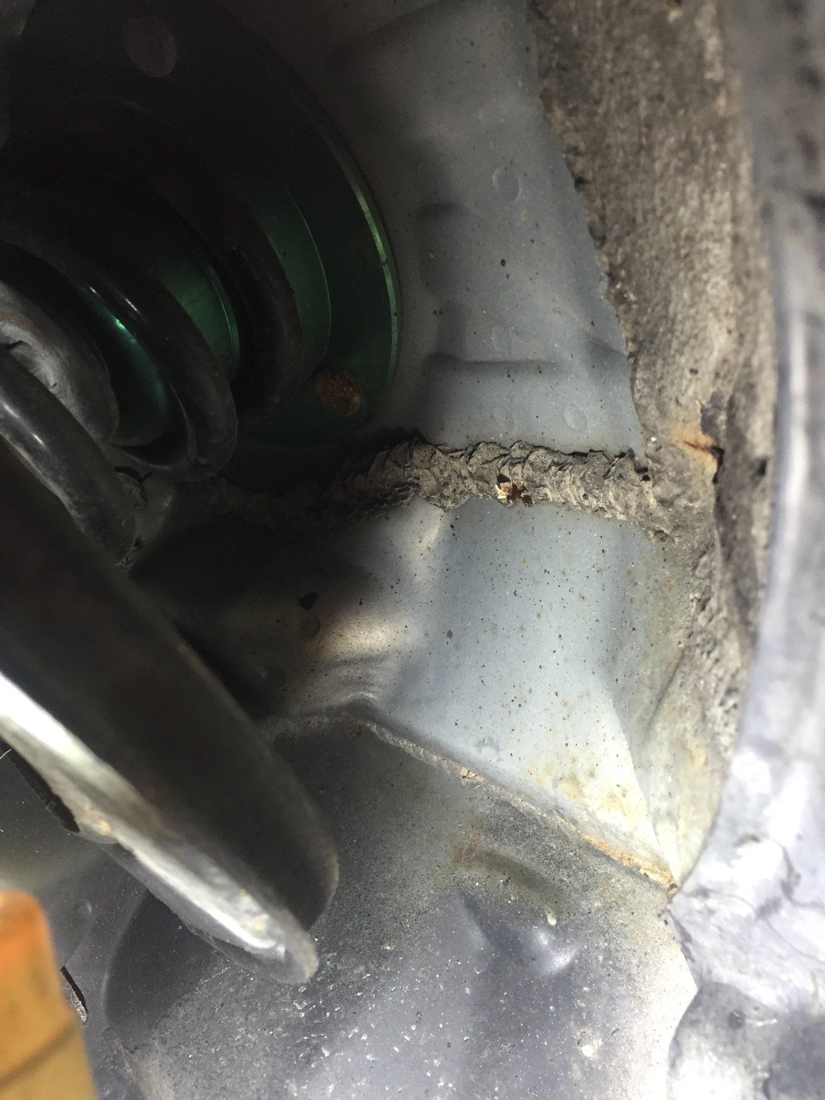

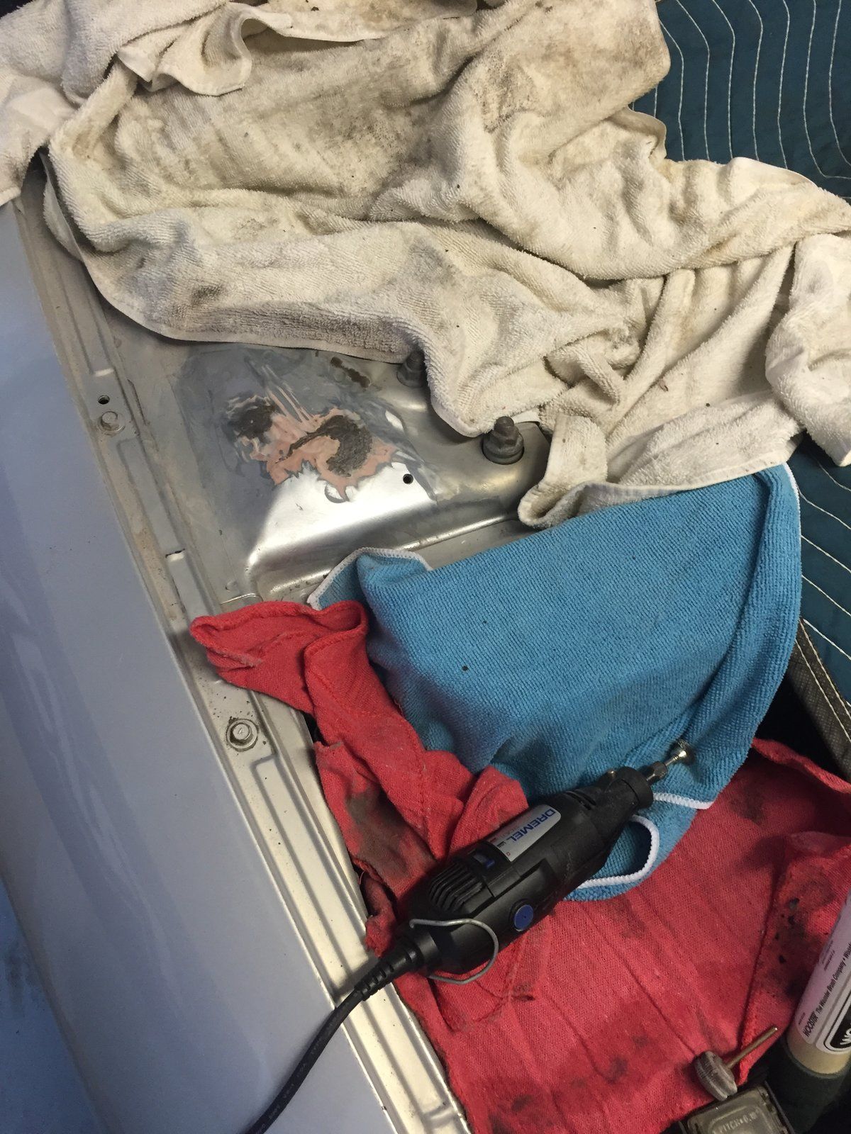

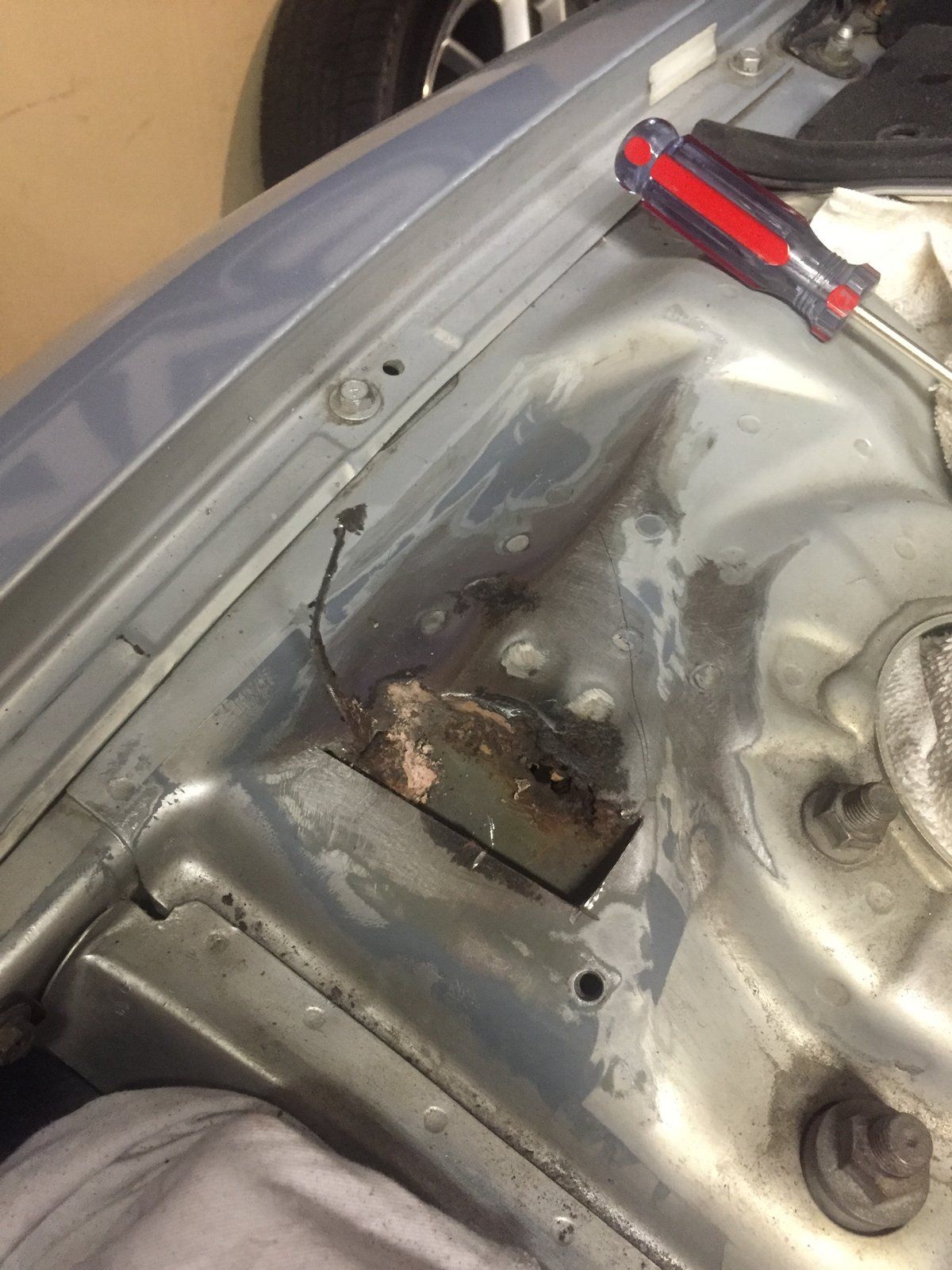

I was able to clean up the strut tower a little more. Also got inside the wheel well to take a look. Found another pocket of rust starting higher up on the strut tower. I am going to try and cut the rusted part of the strut tower out tonight. Need to pic up weld plates 16-18g not sure yet. Then off to my friends to weld it up.
Pics:

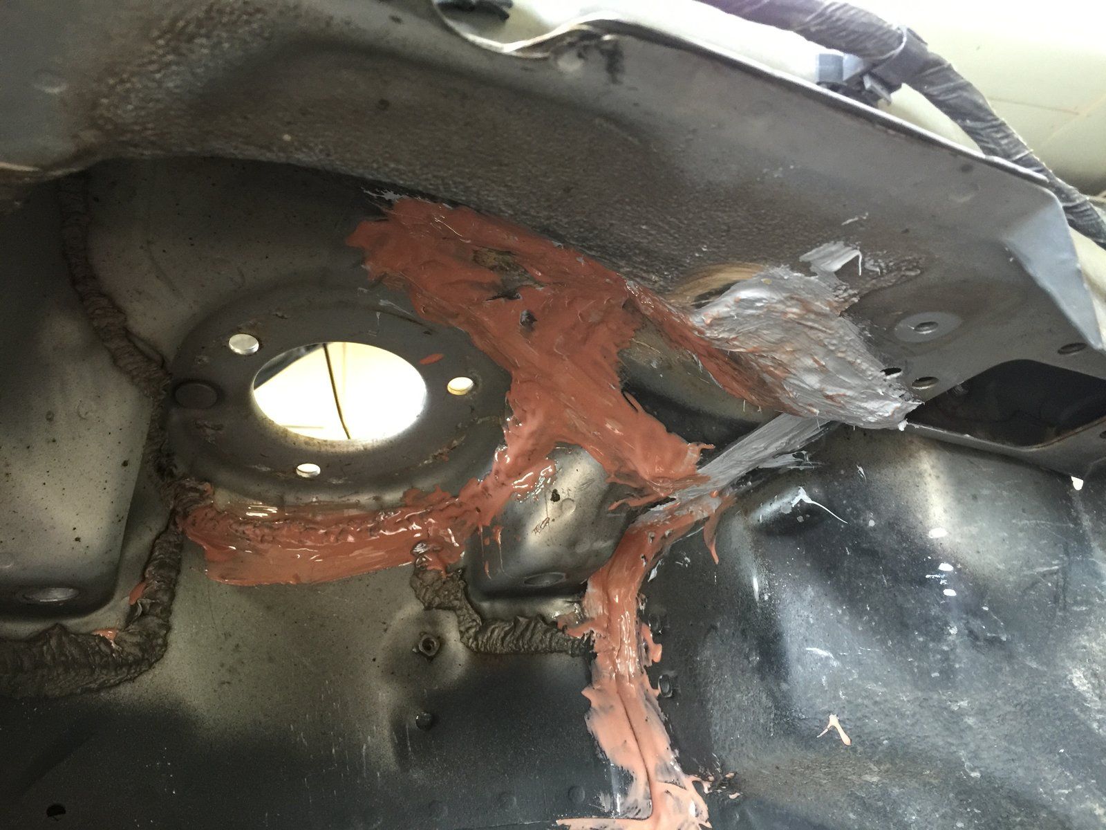

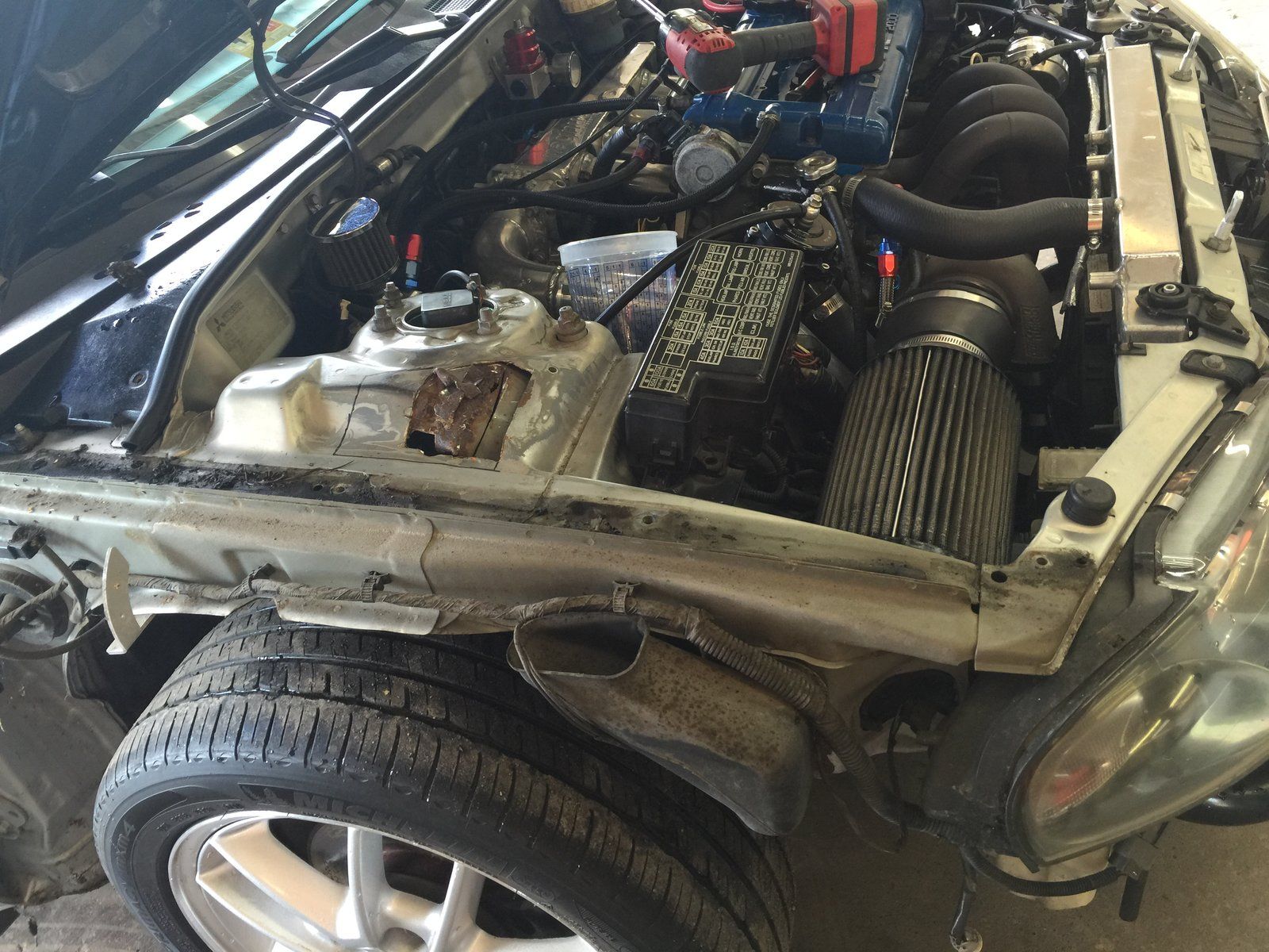

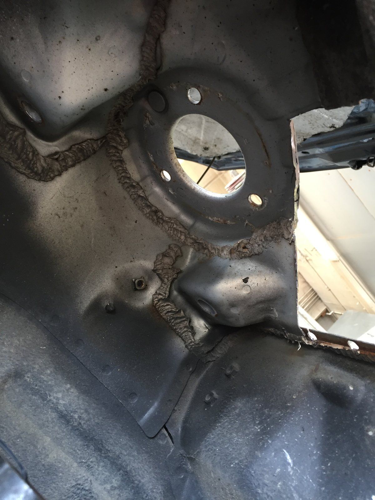

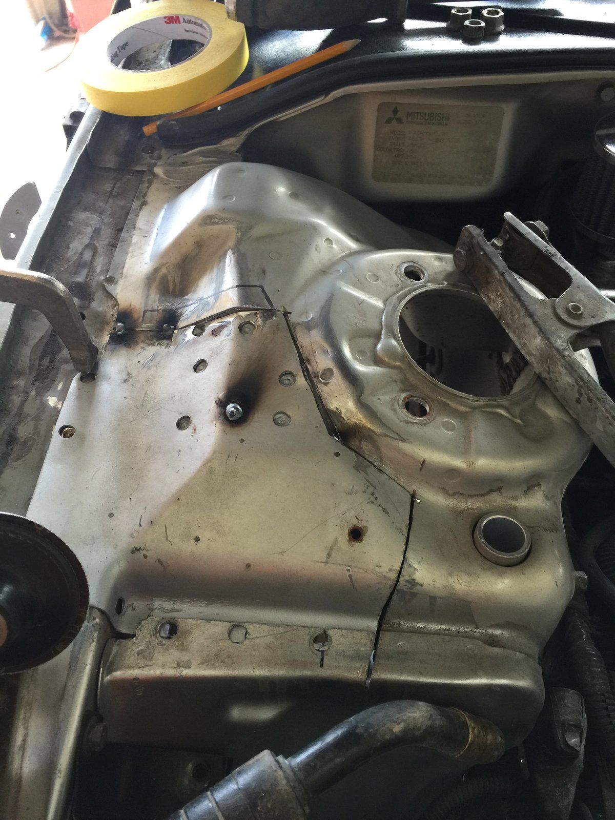

Started to cut out what I thought was the rusted area. Found a lot more on the bottom layer "Sigh". Started to pull the inner fender liner, and passenger fender off. Need to see how much further it really goes. Honestly might be in over my head. Never have attempted body work before and don't even own a welder. I might just get a second opinion on it.

I'm not a DSM expert but I have honestly seen way worse strut towers. I think you will be good long as the person repairing is thorough and you guys dont rush it .
Thanks! ya I have seen much worse also. I just need a nice strong patch that will last for two years or before i shave and tuck the bay. I'm getting the second opinion on Monday night.

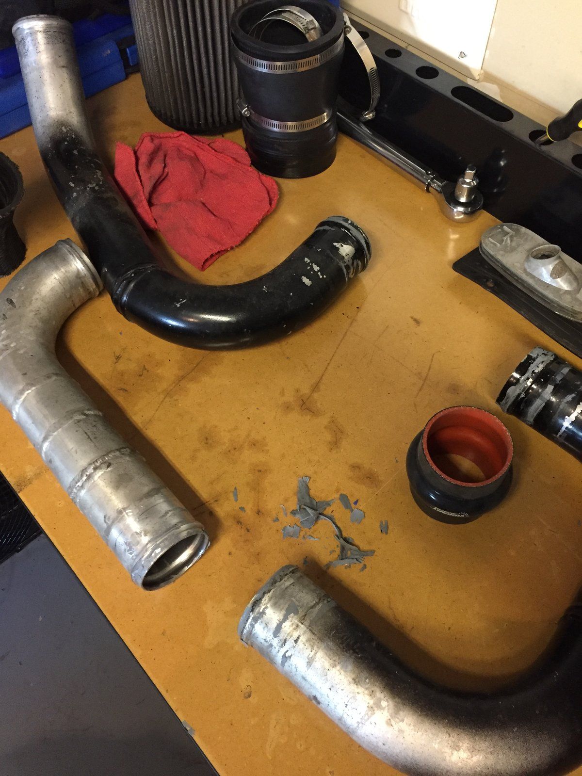

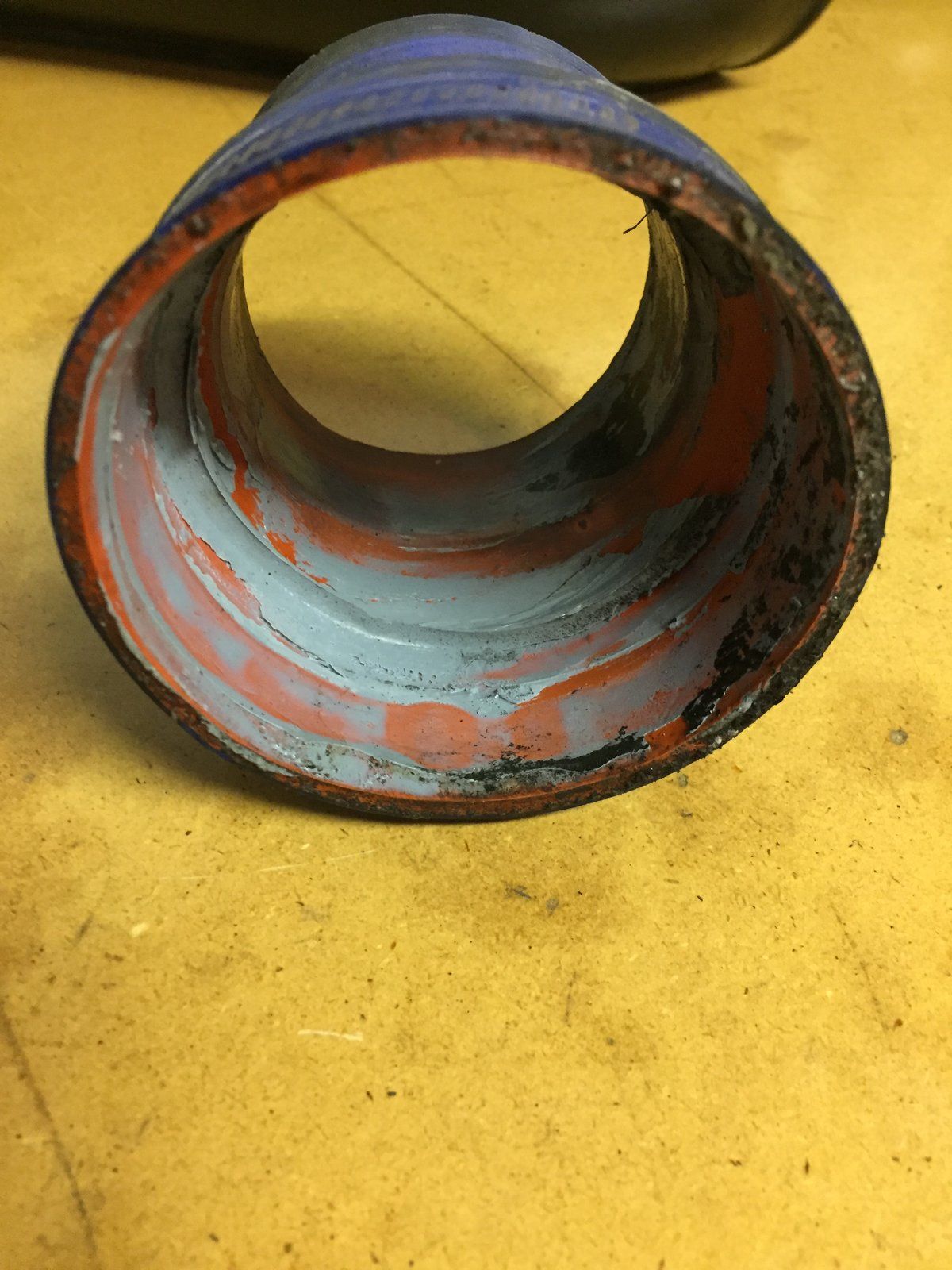

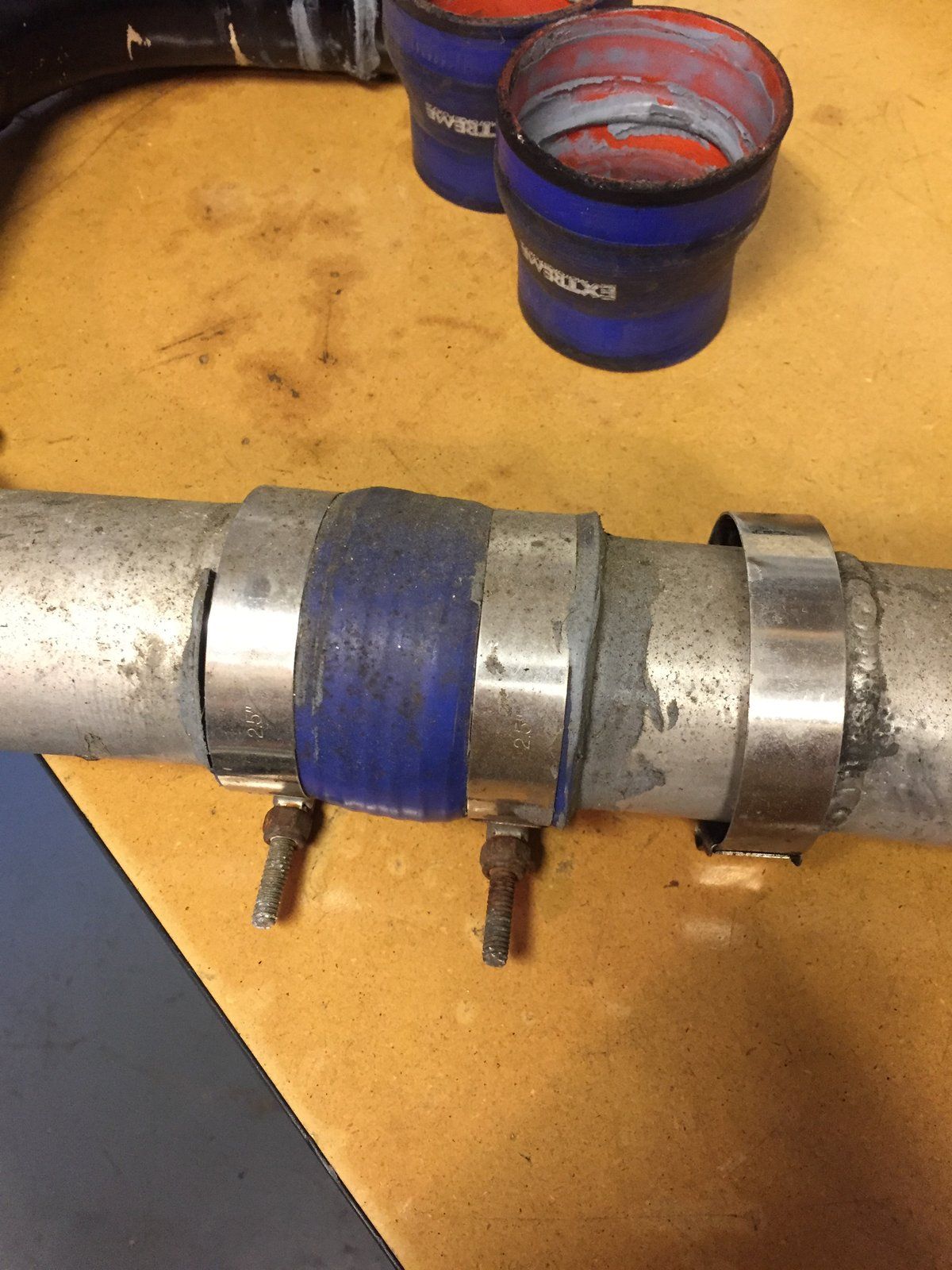

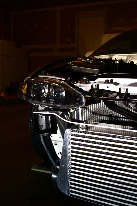

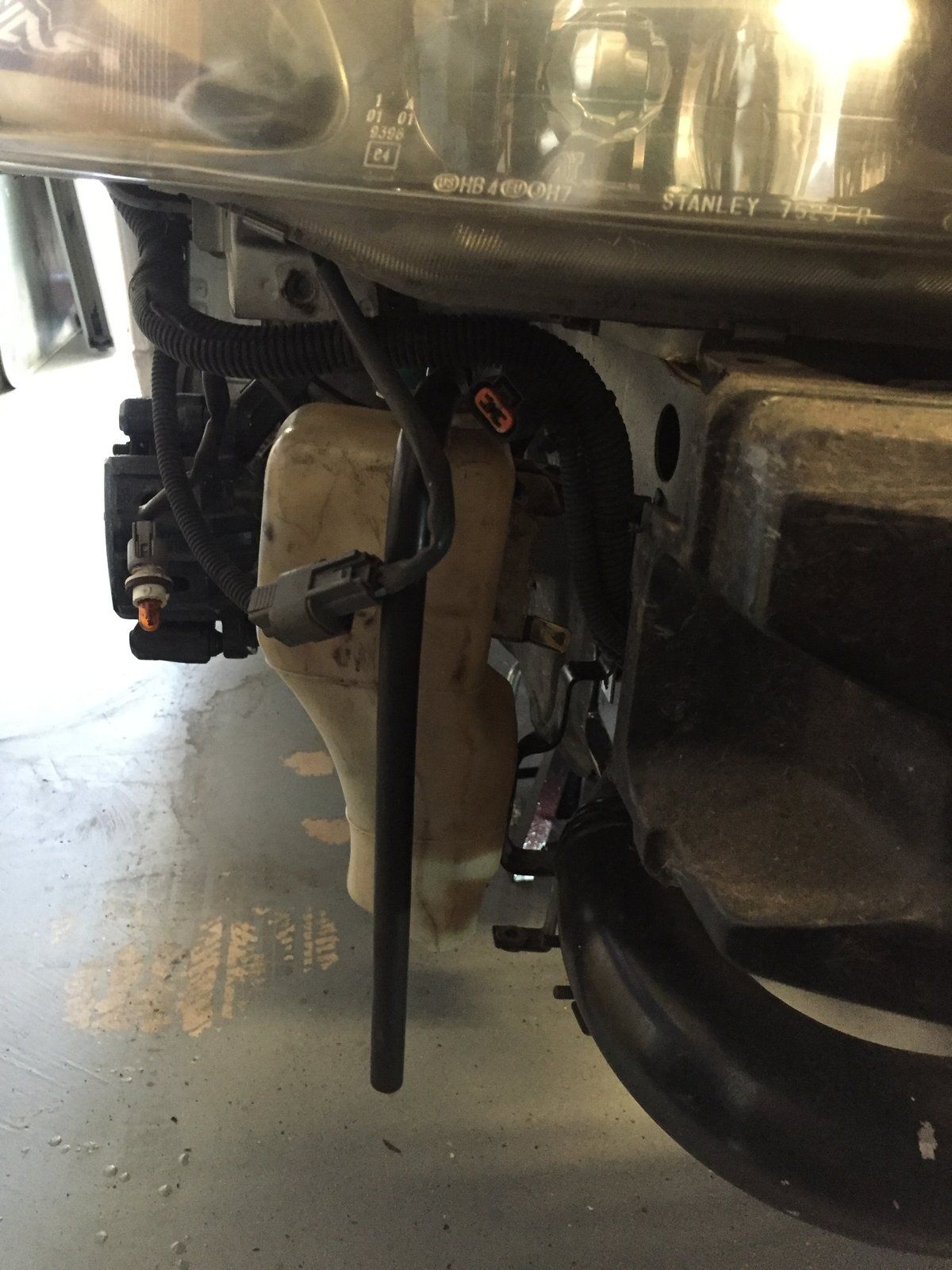

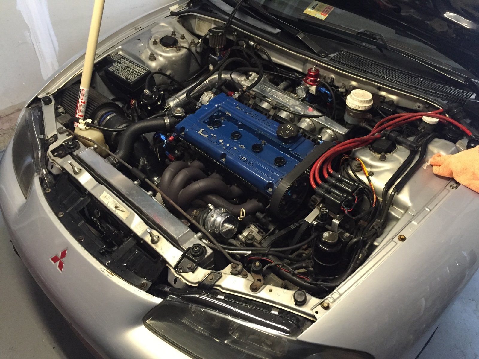

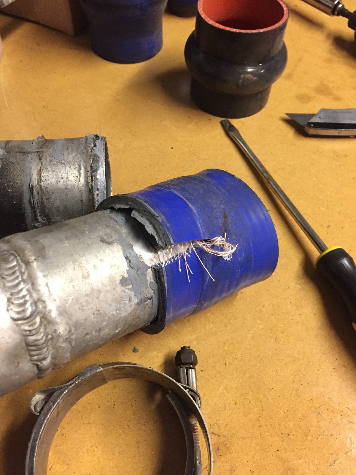

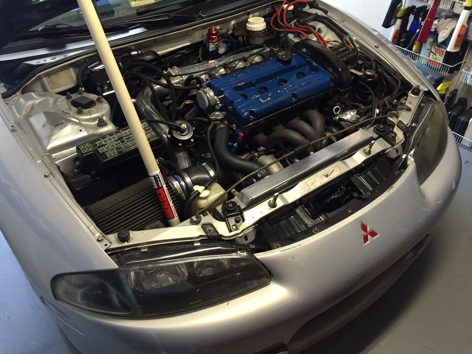

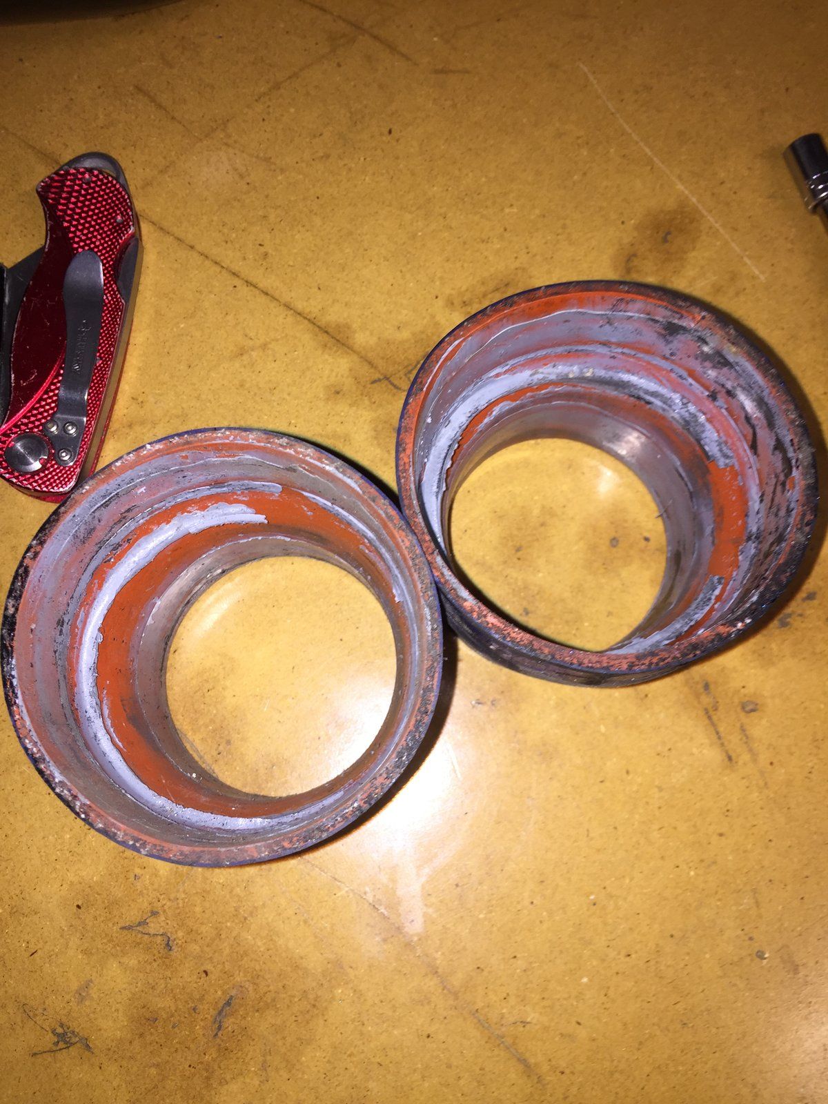

I was looking over the fmic pipes and realized some of the couplers, and clamps looked a little old and worn out. I had some spare stuff so I decide to swap them out.
This is when I got a little surprise. I pulled a coupler and found a ton of silicone on it. All of the rest of the couplers had the same thing. People need to stop working on cars, if there going to be doing stuff like this. I had to cut one of the couplers to get it off the lower pipe.
Pics
Might be easier just to replace the strut tower with a non rusted one. More cutting and welding but you'll sleep better at the end of the day.
Oh man. I guess somebody is using single and double play with cheap Chinese clamps that don't hold sh**.
When I bought mine they had worm clampps on the j pipe so I couldn't see it. Yeah that blew open real quick
Exactly. I match one of the couplers used with some vibrant ones I had left over from my EVO. Vibrant was much thicker. So I ended up cleaning up all the pipe ends and removed the silicone. Then I swapped the old couplers for Vibrant ones and fresh T-Bolts. In total I replaced the two end tank couplers and lower coupler running to the turbo. I reused the upper coupler going the TB. It is an OEM EVO 15 degree bend coupler. I matched it up to a vibrant and it was almost as thick as the vibrant one. Since I didn't have a replacement on hand and the vibrant 15 degree 2.5" couplers, are about $40.00. I decided to hold off for now. I might swap it out before my re-tune.
Thank you for the input. I think I found the guy who is going to be doing the work for me. I'm getting a quote tonight.
Like you said, I might just have to replace the whole tower. Well see.
Stay tuned..

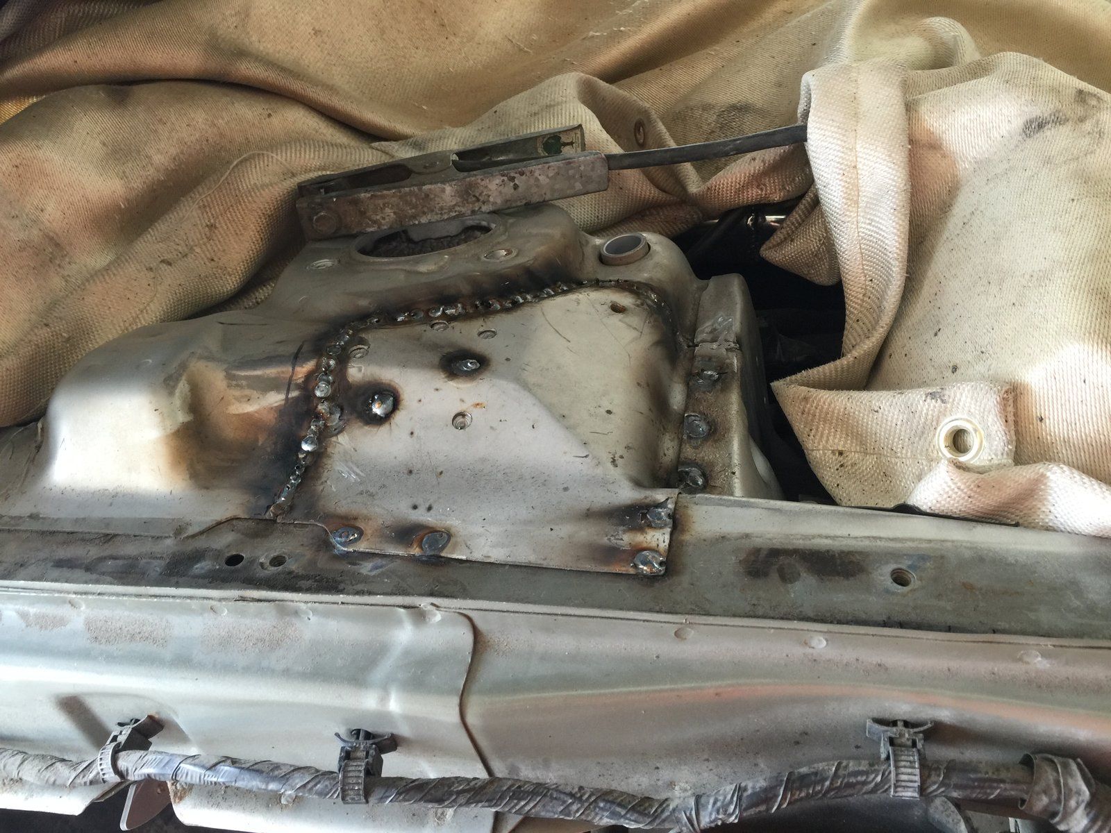

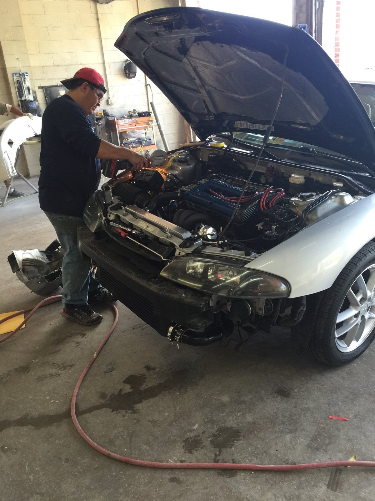

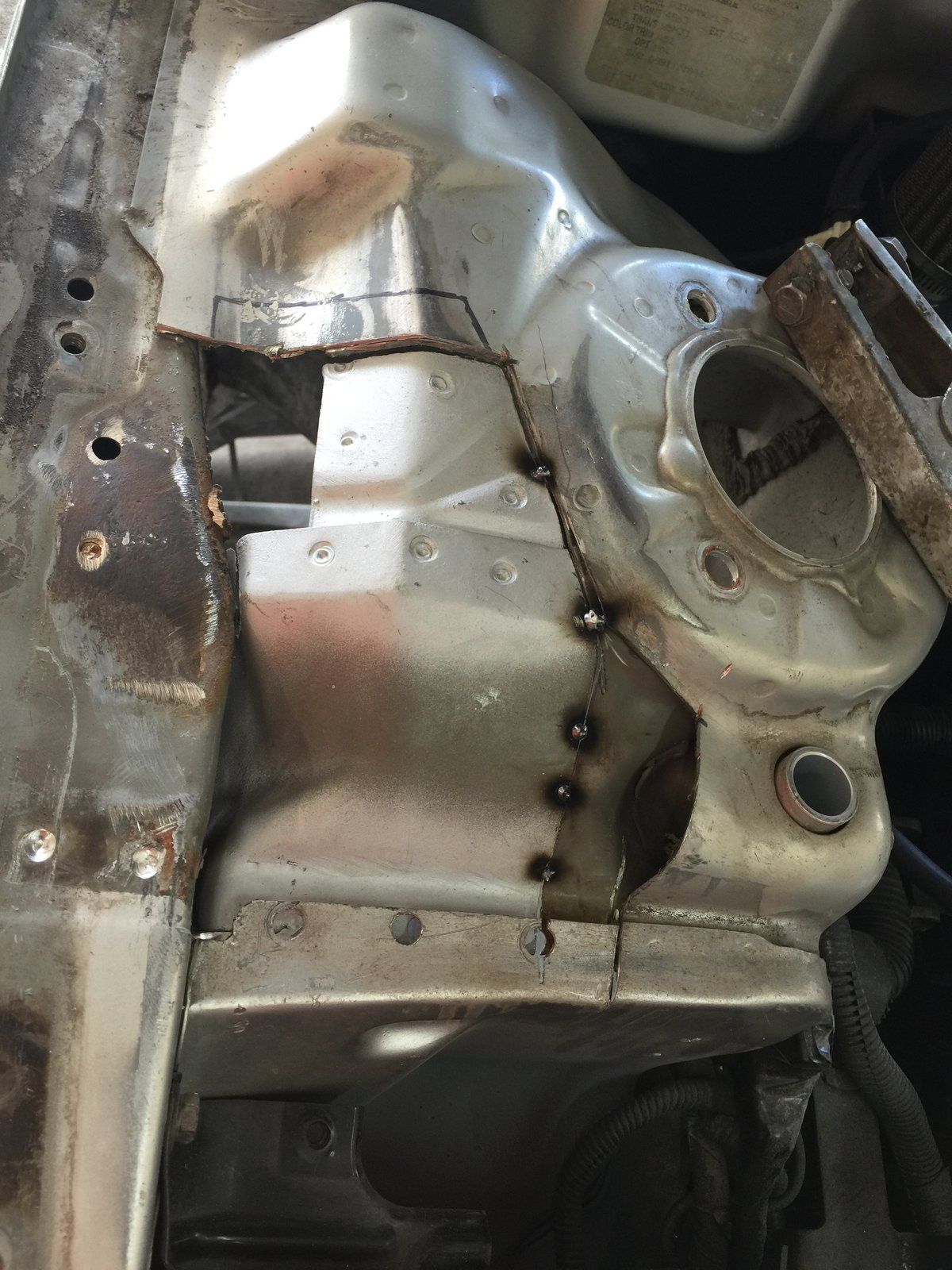

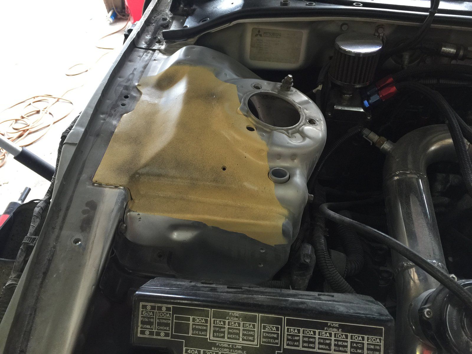

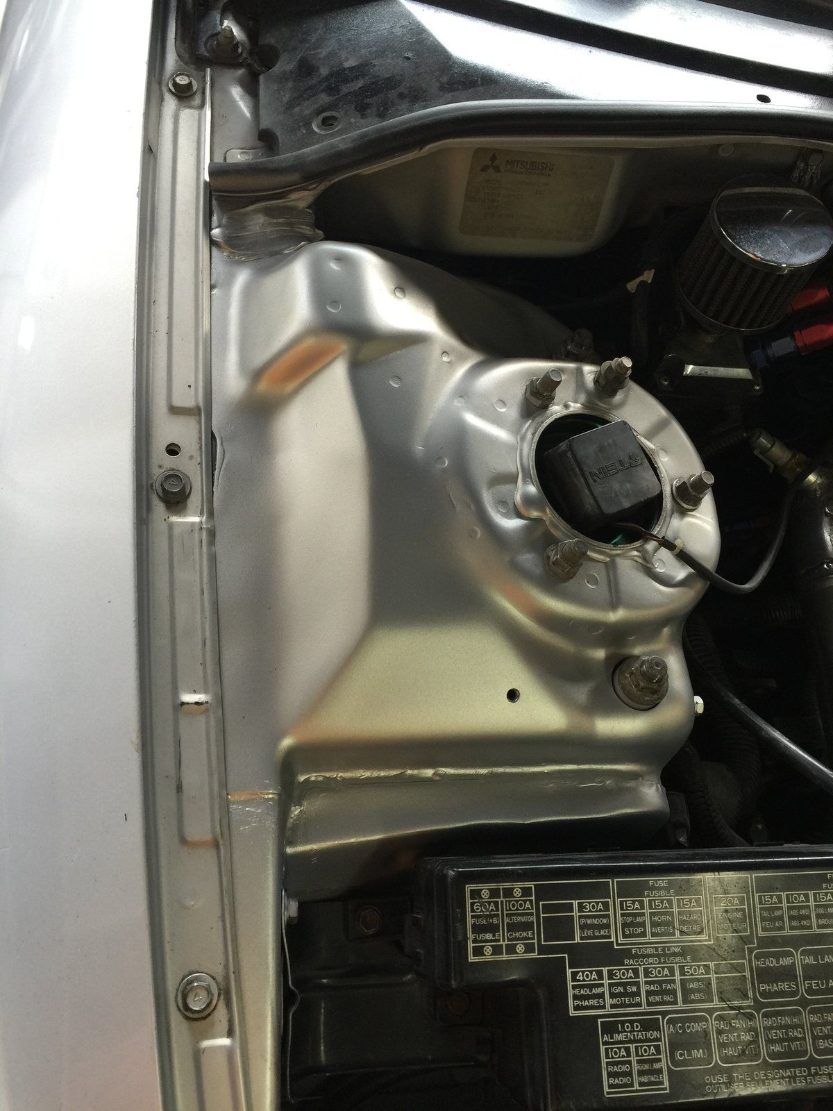

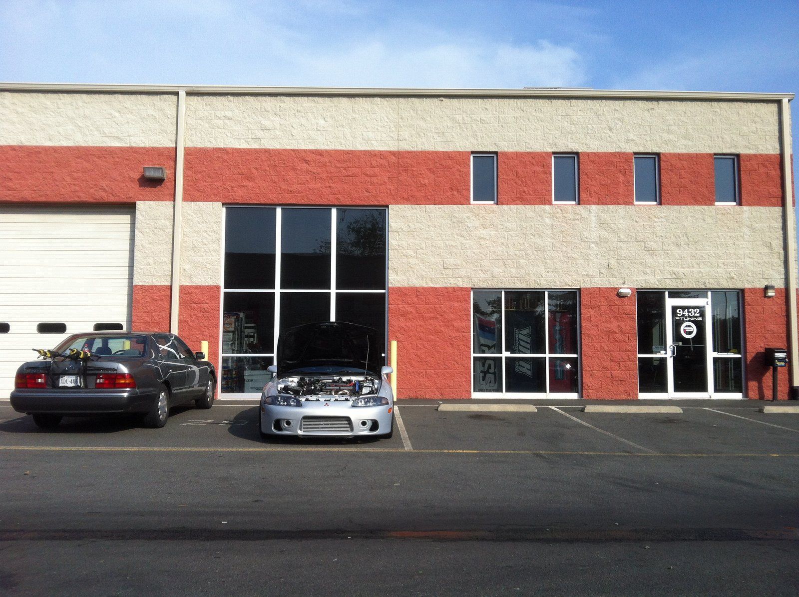

Dropped the car off at the body shop last Saturday for repair. They talked me into buying a complete strut tower from a donor car. I contacted Miller Imports and purchased a full replacement strut.
Hopefully ill have the car back sometime next week. After that I will probably park the car for a while. I need a new daily so I have to start looking around.
