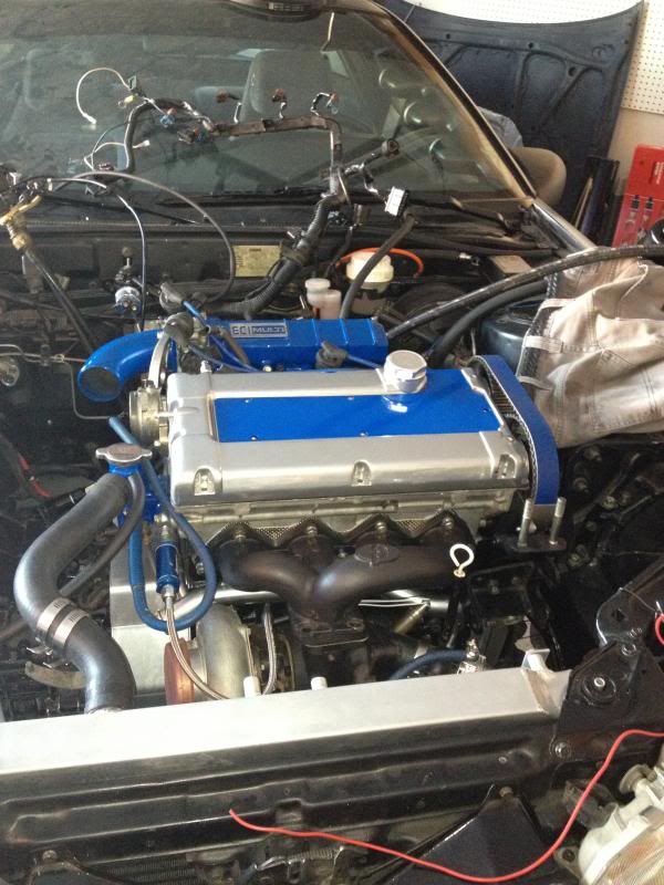

As she sits

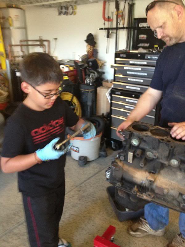

I was about to give up on this, but my son and I have put so much time in to Stick I didnt want to be a quitter
Bren and Chris

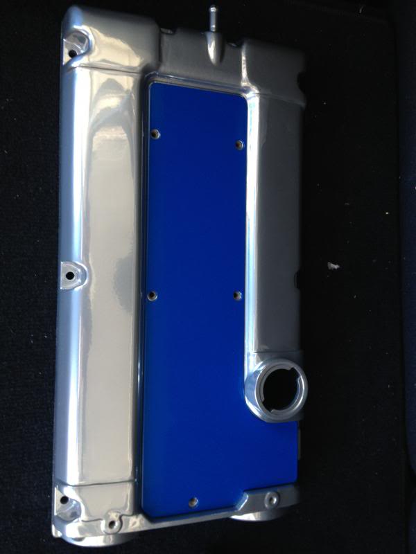

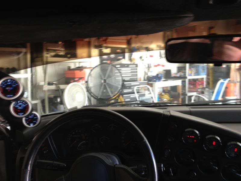

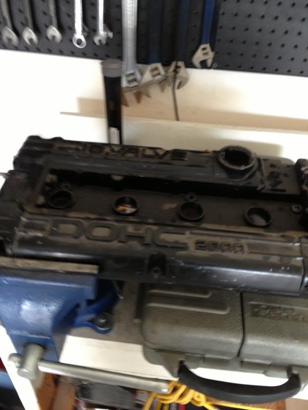

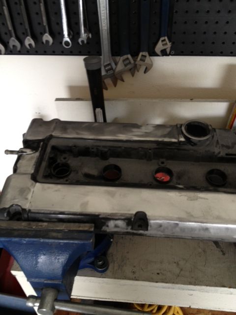

Well its been slow, but Im in no hurry. Moving next week and waiting to get in to the new house before I pull the engine. So far Ive pick up misc gaskets, L19 head studs, BSE, VC is at the powder coater. Once we get all moved we'll see how much I can pi$$ of the new neighbors haha

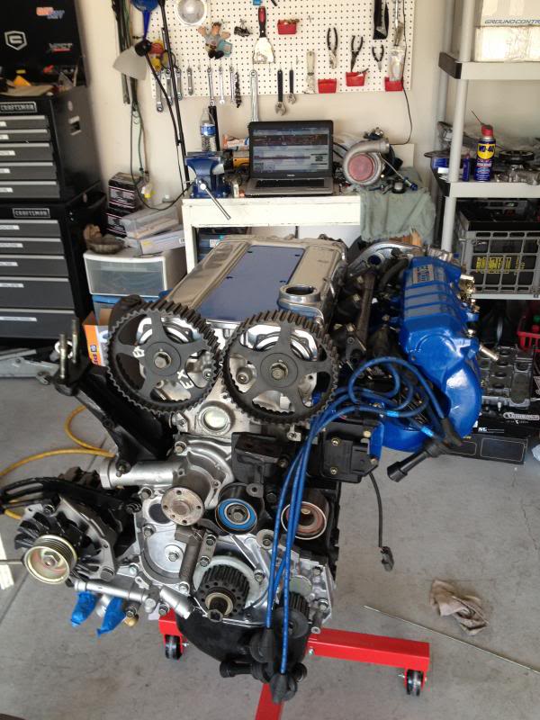

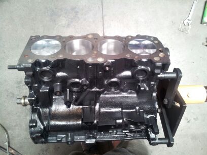

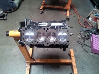

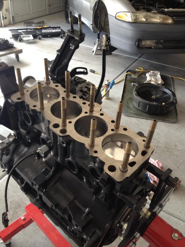

Well got the block back last week. I managed to lose the front case and head dowels in the move, so put in a order with STM. Waiting on another bonus for Fluiddapr and 2 new AEM gauges, Ill be replacing the 2 glowshits in the vent with digital boost and OP. Heres the CP/Eagle combo at 10.0, .020 over decked. Being ove 110* here lately, Im dreading working in the garage.
Well got the block back last week. I managed to lose the front case and head dowels in the move, so put in a order with STM. Waiting on another bonus for Fluiddapr and 2 new AEM gauges, Ill be replacing the 2 glowshits in the vent with digital boost and OP. Heres the CP/Eagle combo at 10.5, .020 over decked. Being ove 110* here lately, Im dreading working in the garage.
These piston are 10.5:1 only in evo 4G63 :) in ours are only 10:1 , I have the same cr pistons but wiseco for my race build. Evos have 43cc combustion chamber and we have a 47cc , so we lose 0,5cr in our dsm 4g63s :)
I'm on the same boat as you, it's either rebuild or be done, just sitting tight and saving up some cash again, good luck with it! Seems like these cars are never easy.

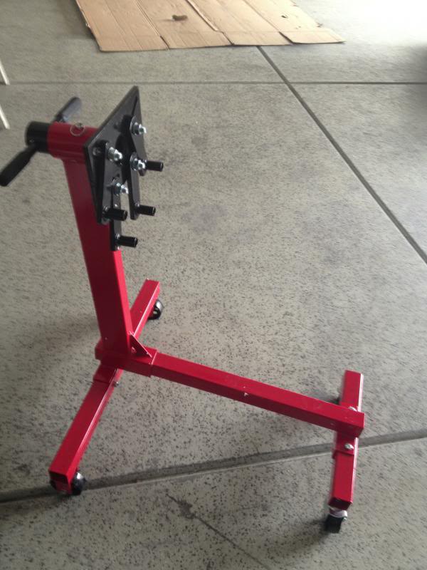

How come your engine stand when from being red to orange WTF!!?
The picture was sent from the builders shop :)
Thanks Pursuit, I was texting the builder last night about that :ohdamn:

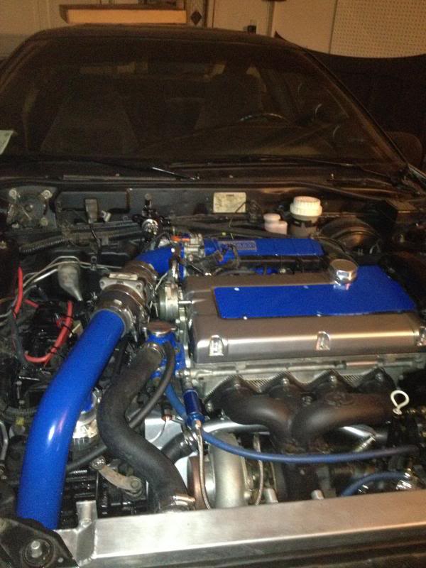

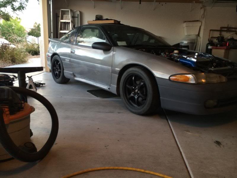

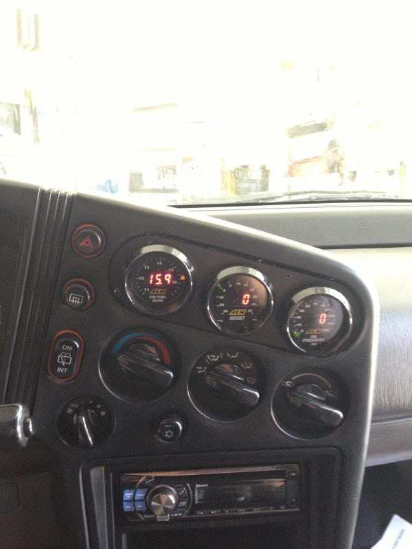

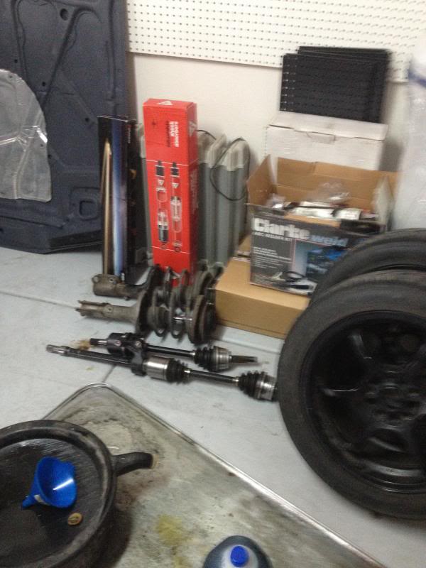

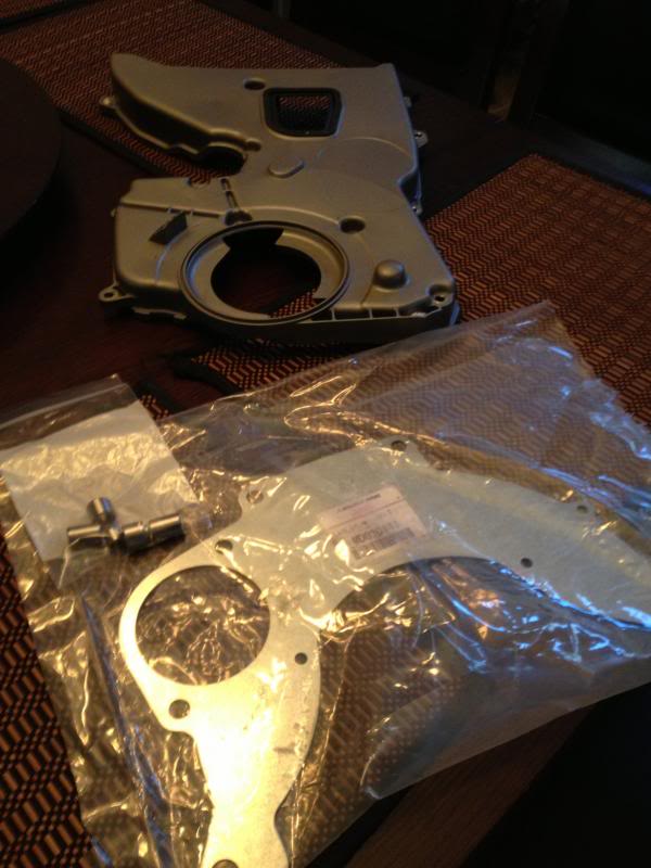

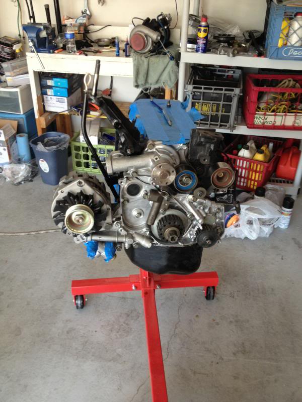

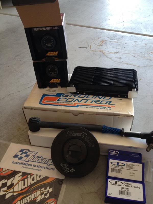

Few updates, she's all bled out except the t-case. Some of the things Ive picked up.

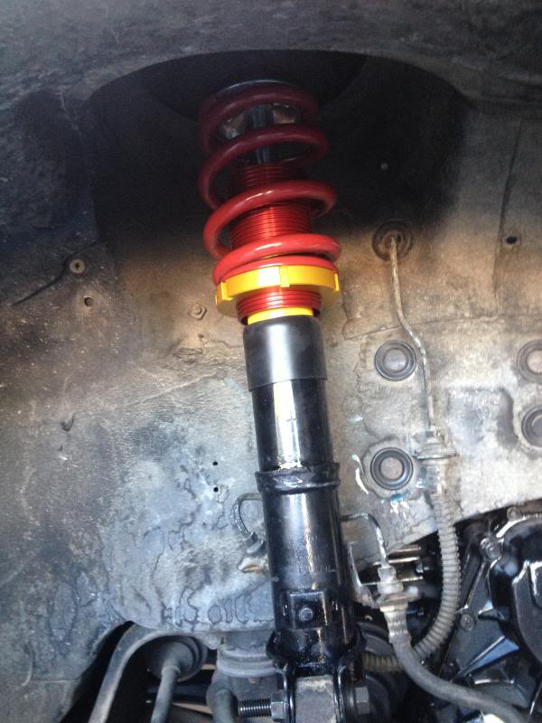

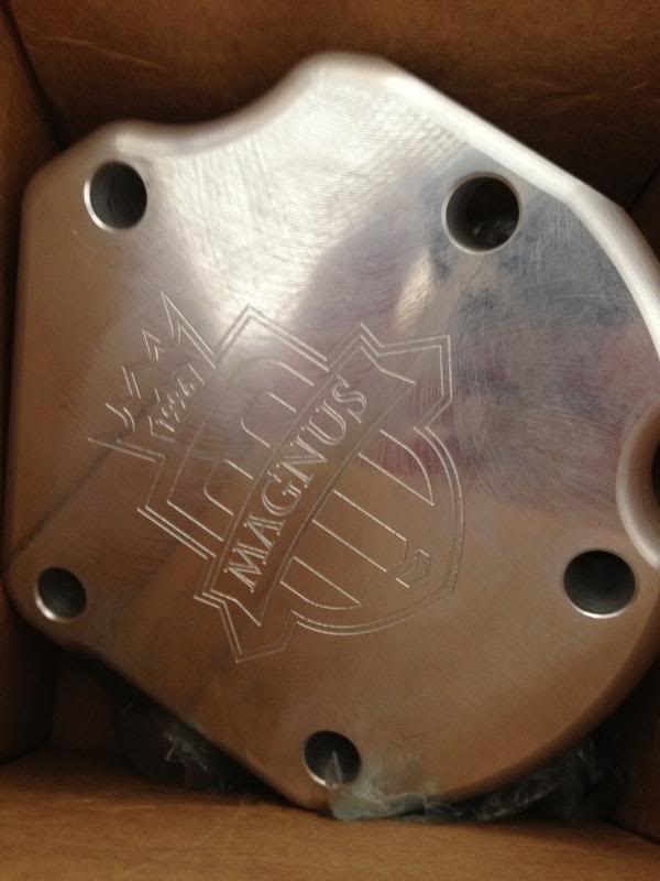

Still waiting on the front Konis to be drop shipped and the Magnus t-case caps. Heres a cool sunset photo from Hawaii 2 weeks ago :)

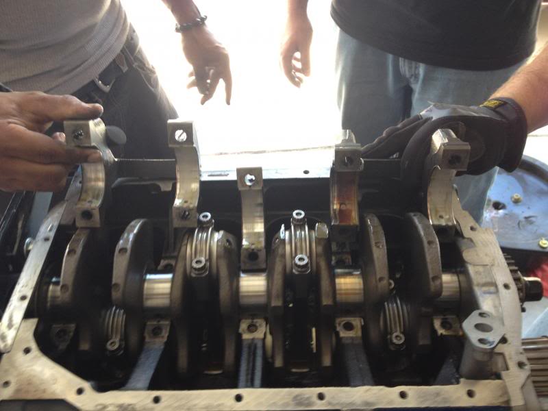

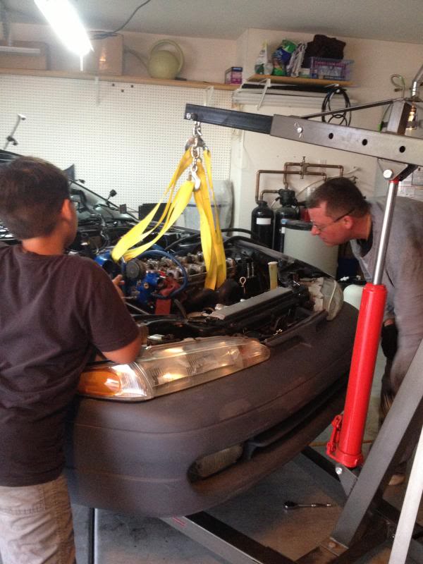

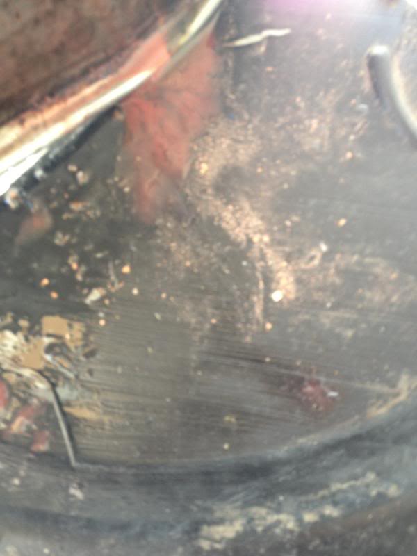

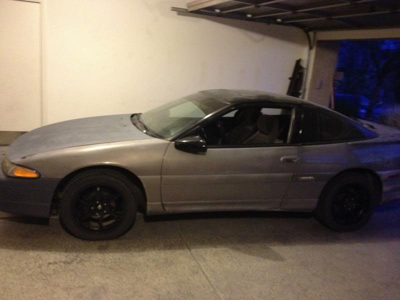

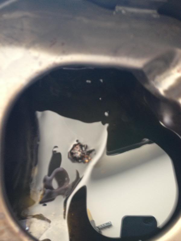

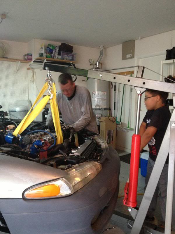

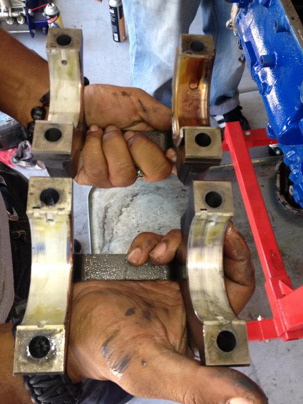

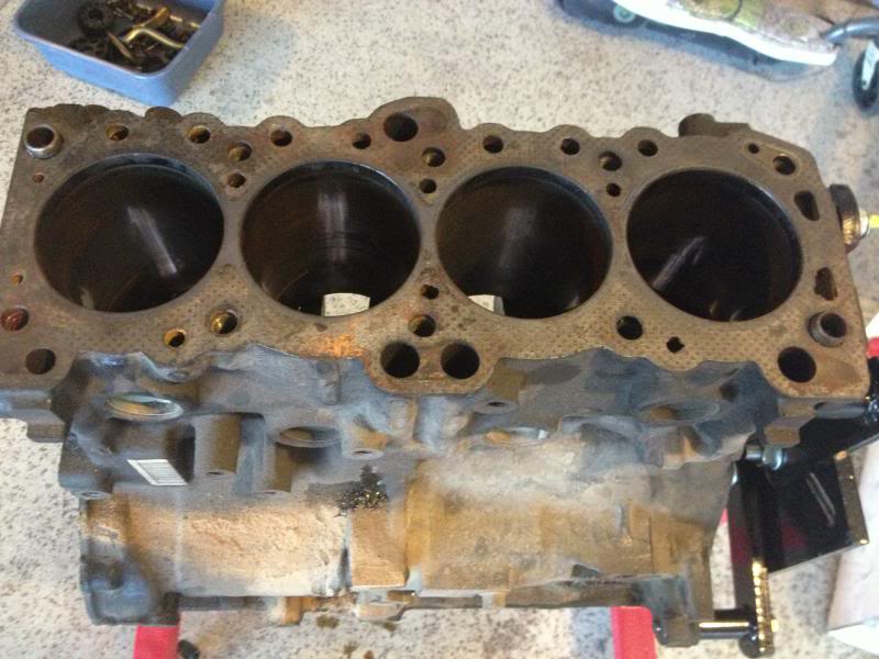

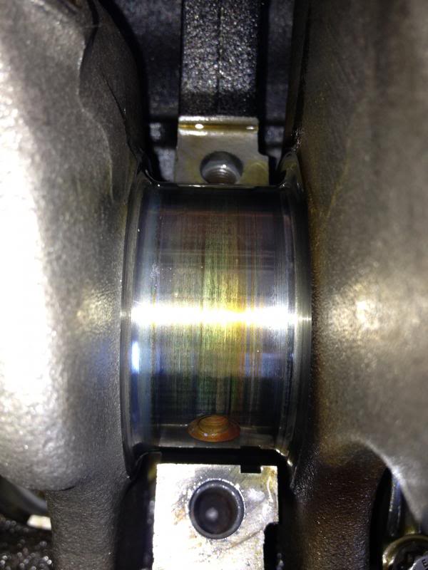

Well yesterday was swap day...engines in and tore apart the broken motor, enjoy the carnage and stupidity of the builder.
carnage
that's not sand
WTF the thrust bearing doesn't go there :banghead:
