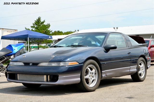

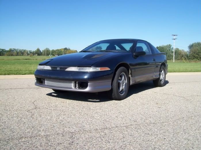

I had been dsmless since August of 2008 and really didn't have the funds for a new project. A friend called me up and asked if I wanted a 1990 TSI AWD, of course I said yes, but there wasn't money for such a thing. Then he dropped the good news, it was just a shell and it was free.

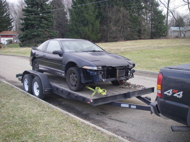

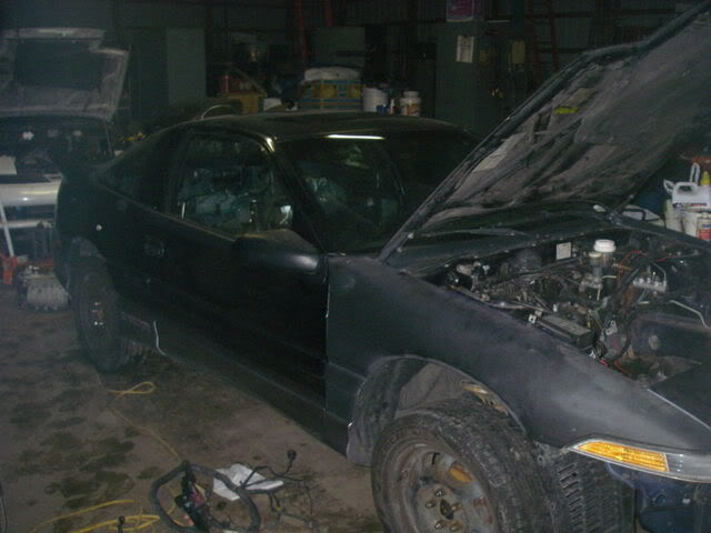

Had a friend load up his trailer and we journeyed to Ohio to pick up the new shell.
I was living in an apartment at the time and had no place to work on the car, another friend offerred his garage for me to use. Fortunately he understood this wasn't going to be a short stay as I collected parts. This is essentially what I started out with.
Fortunately I had quite a few parts left over from my previous dsms. I also have a good amount of friends in the dsm community who blessed me with free and discounted parts.
There were alot of setbacks, from an oil pump stuffed with some kind of white lithium greese from the previous owner causing a no oil pressure issues, a broken fuel line from the sending unit, an auto rear end instead of a manual, a n/t engine harness, and that's not to mention trying to source every bolt, nut, washer, spacer, etc. to make a running car out of a shell. But, it all started coming together. BTW, the motor was a stock longblock that I nabbed for 300 bucks, most expensive part of the build, including that freshly built transmission which was built with all the goodies. Talk about good friends.

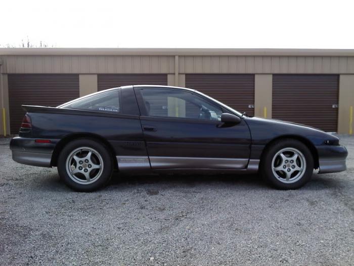

June 2009
The car finally came home under it's own power. The car bucked at 4500 rpms due to a faulty ecu, boost leaked like crazy, had a honda civic radiator which overheated, and ran on an open downpipe. But, it ran!

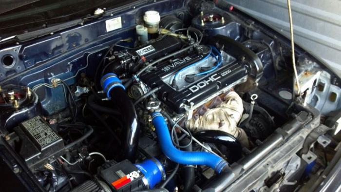

October 2009

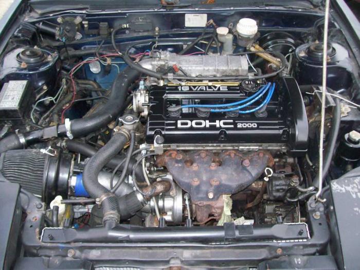

I ended up with a borrowed ecu, megan racing catback, and did a whole lot of boost leak fixing over those last few months. I did get to take it to the 2009 DSM/Evo Shootout, first time taking a DSM. I was finally confident in taking the car to the track for the first time. Unfortunately the Talon would begin it's long line of track breakage! I set a tentative goal of hitting 13's, which I accomplished on the first run while missing 4th gear. This was on 14 psi with the 14b.

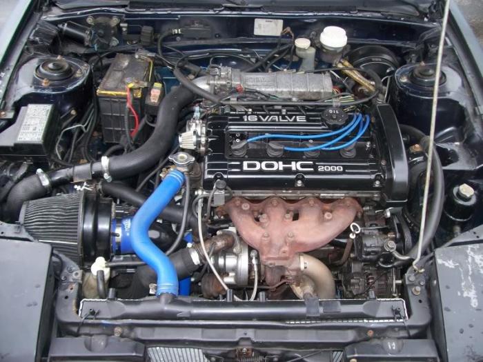

Mod List at the Time:
14b w/7cm ported hotside
SBR 1st gen Cast manifold, ported heavily
2.5" O2 housing
3" Punishment DP, 3" test pipe, 3" Megan Racing Catback
Hacked 1g maf
Hard intake pipe w/K&N filter
Unknown fuel pump (Later replaced w/Walbro 255hp)
Built trans w/welded center diff, double syncro's etc.
ACT 2600 (old style)
ARP's

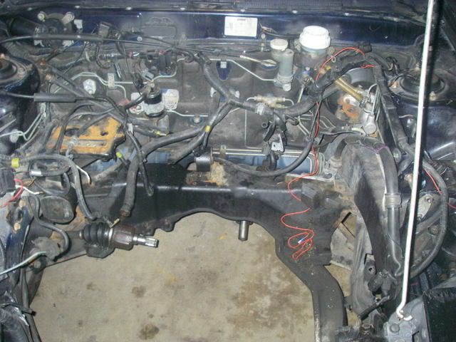

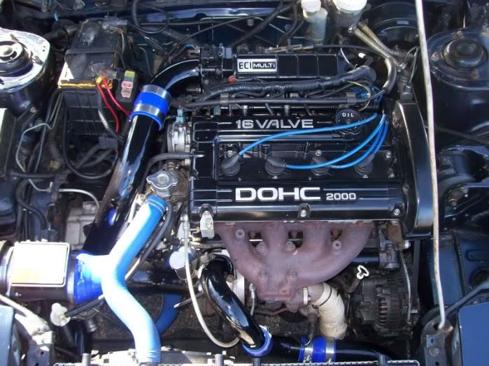

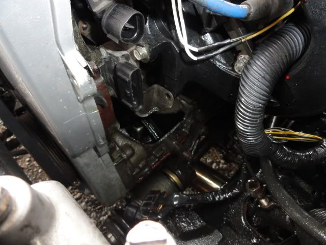

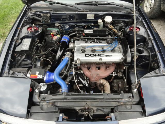

This is the engine bay after my track visit, it's humerous how everything looks fine on the surface when a motor has internal issues.

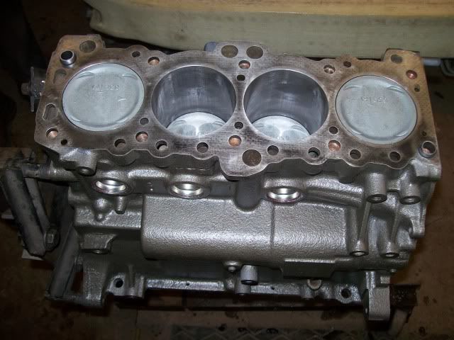

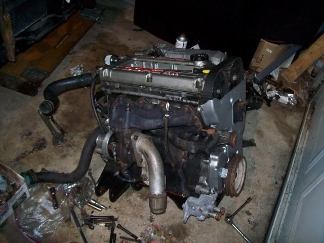

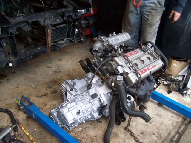

Same buddy who drove his pickup and trailer down to Ohio offered to help me rebuild the engine. I decided on ITM 2g pistons, 1g rods w/arps, and all new gaskets/bearings.
As from the beginning funds were very tight and putting this thing back together took alot of time and patience.
Mid April 2010
Finally brought the car home again and started the break-in process. We discovered a nasty hole/crack in my SBR manifold I had been given so we swapped in a 2g manifold during the engine rebuild process.

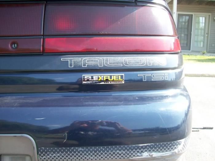

Installed an AEM Wideband, FIC 1050cc injectors, and E-85 fuel! And got a freebie Carbon Fiber hood.

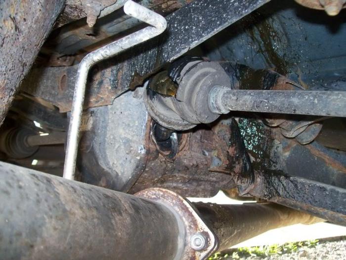

Got a 4 bolt rear swapped into the talon after having wrecked the old 3 bolt rear. I also added an Extrude Honed 1g Intake manifold I stole from a seller here on DSMTuners, thanks again, can't remember the name. Decided to go all out at the shootout and run the car. I wasn't sure what to expect, all I wanted was a 12.999. Here's an excerpt from my thread on another forum with what happened.

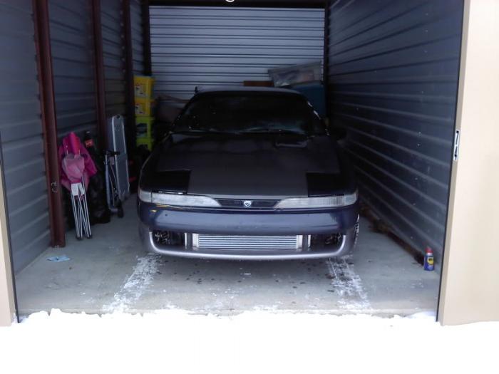

Found a nice cozy winter storage home for the talon.

Soon after the track visit my T-case locked up while cruising. Turned out the "new" borrowed driveshaft allowed my T-case to leak which cracked it right up the side once it heated up from lack of fluid. I tried another replacement yolk and seal but even after putting in a replacement T-case it leaked. I constantly would fill the driveshaft up from then through the rest of the season.

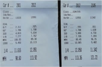

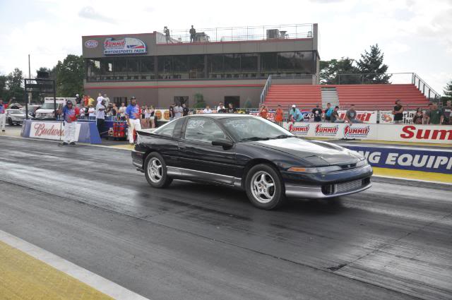

Took my 14b talon to the dsm/evo shootout in Norwalk hoping for a new best.
I got there exactly at 9 and headed for the lines hoping for a pass or two while it was cool out. Hit the line and headed for the lights. The car hooked up instantly, track was very sticky! If I'd been better with the clutch the track was perfect for some great passes, alas I need a better driver mod. Cut a 1.7 60 ft. But when I grabbed the timeslip I was still ecstatic. 12.091 @ 113.92!
Had a couple issues and we finally got lined up for the first qualifying round. Tried to hit the launch better but the tires broke loose and I managed another 1.7 sixty. But I hit the new personal best of 12.050 @ 113.36. Timeslip breakdown
1.708 60 ft.
7.709 1/8th ET
89.49 1/8th mph
12.050 1/4th ET
113.36 1/4 MPH
Then it started to rain
Fortunately it cleared up and I got three more passes in, but between the track prep going away and it heating up I couldn't get the timeslips down. The runs went down like this:
12.132 @ 112.82 (Launched about sideways from the wheels spinning, shows a 1.67 60ft though)
12.8 @ 111.83 (Didn't lift foot all the way off clutch enabling NLTS off the launch! OOPS!)
12.139 @ 112.72 (Once again spinning hard, but a 1.69 60 ft anyways)

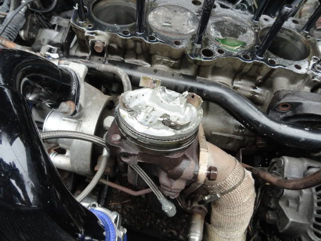

I was looking for any last little edge and decided to shim the wastegate to see if it could hold a little more boost. I never noticed a drop off at higher rpm, but wasn't really watching the boost gauge anyways. I shimmed it a little too much and overboosted for all of about 1 second...it was enough. Personally I still think the engine should have survived, only that piston failed which caused the rod to go through the block, everything else looked perfect. ITM pistons aren't known for being great...lesson learned.
I replaced a bent valve and threw in a spare stock 1g 6 bolt block and had nothing but knock issues with it. The car was put in storage and wasn't pulled back out until.
August 2012
Pulled the head and did a thorough check over and discovered the other intake valve was bent ever so slightly. I had 115 psi compression in that cylinder and had been blaming it on the old stock block. Yes you can have a bent valve and still have compression! Replaced it and drove the car to the 20th Annual DSM/Evo shootout. Got bit by the racing bug bad again. This last week I started tuning again and got a good baseline on the car for a track visit. I'm hoping to have track results again soon. I'm setting the only 2012 goals as getting back under 12.5. Hoping everything stays together!

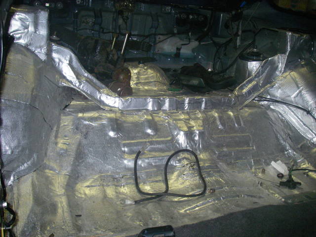

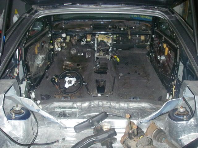

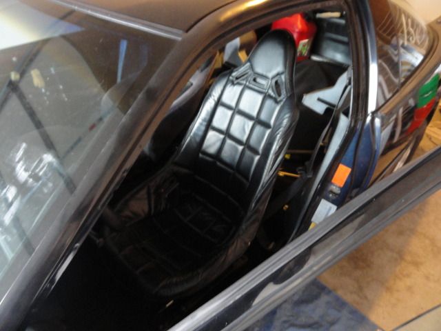

Well got started on the weight reduction plan today. Removed the front drivers seat and started fabbing a mount for my summit racing seat. After alot of cutting and fitting and drilling I got it in there. Only problem was a solution for the seat belt. Well with the canadian belts in place the bolt holes from the original belts were unusued, just unbolt the buckle from the seat and bolt it to the floor. It's a different angle to plug the buckle in and out, but the seat belt still comes across my body the same. Plus it's a safe spot to bolt the buckle to the floor considering it's the stock seatbelt hole. 25lbs saved. Good start towards that 100 goal. No it's not as light as a kirkey, but it was another gift from the wife some years back.
Got back at it finally. Lopped a whopping 7lbs off my already hacked front bumper, :thumb: Not as light as that aluminum one from JMFab but alot less expensive.
Also started gutting the doors. I did an old set of doors with drill bits and it sucked drilling through those spot welds, decided on this set I'll wait until I pick up a spot weld cutter. For now, these are light enough. 18lbs out total with another easy 8-10 left in there for the spot weld cutter.
So another 25 lbs. out. Total's at 50lbs. plus the exhaust removal should be around 30 lbs. 20 more to find somewhere, not sure if I'll hit that goal without spending money.

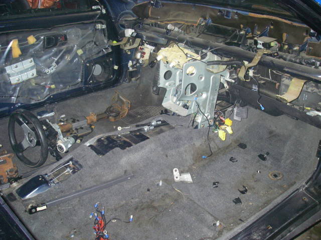

Finally said screw it, pulled the rear interior plastics and my "racing" carpet out for another 12-15lbs. I can't say for sure as my bathroom scale has gone from being consistent to reading different every time you step on the scale. Yesterday every time I stepped on it, it would read the same, now it's 1lb. different every time! Probably from overusing it! I also got a bit more of the crash beam out for about 2lbs. So it's real close to that 100lbs off goal. Those plastics/carpet will go back in for street driving though.

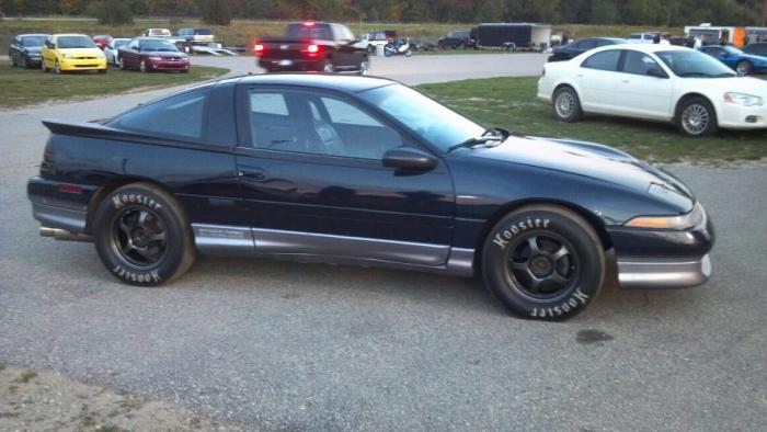

09-28-12 US-131 Motorsports Park Drag Strip
Just to update the log, some info is copy and pasted. Paul Volk loaned me his 26" Hoosier QTP's mounted on Motegi Traklites for a couple passes.
No changes were made to the car other then the wheels/tires from my 11.812 @ 115.69 from two nights ago. That pass was on 16" stock gst wheels and Toyo Proxes 4's in 225x50x16.
I was nervous as all get out for the first pass. I'd never launched on slicks and wasn't sure what to expect. Pressures were at 12 psi rear and 12.5 fronts, we had planned on starting with them higher but that's what they were set at and I wasn't chasing down an air compressor. I raised my launch rpm to 5500 and got in the lanes.
11.572 @ 116.12
1.609 60'
7.363 @ 92.72 1/8th
I was so excited, I laughed my way all the way back to my parking spot! I knew that was good enough for #5 on the 14b list w/out nitrous! Two more passes. One at 5250rpm launch...

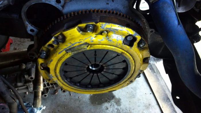

Some progress being accomplished. The trans has been pulled and the clutch inspected, the pp looks ok so most likely a 4 puck disc will be going in to replace the old street disc. I also started on losing some more weight, found nearly 10 lbs in the dash to remove, and I tore down the dash and interior chassis harness along with some other plastics and removed another 10 lbs. I re-installed the harness yesterday and here's hoping everything works once the battery is back in :D

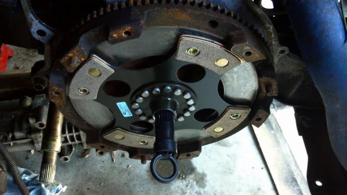

So after getting all the parts to swap in a 4 puck clutch disc for the 2600 and spending a couple days searching for my clutch alignment tool I ended up having to order one knowing the minute I did I would find the old one. So finally got the tool in along with a few extra goodies.
Got the four puck stuck on there for a photo op.
Then got it all bolted up to spec. While retrieving my torque wrench I of course found my old clutch alignment tool.

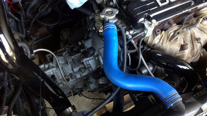

And started the process of getting the car put back together.
I should be able to get back at it Friday. Just have to get the axles stuck in and suspension bolted back up, fill the trans with fluid, oil change, few wires that need to be attached, bleed the clutch, and throw the battery back in. Should be interesting trying out the four puck for the first time.
