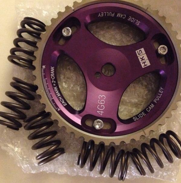

Complete Evo 8 head
-hks cam gears
-gsc valve springs and retainers
- gsc s2 cam gears (in progress)

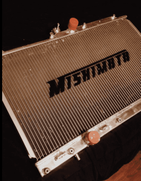

mishimoto evo 8 radiator
