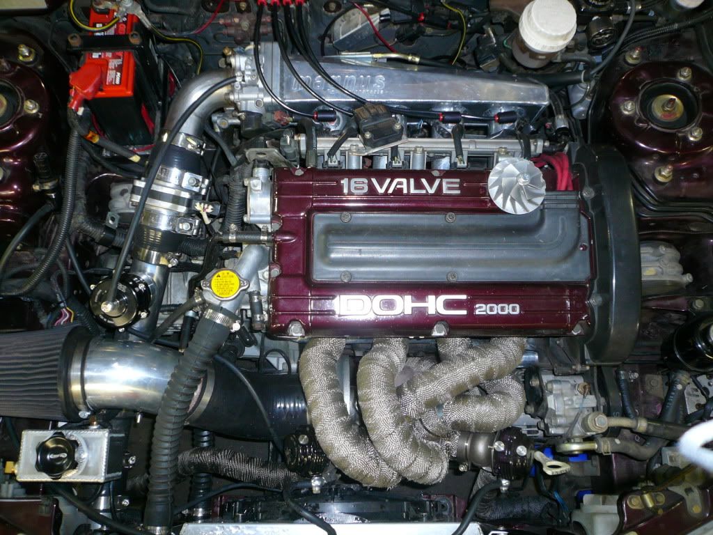

from my understanding of their kit, which I just purchased, all you need is two 2.5-3" ruducer couplers with clamps. I think you have to trim the upper intercooler pipe a little to make room for the GM maf and couplers but other than that it should be pretty easy. The only problem I have with trimming the UICP is I dont know of anyone locally that can re-bead the pipe after cutting it but they sell their kits this way to keep the cost down and I like that
*edit*
Found this pic. Its not the throttle body elbow that comes with the kit but you can see that you wont need any angled couplers for your GM maf.

I thought so and it made more sense after I saw this pic,
but god help this person with there messy engine bay.

Yeah, that would be a very difficult engine to work on lol!

that is a better pic, glad to see the magnus works with the setup too.
