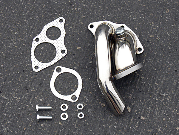

Anyone have a picture of what the o2 housing looks like? Whenever i hear o2 housing i just think of the o2 sensor.

The o2 housing...is where the o2 sensor is plugged in at. It is plain as day to see when the hood is opened. It is on the exhaust side of the turbo. The tube between the turbo and downpipe.
See the oil dipstick, the o2 housing is right there to the left of it. (This is a pic of a 1st gen btw).
To keep yourself from having to re-purchase parts, you need to have a plan of what you want your final product to be. It's not a good idea to just piece some parts togethor if you don't even know what the goals are.
I've really been debating whether or not to say this and I will probably sound like a jerk and I am truly sorry about it. I just really want to help you.
If questions like this are being asked, in my honest opinion, you should hold off on buying parts until you have a better grasp on what the parts functions are.
The stock o2 housing is very constrictive because of its small diameter. The flange that comes off of the stock o2 housing is only so big and therefore only certain downpipes can be bolted up to it. Different o2 housings will allow for differnt sized downpipes to be bolted up. The evoIII o2 housing is a good choice that will also allow for larger downpipes.

internal dump-
Image Hosted by UploadHouse.com
enternal dump-

just google it...and look at the images

Thanks! I've seen that before. Now im certain what it is. So i get the downpipe that fits the o2 housing. Also on this vfaq site Visual Frequently Answered Questions - Home Page and click "turbo" then click "14b-16g swap" it says nothing about replacing the stock o2 housing. So im guessing to go ahead and just get the downpipe since the stock o2 housing is never messed with or replaced but only recomended to replace the gasket. Any other thoughts on that?

Oh yeah check this out! DSM EVO III o2 Housing#-#1G DSM o2 Housings#-#1G 90-94#-#Exhaust#-#DSMparts.com that is the housing ill most likely buy. That is my favorite DSM parts website along with MachV Motorsports. Does the regular 2g performance downpipe bolt right up to it? Thats my only concern.

So i DO need a downpipe SPECIFICALY [SP] for the EVO III O2 housing?

Ok obviously i need to read more. It states in the description of the EVO III housing that SOME downpipes require minor modifications. So i guess Ill just get a downpipe and hope i get lucky. If not do some adjusting. Thats all there is that i can do i guess. With the EVO III housing. But like PBOGLIO i could port my stock O2 housing, but i know absolutley nobody that can port stuff. If i did i would have already had my manifold ported. Anyone know any local shops that do port jobs?
If you want to save some cash you could go out to Lowes, Big Lots, Home Depot or Harbor Freight Tools and pick up a corded dremel and some carbide tips and just go to friggen town. Or you could send your parts to a company like slowboy or something and I think they pffer some porting services.

Gonna need more than a dremel to port the exhaust side. I'd recommend an electric heavy duty die grinder.
Hmmm i dont think either of those are my favorite of ideas. Not saying there no good. I just dont think porting anything myself is going to turn out the best and sending it out would have my care immobile and i need to drive to work to make money to pay for this stuff haha. Soooo anybody else have any ideas on any places for port jobs? Specifically in the central GA region? Well to get back on the subject, im most likely going to go with and ebay tubular one or the evo III. Any body have and experience with either one they could give out some opinions on?
Just incase i do decide to go mad scientist on this one how much does one of those cost and where can i get it?
