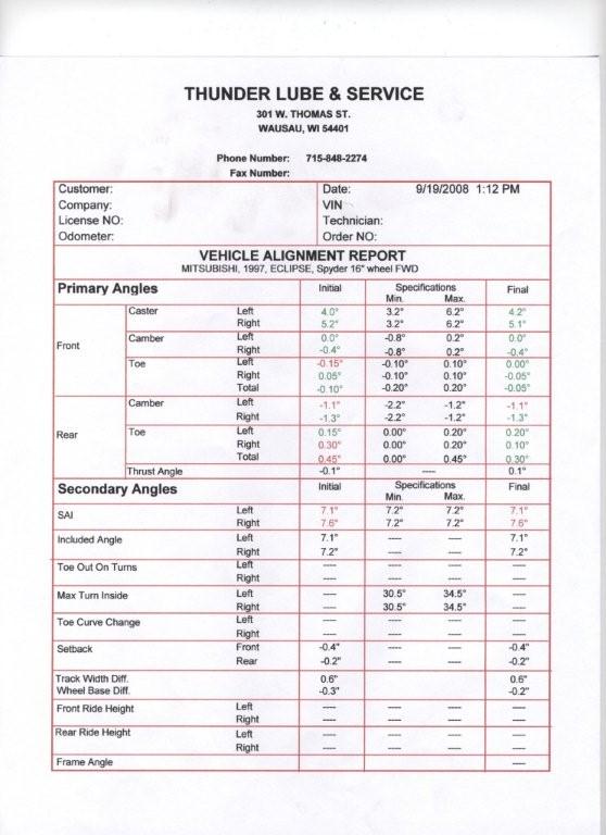

Alignment Worksheet
The car seems better but I haven't had a chance to try it out extensively. He said that there is no adjustment for camber so he couldn't do anything to fix it for me.

Yea, he can't adjust camber without either installing a kit or an adjustable upper ball joint. Camber looks ok though.

Does anyone know what SAI stand for because that is slightly out of spec too.
I've been looking at camber kits (well just RRE) but the only one I've found is for around -2 degrees and I only need a little, anything else I could get to make things come back into line better?

SAL means steering axis inclination. If it is not at factory specs,you might have stut tower in at top and spindle or stut bent.
