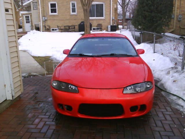

Just wondering why the front bumper is different in the last photo than all the rest?

Yeah, the previous owner put it on and just rattle canned it red so it doesnt exactly match. He included a primed ebay aftermarket 97+ but I think I'm going to hold out for an oem from a red part out. I bought some 2gb side skirts the other day, and they're already the same color. Once I get the high rise wing and rear bumper I should be all set. Just going for a clean stock(ish) look from the outside. I'm going to get it painted when I'm done with the motor.
