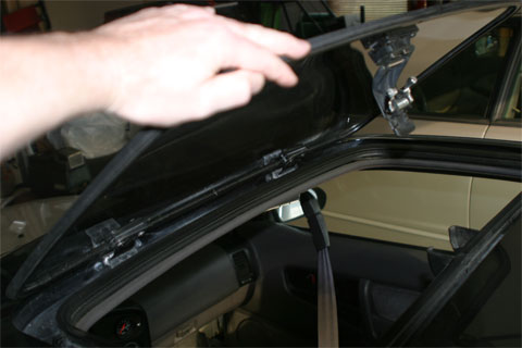

I took these a while back and intended to resize and post them since many people don't have the owners manual.
This is the factory stock sunroof.
Ignore the droopy headliner. I haven't gotten around to fixing it yet.

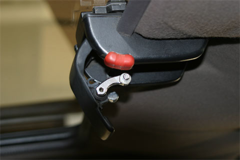

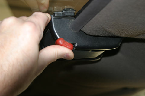

Pull the sunroof handle down to release the tension then push the red button forward and up and hold it. (I haven't released the latch yet in this picture)

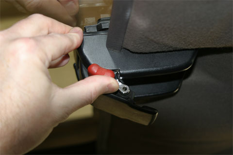

With you other hand squeeze the two silver armed latches together (one is spring loaded) to clear the housing to get it to come out.
Since I need one hand for the camera you don't get to see that..
Latch is now free.
This is where you squeeze this part when taking it out or putting it back in the mount

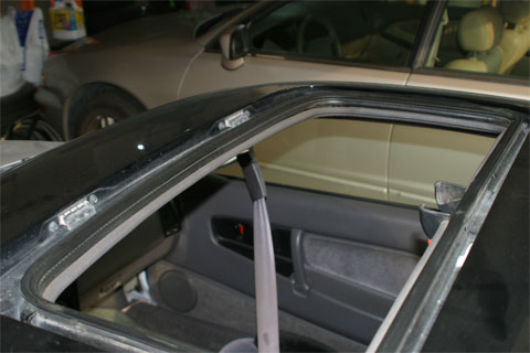

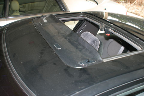

Lift up the glass and it will come out.
A better view of the fitting up front where both the glass roof and the air deflector fit.
The sunroof and deflector tabs are curved to fix in and you have to rase or lower then as you put them in the fittings or then will bind.

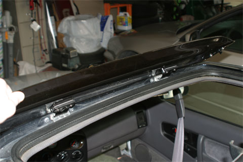

You can just see the catch on the passenger side the holds the deflector down on the right hand lower side of the deflector. There is a matching hook on the drivers side.
The last picture shows both releases to remove it.
