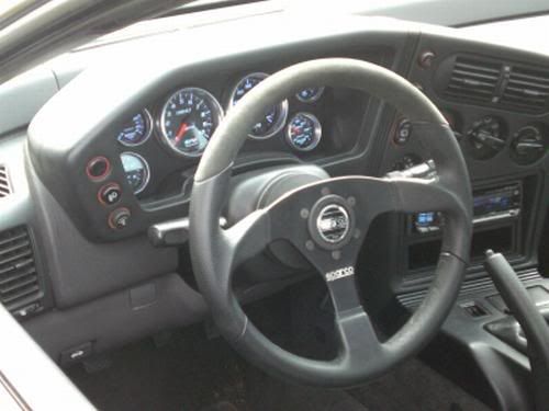

Yes. My friend did this in his 93 when I built him a cluster. He used a 2g sensor, found a pig tail, figured the wiring and used AutoMeter cobalt gauges. The autometer uses a calibration method to set the mph. I believe you'll be looking for a manual speedo sensor as the auto has a longer shaft.
You are my new best friend. This is phenomenal .
My sole reason behind this is that Im building a rear engine car and i need the wires to reach back far enough.... using the mechanical wire will prove to be impossible seeing as the cable is maybe a yard long from the tranny to the back of the dash.

Sounds cool. The cluster I did was super simple. Just an old cluster cut up. A piece of plexi cut/sanded to fit over the old. Cut the holes and epoxied to the shell so it could be bolted in.
I also attached a page from my shop manual for wiring. Hopefully you can read it, if not PM me and I'll see if I can blow it up for wiring colors and pin positions. My scanner wasn't too clear.
