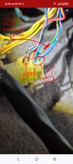

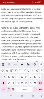

    If the weather by you around 80f 3.5k ohms should be fine. Also we verified that you Thermo fin goes into your black box and is not damaged.Now we need to verify power going in and out of your black box. Follow this preview steps. I labeled...

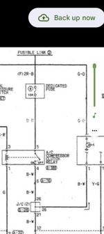

    All the wiring looks factory. Can you take a clear pic of the black box with connectors going in?. Those yellow wires are for your thermo and compressor temp switch, we will need to check resistance to see if they go through and make circuit, I...
