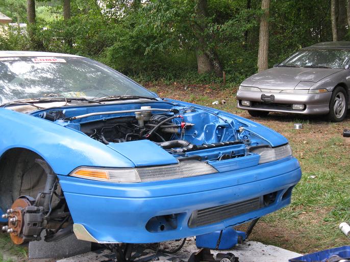

My manifold came finally. Bolted it up

Looks really good

That looks good. Are you going to be able to run puller fans or do you have to switch to a pusher style?

Boostedtalon2, your stuff looks awesome. What rad. you are going to use? Good luck and keep us posted.

Quote:
I'm going to be using an aluminum Honda radiator.
