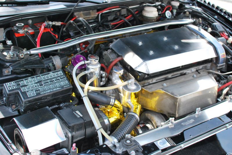

I'm very honored to have been selected to participate and see what I can do wtih the Eclipse I've been building! For those of you unfamiliar with my car here are a few pictures of what I'm bringing to the event:
The cruise control has since been yanked!
The car is putting out fairly decent horsepower with a Forced Performance FP3150 mated to my Magnus Motorsports 2.3l stroker, though possibly a bit less than the field but it will have to do for now! I've also got Andrew Brilliant's aero package in tandem with a DHP Composites wing, and some 285 tires, so I hope to put up some decent times. By the event Tim Zimmer of TMZ Performance is hoping to deliver to me one of his Stage 4 transmissions with a Quaiffe ATB front diff and 4-spider center, as well as a custom rear diff with Evo 8 internals with the Weir Performance 12-disc MAXGRIP modification. The car isn't in its final form as there is still more to come this winter, but I think I should suprise a few of the other cars and kick a little ass :)
