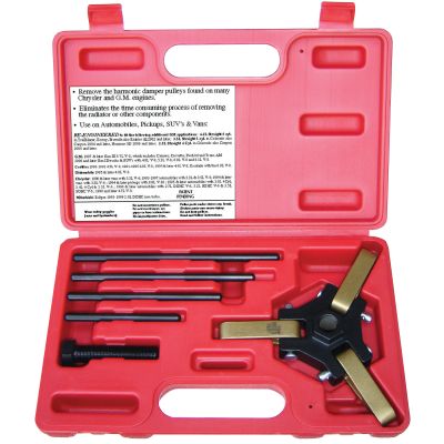

Things needed.... Please do not feel insulted by my wording/phases. I just like to make my point across the first time. :thumb:
1. Depending if you have an aftermarket harmonic pulley or not, would be your problem.
2. If you have a stock harmonic pulley, then you NEED this puller only.
3. If you have an aftermarket harmonic pulley, then you will need either from the 2 below...
or
some heat, but not really needed. If you still are having trouble, then you have other problems...
That top pulley puller is the same one we use it's designed for Chrysler vehicles and works great... But the secondary pulley will still work... Been there done that LOL.
