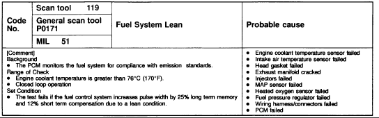

Perhaps this will help..

This may help.
