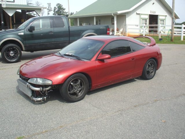

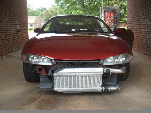

300+WHP build on a 1998 GS Turbo'd 420a
My 1998 Eclipse GS Turbo BUDGET BUILD
Goal= 300+ whp on a 420a
Car was purchased for $1700 on 05/26/12
Pictures upon retrieval and decent wash:

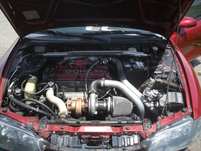

Engine Bay:

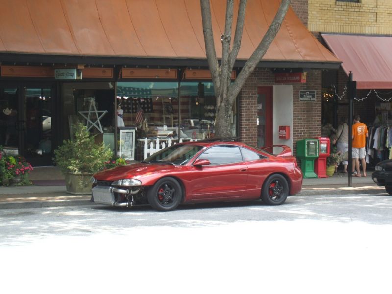

Front:

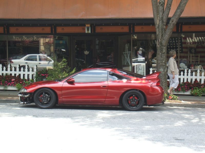

Side:

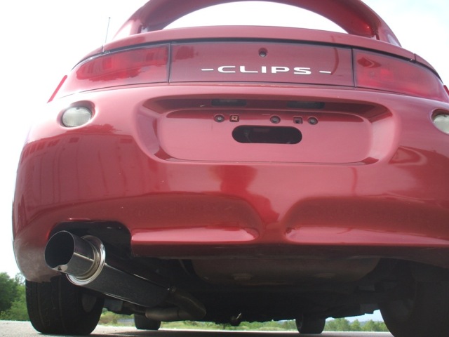

Rear:

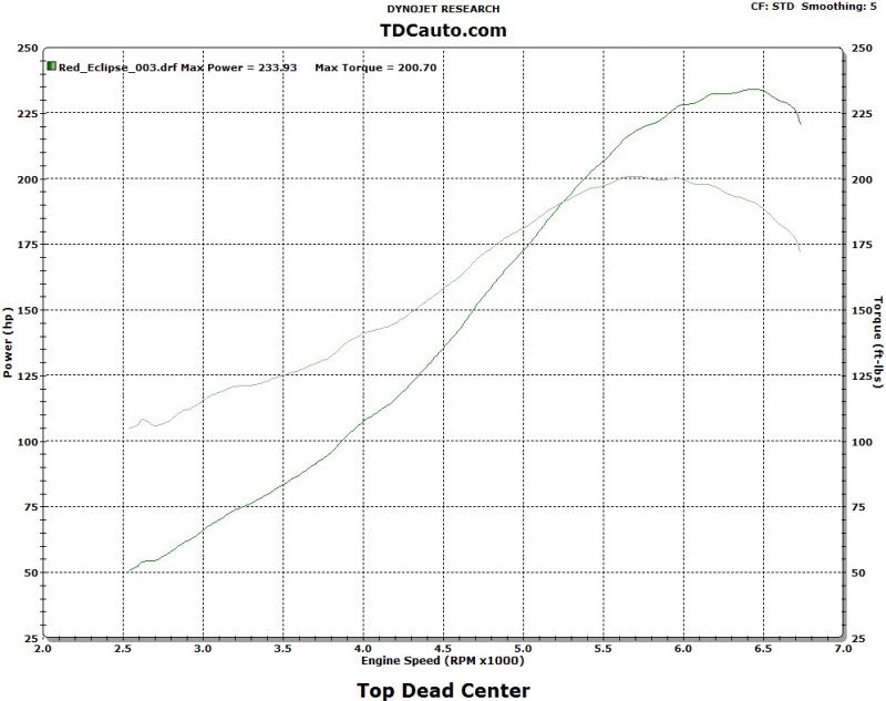

Dyno On 5psi:
and link to CLEMSON SCC's review for haters http://www.clemsonscc.org/post-138663.html
420a Engine
Eagle Rods
JE 8.8:1 Pistons
Cometic Head Gasket
ARP Head Studs
DSM 450cc Injectors
Walbro 255 LPH Fuel Pump
Aeromotive Regulator
Hahn Racecraft Turbo Kit
Hahn 16g Turbo @ 5psi
I picked it up in spartanburg... These people had no clue how to work on it. They had no clue it was running on megasquirt standalone. I found it underneath the passenger floor mat, I was like is this... a rangom box with a SH!T Ton of wires running through the firewall. Sounds safe to have bouncer around where people kick. I mounted it in the passengers to where it looks pretty sweet with the three leds strobing and is out of the way of feet!
The car ran ok.... but this was my first turbo car so I didnt know what to expect. I end up figuring out to use megatune and get the car tuned as is. So I start driving it thinking that was all it had. I was in for a suprise... (at the time only spooling to 7-8psi on a good run), I did enough research and checked my wastegate arm, it was unhooked from the wastegate acuator rod. Therefore, the flapper was staying open and building no boost.
So I attached it and now the wastegate shutter is incredibly tight. Needless to say I fixed it at work and was like holy balls this thing is about to be quick. I pulled out in front of boss leaving for home and had no traction first, second, or third gear. It sounded like I was riding behind a jet engine.
Now I have a VOODOO MBC pushing about 15 pounds on the car, and getting mad power. I tune almost everydrive on tunerstudio and it only gets faster and smoother. I feel that I have a close to 300 WHP right now.

Damn man, looks nice. Did you spray the wheels? Or did they come that color?

They were sprayed i'm sure... and thanks man

Damn,That looks nice! Congrats on having such a beatiful 420a.

wheel combo on your car looks sick!
