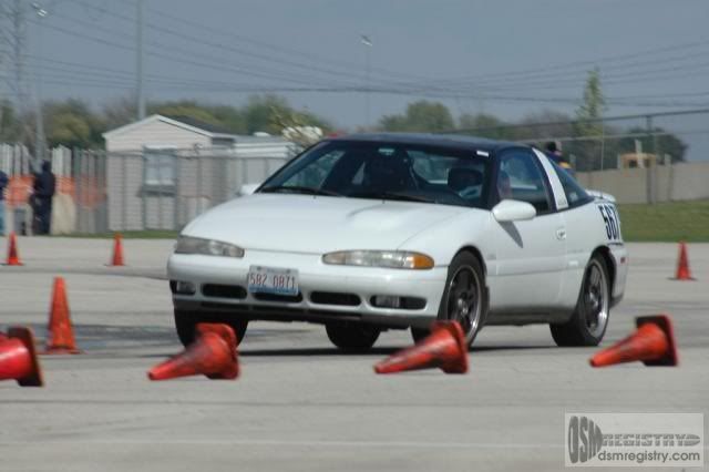

Onto my third dsm, second awd dsm, first 1g awd, etc etc... Its first one good enough to drive it all the way back to my house without any hiccups and be reliable enough to drive it without worries.
Story is, I joined the national guard, got back from basic training and ait, told myself I wouldn't get another dsm but I just couldn't resist, everything else I looked at just wasn't appealing to me, so I went looking for a 2g I could put all my parts in out of my rusty 2g, came up on a great deal on a laser and couldn't resist.
(pic stolen from p.o)
