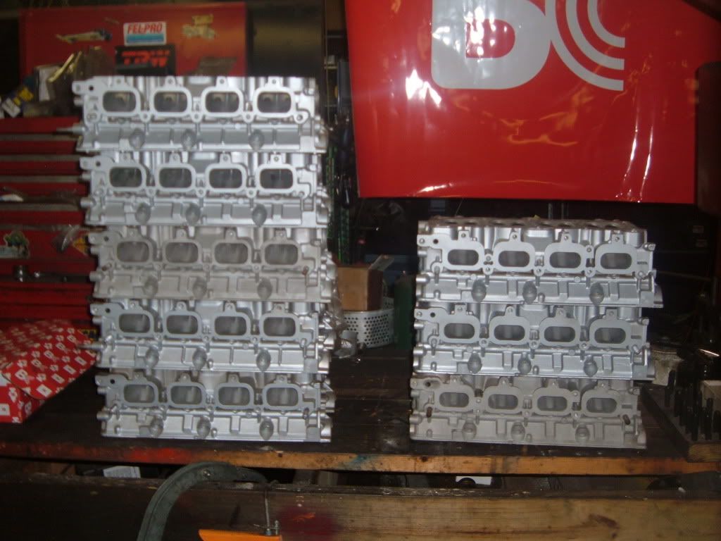

I am starting out with 8 heads.
5 are 1G 6 bolt and 3 are 2G 7 bolt
I think one may be a Hyundai head
Some of the heads have been through a machine shop before.
Some base information has been gathered.
The heads have been disassembled, thermal cleaned and glass beaded.
Most of the heads have the oil galley plugs removed.

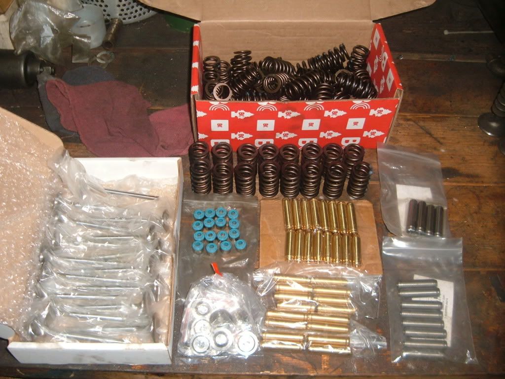

All heads will be fitted with +1mm oversized valves
7 Heads will have installed BC1100 valve springs
3 Heads will use BC Ti retainers.
Some heads will receive new seats and/or new guides
All heads will receive Vition valve stem seals
Oil port mod #1 will be done
http://www.dsmtuners.com/forums/newbie-forum/341028-4g63t-head-oil-port-mod.html

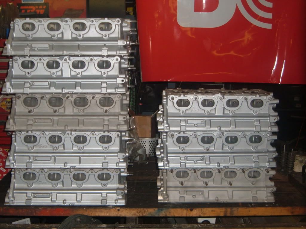

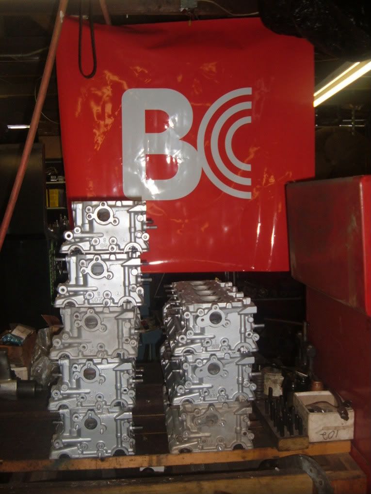

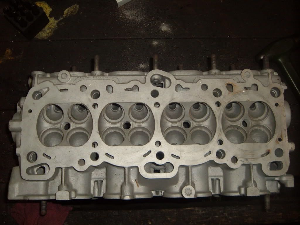

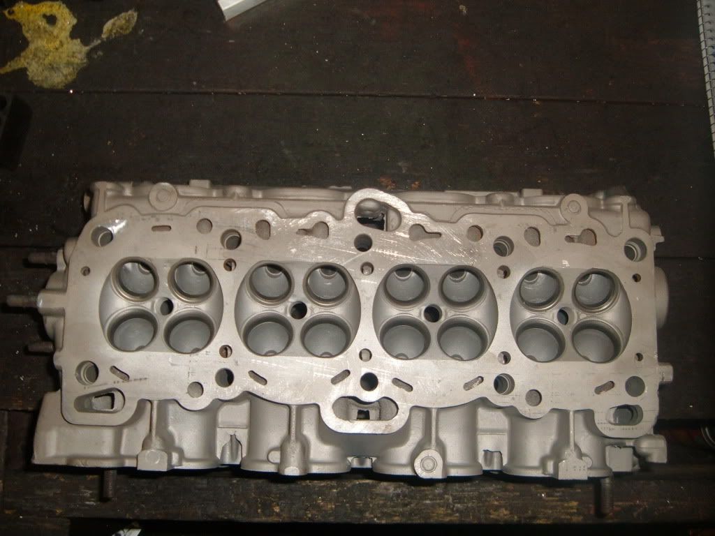

Front view
Exhaust side
Intake side
Thermostat side

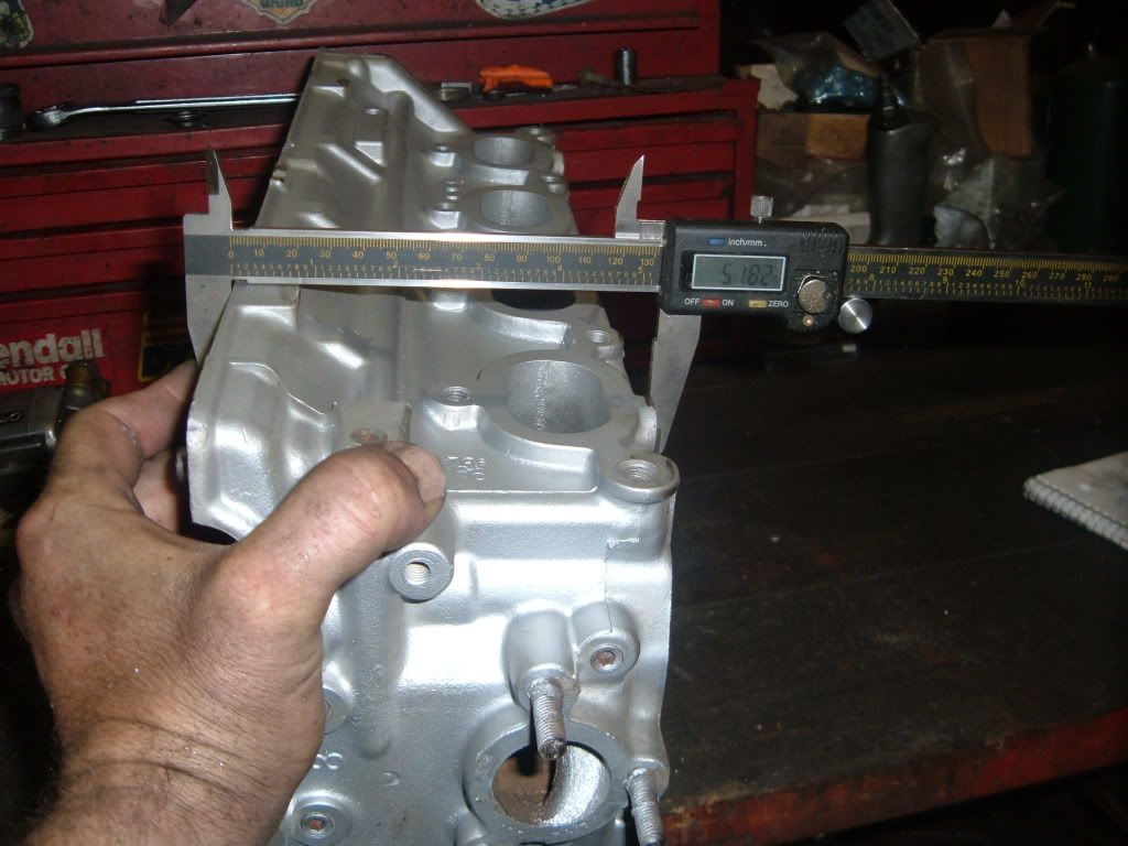

Measuring head thickness
http://www.dsmtuners.com/forums/cyl...how-measure-4g63-cylinder-head-thickness.html

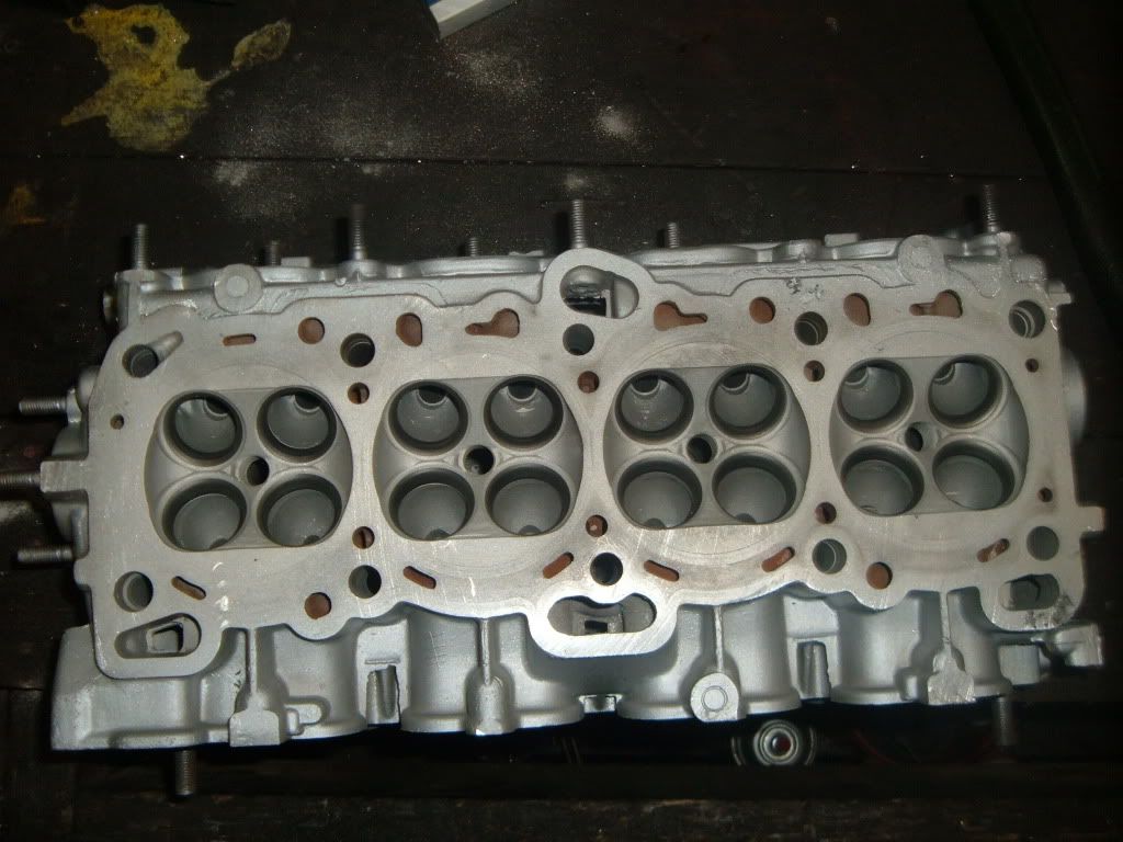

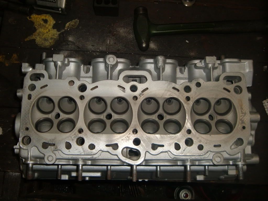

New head thickness is 5.200
AREA Min thickness is 5.185
Mitsu factory allows a combined total .007 milled from head and block
Head #914 (This number was stamped by another machine shop)
1G
head markings G6/8
10mm exhaust corner studs
Oil port mod has been done
(I-F) Intake-Front 5.191 (E-F) Exhaust-Front 5.187
(I-R) Intake-Rear 5.188 (E-R)Exhaust-Rear 5.182
Head #200 (This series of heads will start with 200 and count up)
1G
Head markings 2.0/8
8mm exhaust corner studs
Oil port mod NEEDS done
I-F 5.198 E-F 5.197
I-R 5.196 E-R 5.194

Some of the Parts I will use
