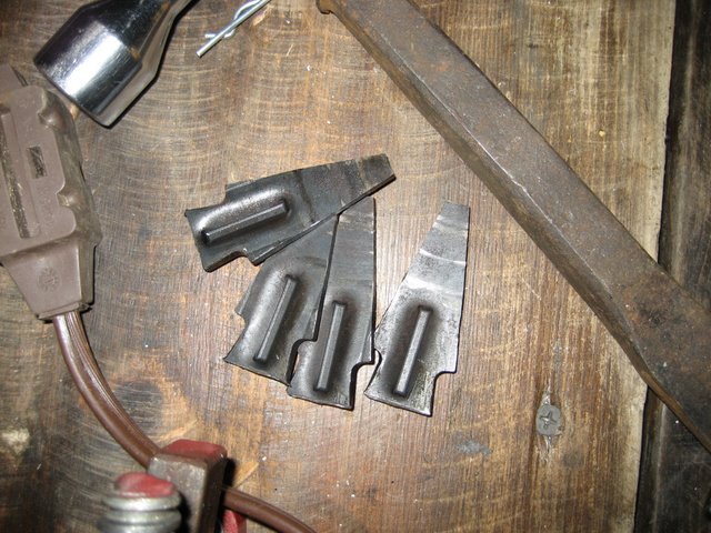

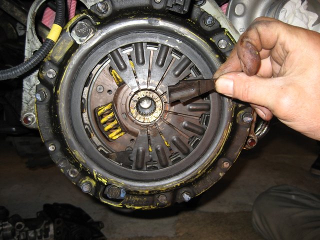

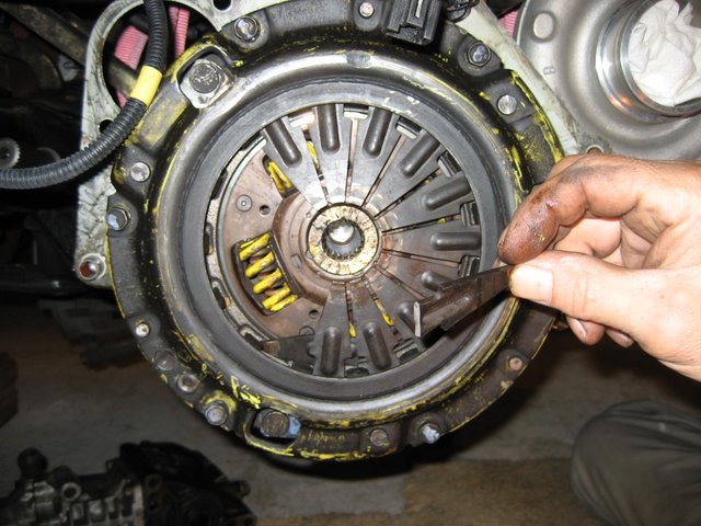

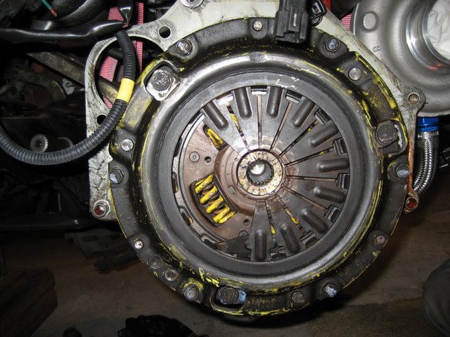

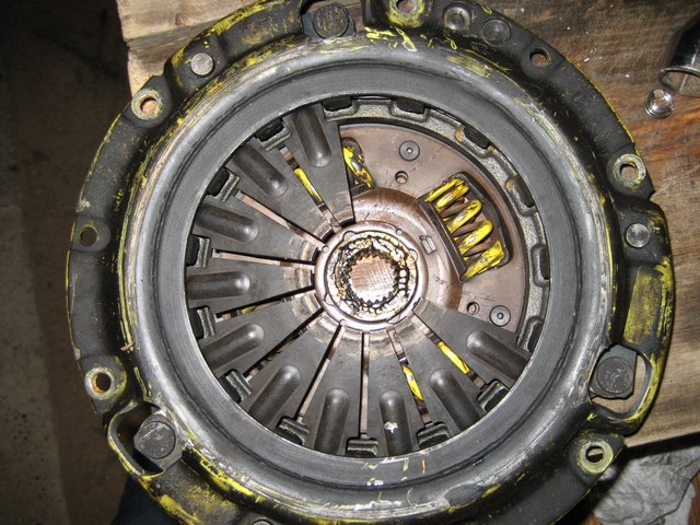

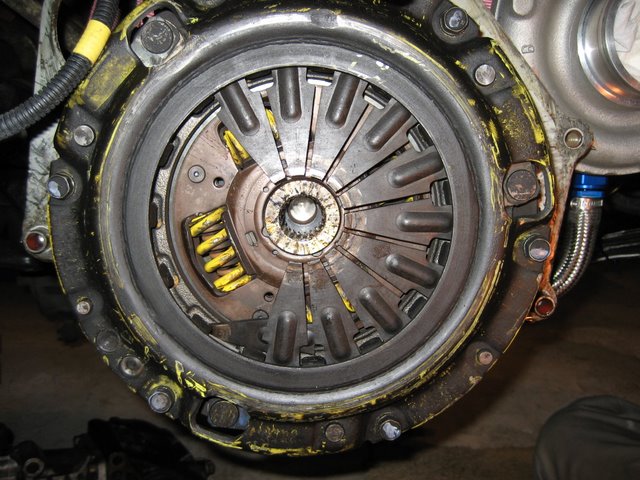

Hi all. My ACT 2600 just died. It broke a few spring.
I just wanted to know if ACT will cover this and replace the clutch?
If anyone has had experience dealing with ACT and their warranty process then please chime in.
Here are the pics:

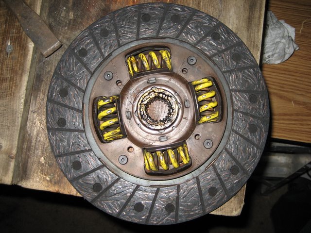

Ok, so I sent the clutch off to ACT. They replaced the PP and resurfaced the disc. I asked for the 2100 lb PP this time because my thrust bearings keep failing.

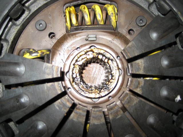

Examining the disc and broken fingers you can see that the fingers made contact with the disc springs (wearing out the yellow paint the the disc springs). This could have also lead to the thrust bearing failures.
So it looks like the failure was due to improper clutch adjustment. The Fork/TOB were traveling too far and made the PP fingers touch the spring.
To be honest, that was probably my bad and I'm surprised that ACT warrantied it. :D
