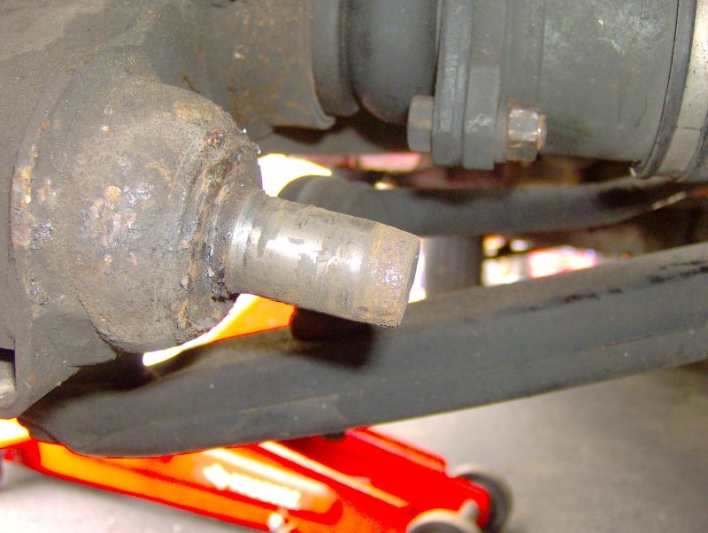

After successfully removing the rear shock and before installing the Konis, be sure to clean the lower mount seen here as much as possible. Use a wire brush and then apply antisieze/grease to it liberally. If you don't, you will have nightmares after you swear up a storm trying to get them off in the future.

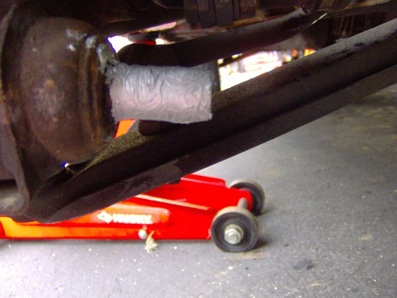

Antisiezed.

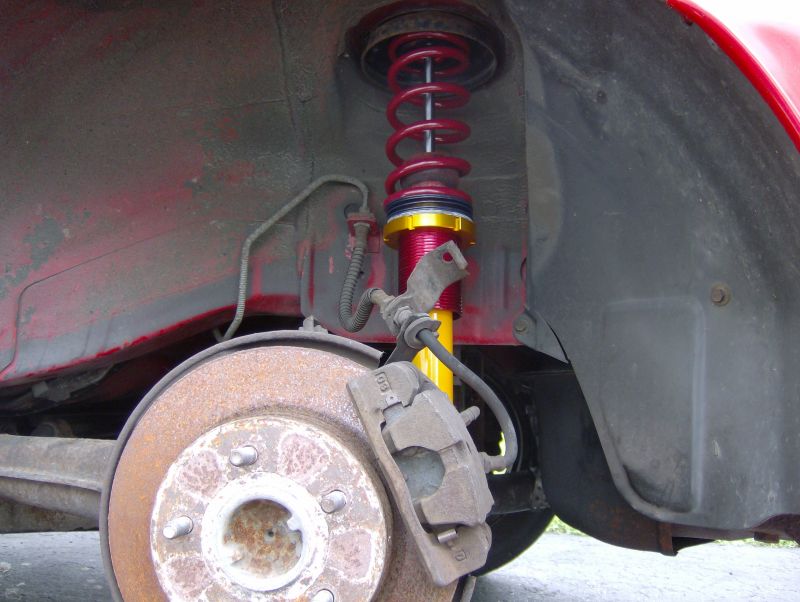

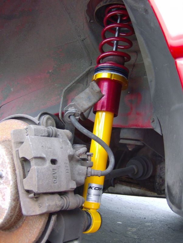

Here, they are installed. Fitment is as if they were made for it. The install is very straight forward.
To summarize, the 2g rear Koni shock bolts right up in a 1g AWD. What was needed?
- 2g rear Koni shocks
- Coilover kit
- stock 1g upper bushings and top hat
- stock bump stop (cut if you need to)
- grease for the lower mount
I can't comment on how they will work with lowering springs. The Koni shocks, however, do come with a lower spring perch.
