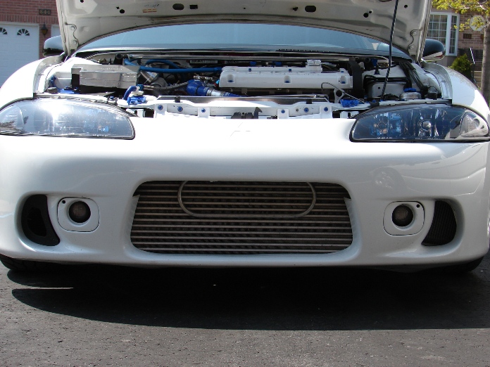

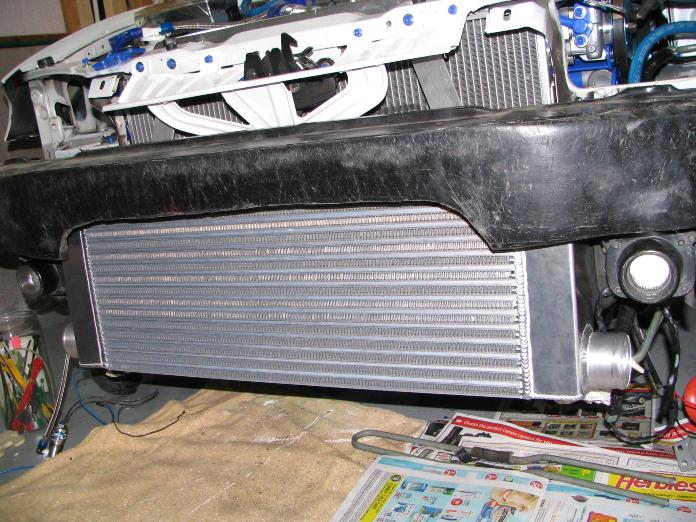

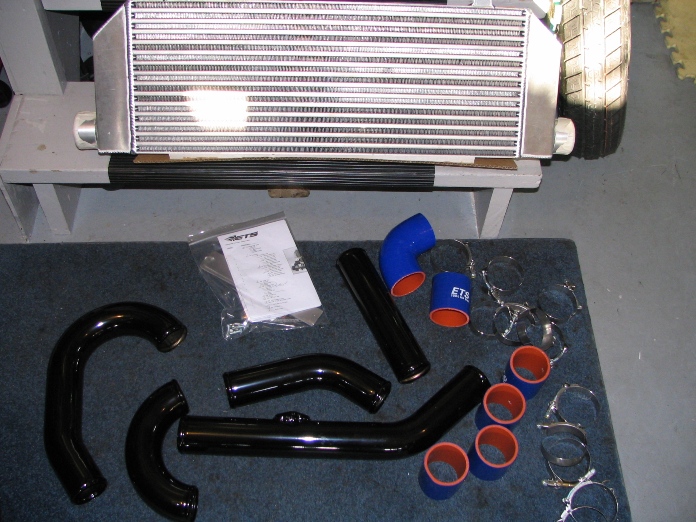

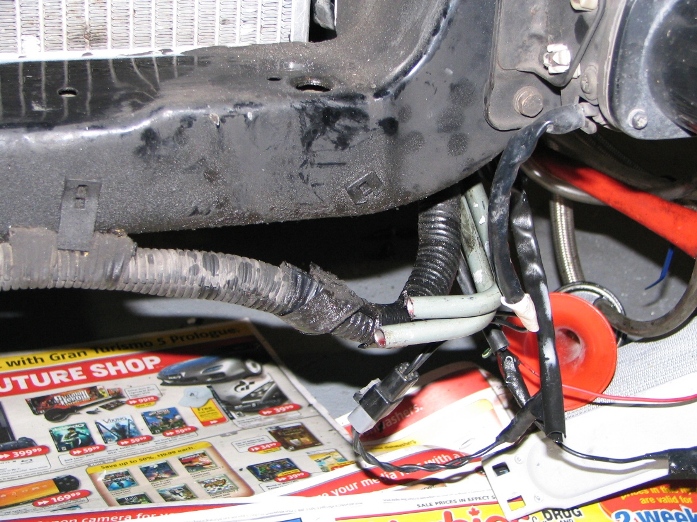

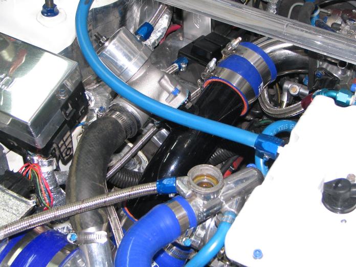

So after researching on what is the best I/C kit for the 2g cars I decided to get the ETS pro race kit for my talon. The kit arrived complete at my door in few days. After removing my bumper and my old I/C( big greddy) I have noticed that the bumper would need some more trimming as the core is 3.5inches thick as to 2.8 for the greddy. The oil cooler that I had on the car would have to be re-positioned and the power steering lines had to be cut and re-positioned. I also have the greddy type-R BOV so I had to make a custom flange higher on the I/C pipe. The kit came with a proper flange but it was in the wrong place for the typeR to fit(too tall). Everyting lined up good but as in all "custom" oversize parts you have to be creative to have a perfect fit. I still have to do some minor details. The BOV install turned out perfect as I had the flange positioned where the cruise contol was located, I was also able to route the return to the intake by using 1/2 of the lower rad hose(2g). Overall I was happy with the part and would recommend it for others to buy. So far I have done few logs and at 20psi 2000-7000 in 3rd on 3582hta. With few gal of 94oct and some leftover gas from last year I almost got no knock(2 counts)..
