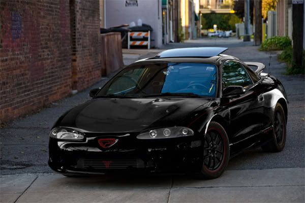

Guys I got lucky.... Found the Twisty skirts, taillights, and low thumbnail spoiler on craigslist and picked them all up for $50 today!!! Now I just need the bumpers. Only thing is, the skirts didnt have the cups or the door pieces, just the two long twisty pieces with "16v dohc turbo" engraved in them
Oh and this is how it will look (I changed my mind on doing a Panda)
I had gofer draw this up for me.

Copycat. :p This is very similar to how mine does/will look when finished. My emblem will look the same, and the lettering on the skirts will be red like that. Mine has the strakes though.
