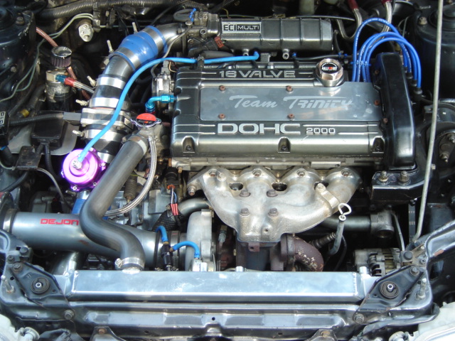

I just finished the 2nd day of building my talon for the last time.
I'm almost done, should be done by the weekend for sure...then the breakin, after 500 miles, the gt30 will be bolted on and then after a total of 1000 engine miles, the car will be strapped on the dyno....updates on the build soon to come.
WHAT the F is that over your cam gears? Good job on the build, let us know how smooth the break in and initial problems went I always love those storys.
That would be my little experiment...I wanted something to be able to show off the cam gears and also protect it from anything going inside. Its not perfect, but for being the first time I do something like that, its not that bad.
Don't worry, I will bet I will have plenty of stories once my car turns on.
It looks go so far but let me offer some advice. Relocate the coils and move the fpr to were the coils are at. It will clean up the bay and make it look less cluttered.
that's the only place I could make my afpr fit...the line is not that long that's why the afpr is sticking out from the firewall and not bolted on to it...thanks.
Today is going to be day 3...hopefully its done today!
