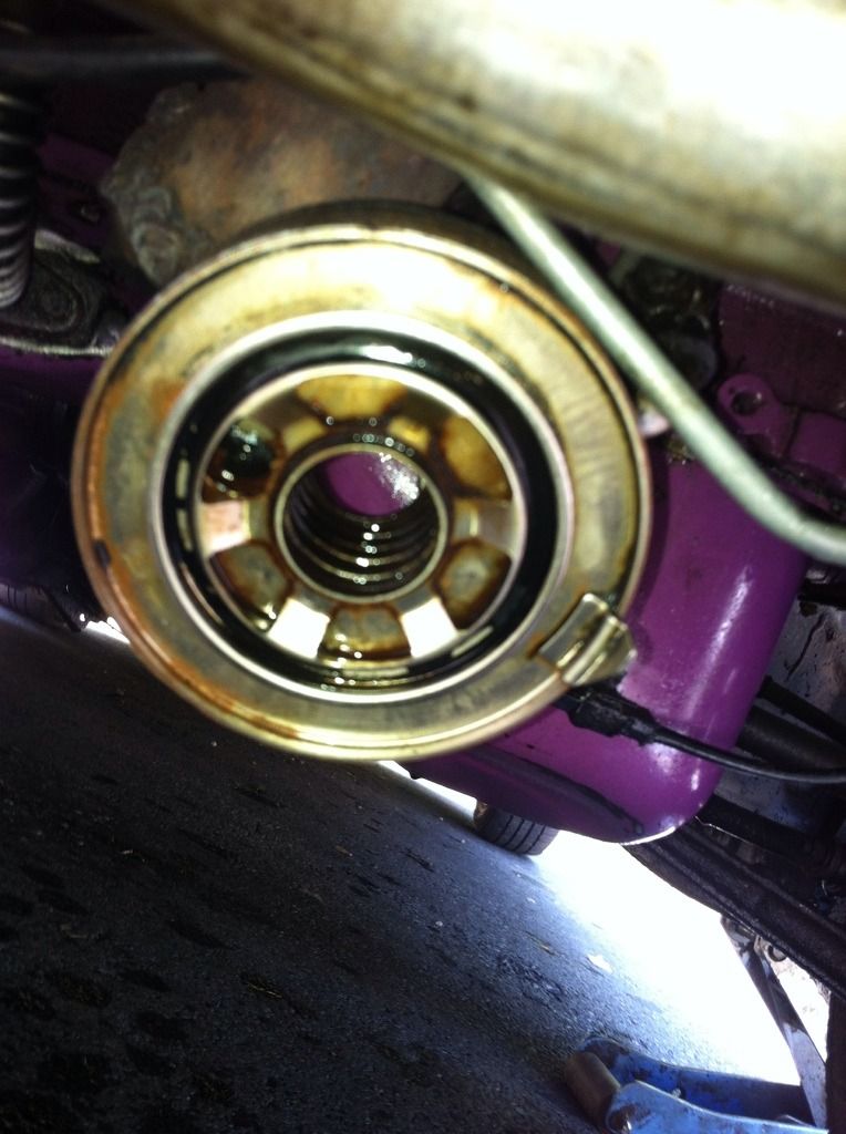

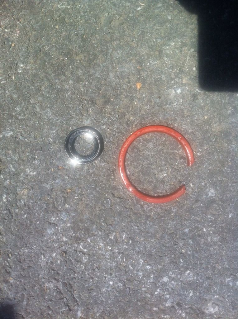

Do you see it now? Lmao. Orange seal is what came off. Got the wrong seal. Old one is obviously ripped.

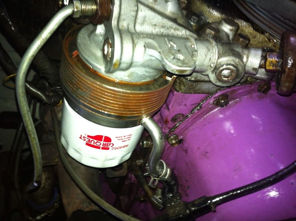

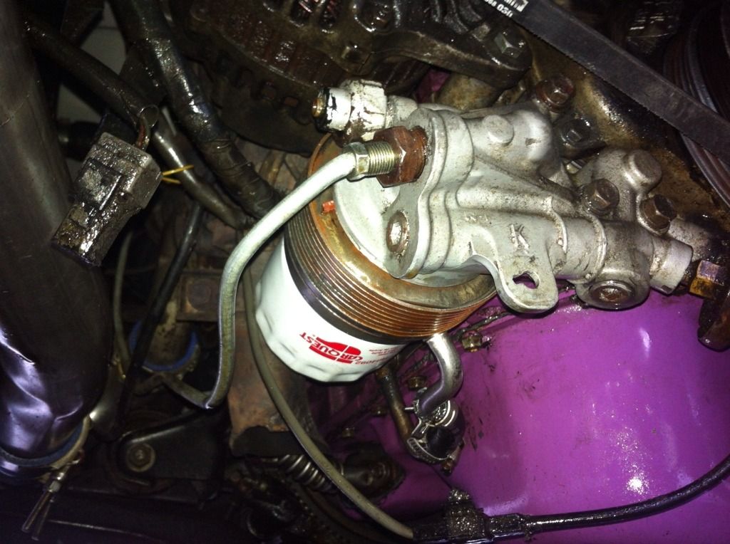

So I took the ofh off.
Clearly, it is torn and this is where the leak was coming from. The seal is a dealer item so it could not be bought from a parts store. I ended up re-using the seal and siliconed the shit out of it. The leak was fixed.
Pain in the ass, but she doesn't lose any oil anymore.
