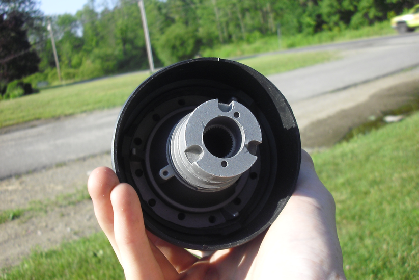

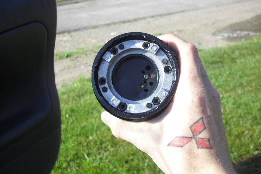

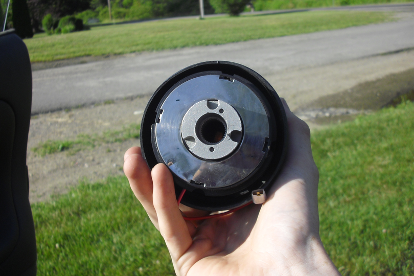

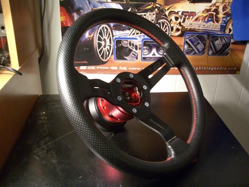

Here are some pics of the wheel and the hub.
Brand of wheel is "Nardi".
There are 6 bolts like some of you have mentioned.
Hope this helps you determine whether or not it will work.
Front of wheel
Back of wheel
Found this pic online. I THINK it's the same wheel. EDIT- No it is not.
Box that the Hub is in.
Pics of hub and quick release.

The steering wheel will work, but I don't know about that hub, if I was you I would just invest in a NRG quick release instead of using the hub in your picture...

The hub in that picture wont work ive bought 2 of the $10 ones on ebay (the one pictured) and both times the splines were too small. The steering wheel is also not a narni its a cheap $15 wheel off ebay, i have the same one, i picked up at a junkyard for 4 bucks, and comparing that to my friends NRG it feels like a plastic toy. Id buy everything NRG if you want quality for a decent price
