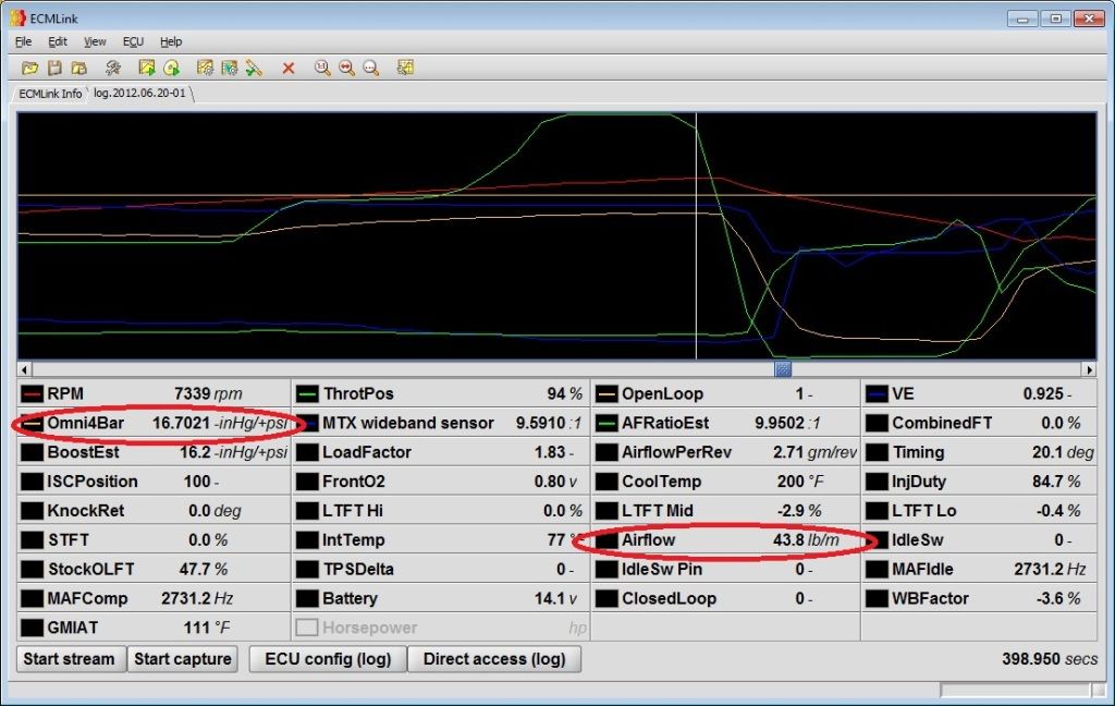

I have one of the 3" inlet TD06SL2 20g's you built that has the billet 20g wheel. I ran out of fuel right away and had some other issue when I first installed it but I've changed injectors and fixed the other issues and now finally, yesterday I made a clean pull with this turbo.
Now this is only at wastegate pressure of 17psi and the MAP and BoostEst are very close so the flow number of 43.8 lb/m should be pretty accurate.
Those PTE 880's are already at 84% DC on 91 pump but I'm also running very rich at the moment so that will probably be fine. I do like the way things are looking so far. I can't wait to tune it more and start turning up the boost. I'm very curious as to what flow numbers I'll be seeing at something like 22psi. This thing is going to freakin' rip.
