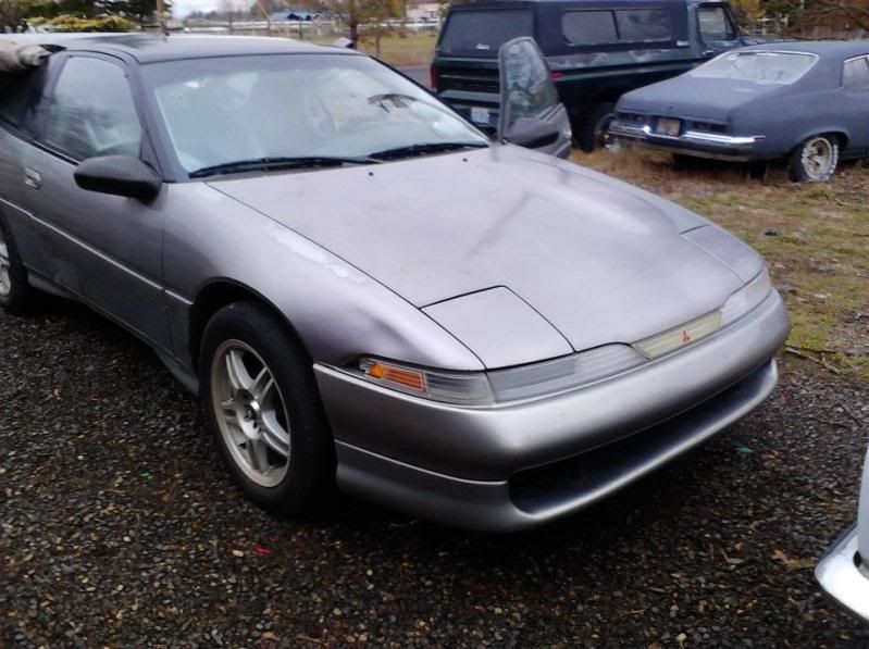

So what I started with
Another reason for this was my fender was dented from an idiot deer
Off to the shop

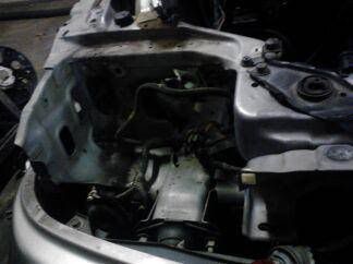

Now the big thing that seems to be missing when you search for this conversion.... WHATS DIFFERENT UNDERNEATH- Well here ya go
You'll find out what you need to do real quick.... make room for the new headlights to sink in deep enough. Heres what it needs to look like

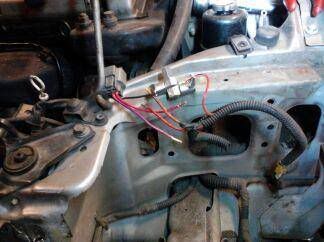

You need to solder in the new harnesses. As far as colors go, on your 1Gb harnesses they were thinking and made the black the ground, on 1Ga they did not, it was one of the reds :ohdamn: Get out your test light and find which one, and dont pop fuses just use your head and connect your test light to positive, and when it lights up from one of the wires thats your ground wire.
Heres what youll have cut out when youre done
