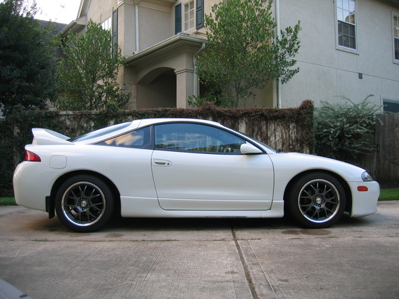

For the OP, here's a pic of the H&R OE springs with stock sized tires (215/50/17)
<img src="http://www.dsmtuners.com/gallery/files/4/6/0/3/Skye3.jpg" alt="Skye3" />
