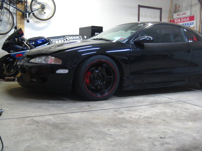

FN01RC 17x8 35 or 40 mm offset, I can't remember. No spacers. 225-45 tires.

thank you Detail, just checking, is there any problems , rubbing at all?, i think im going with the FN01RC, 42mm offset and 225 tires,

no rubbing at all, in fact the tire lines up directly with the fendor. looks great. I'm only on a 225 though. i could prob go 245 before having problems.
