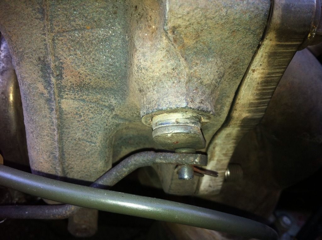

Try gauging where the WG flapper is right now then take the arm of the wastegate and manually move the flapper to c how far it goes until its completely shut. Sounds like to me the WG isnt fully sealing
Will do, but IMO, the chances of two different WG's on two different turbos having the same exact problem is slim to none.
It does sound like a WG problem though. So I checked it. Pulled the pin out, and it moves back and forth as it should.

Ok so get this guys. I zip tied the vacuum line for the WG so that it was kinked. I hit 12+ boost!? This means the actuator is bad??

Could be an issue, did you check the turbine housing for cracks through the wastegate hole? This could/would keep you from building boost, maybe possible with both turbo's but unlikely My guess is that the wastegate is fine, with it forced shut you should've hit 20+ psi easily, you simply forced everything you could through the system which obviously has a clog. . As said, check your downpipe/cat to see if they're clogged as that's a pretty good possibility. If all else fails unbolt your downpipe and go for a ride, after you put the wastegate stuff back to normal. Also check all your piping for a rag or anything you may have left behind in the system, it happens.
O I'm sure it could of went more I just told him to see if that would fix the issue. Don't wanna just jump on it an blow seals. Sounds like a old 14b wastegate to me that has loads of miles WOT on it. Swap it out. Simple task an u have a spare on hand.

Yea, with the line pinched I boosted 15psi, then hit fuel cut LOL. Swapping the WG actuator tomorrow.
