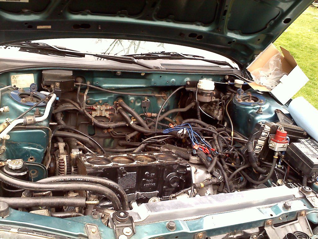

After buying 99' gs 420a with garrett 60trim.hahn port fueler. few more other things. i blew cylinder 3 piston right up. the 2nd day i had it. Apparently the "turbo" pistons he said were in it, were actually stock ones :banghead: my choices were to sell it or keep it...
i decided to order in wiseco pistons, eagle rods, had it bored .20 over. I luck ally finished the build before i left for camp woodward. My dad drove the car to break in the new pistons. 2 weeks later i had the car with me out in Pa

well 3 weeks ago decided to turn my boost up in the car and 15psi stretched out the head studs :ohdamn: 2nd time i had to pull the head off the car. this time ordered arp head studs. send the head out to be milled. poly motor mounts. new water pump
Now up here in North jersey there isn't any close Dsm by me. There is more stances out vw, audis up by me so its an influence on how my car is built. moved the battery to the trunk, also tucking some wires. Im still waiting on my Ic pipes to arrive so i can put everything back together. While working on the car i got my 6 month old husky and my 2 yr old lab that are with me, they help me a lot ROFL
I've built this bottom end. and a year later fixing my top end. I use this forum for everything and once i get my ic pipes in and my car is all together i will update with the specs and pics :thumb:

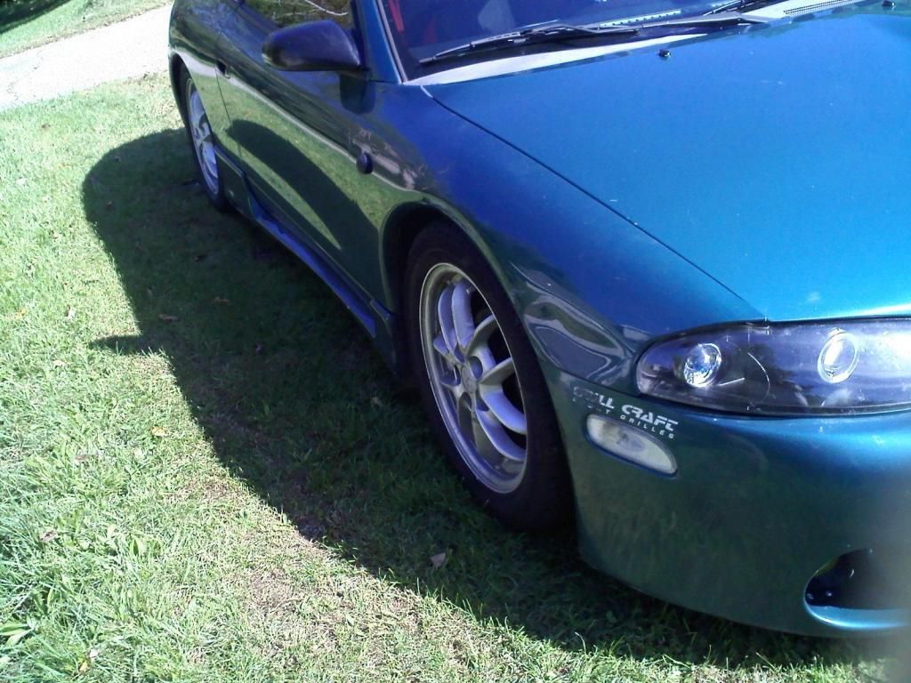

little update. build is finished. car is running amazing. i need to order up new gauges which I'm thinking about going pro sport gauges. I wanted to trade my tails that were after market for stock tails but no one wanted to trade around me so i did a little custom work, pulled them apart painted the inside red and red tint the outside lens. I'm fine with how it turned out! now on to the pics (still thinking to put something in the space on my bumper like a duct of some sort, keeps engine temps down though )
