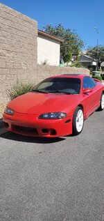

I have a 95 GSX and I almost always have to do 3 points making a U turn or cutting into the second lane over making a intersection u turns. I don't if it has original suspension, all I know is I got OEM springs.
