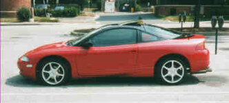

108000 Miles, and no Crank Walk to speak of....:thumb:
