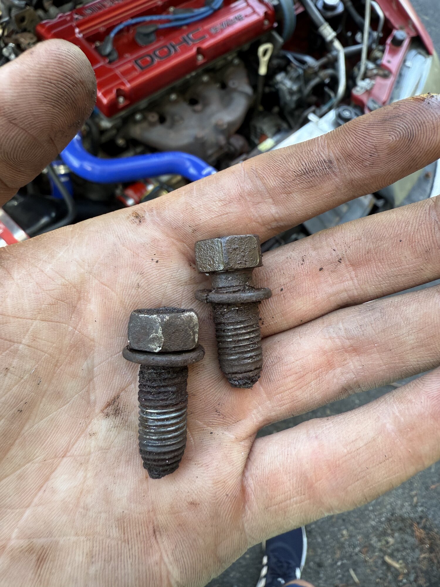

A bit of a quick day today. Got some new exhaust manifold studs and nuts installed to replace some rusty nuts and a bolt someone installed in place of a stud and nut on the manifold. All I have to do now is get the old exhaust manifold gasket off and replace it. I have a nasty exhaust leak on the edge where the water pump is. It sounds like an extremely loud lifter tick when I’m on the gas. When removing one of the nuts it cross threaded on the stud and I got extremely lucky. Instead of snapping the stud, it cross threaded and actually pulled the stud out which I guess makes it easier LOL.

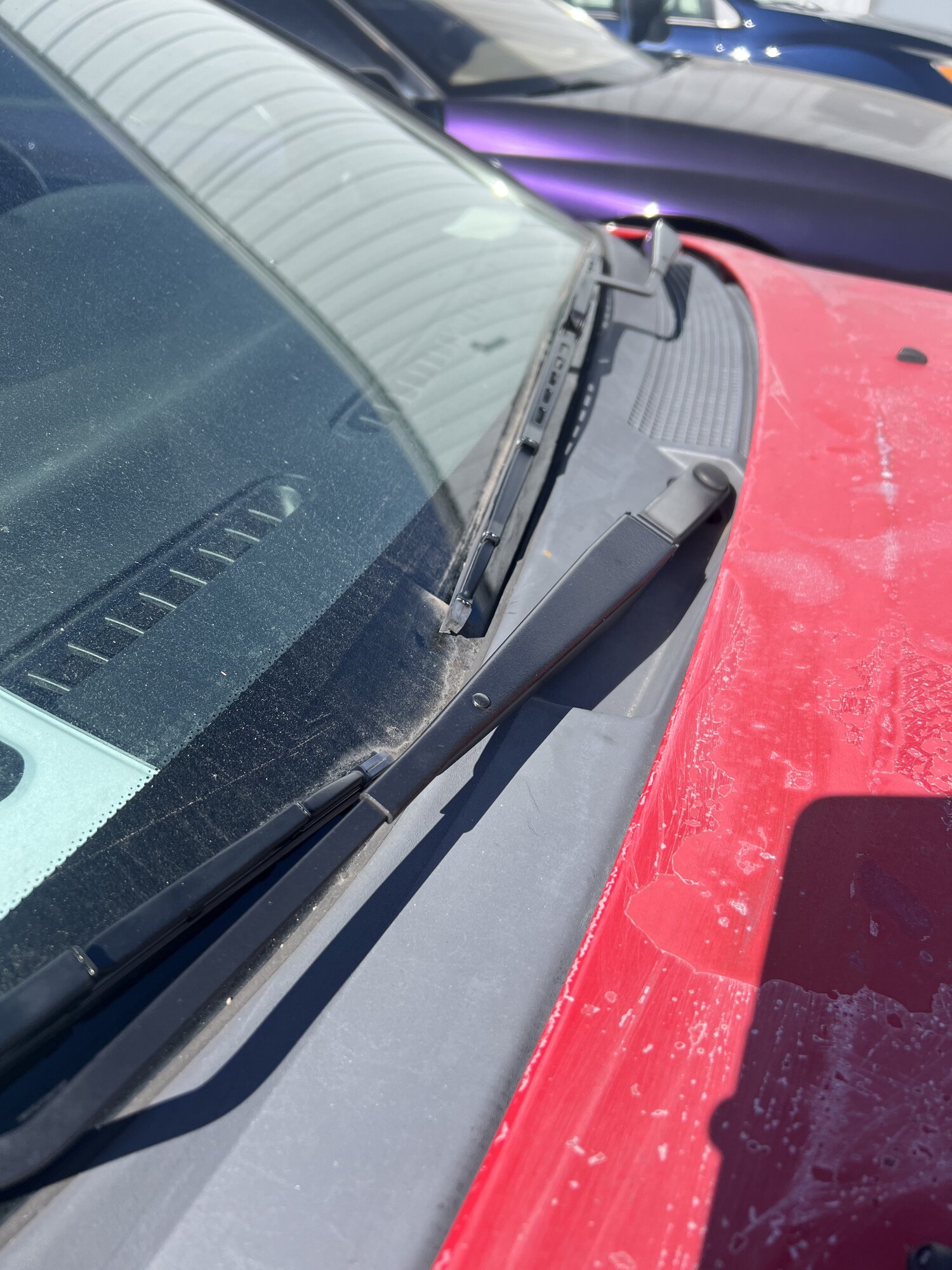

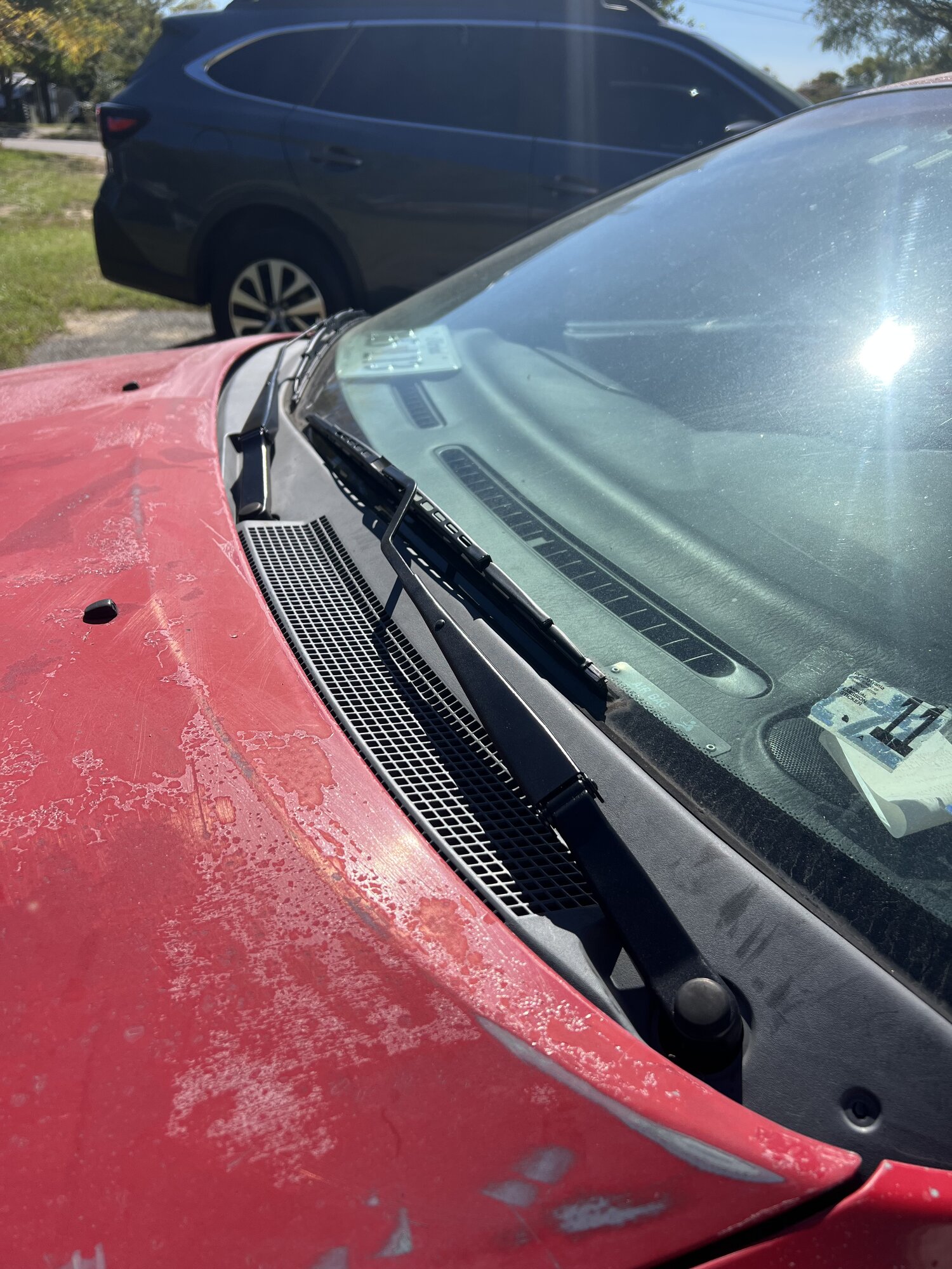

A couple weeks ago i spray painted and clear coated my front wiper arms and replaced my wiper blades. Now i should be able to see where im going instead of guessing where the cars are :)

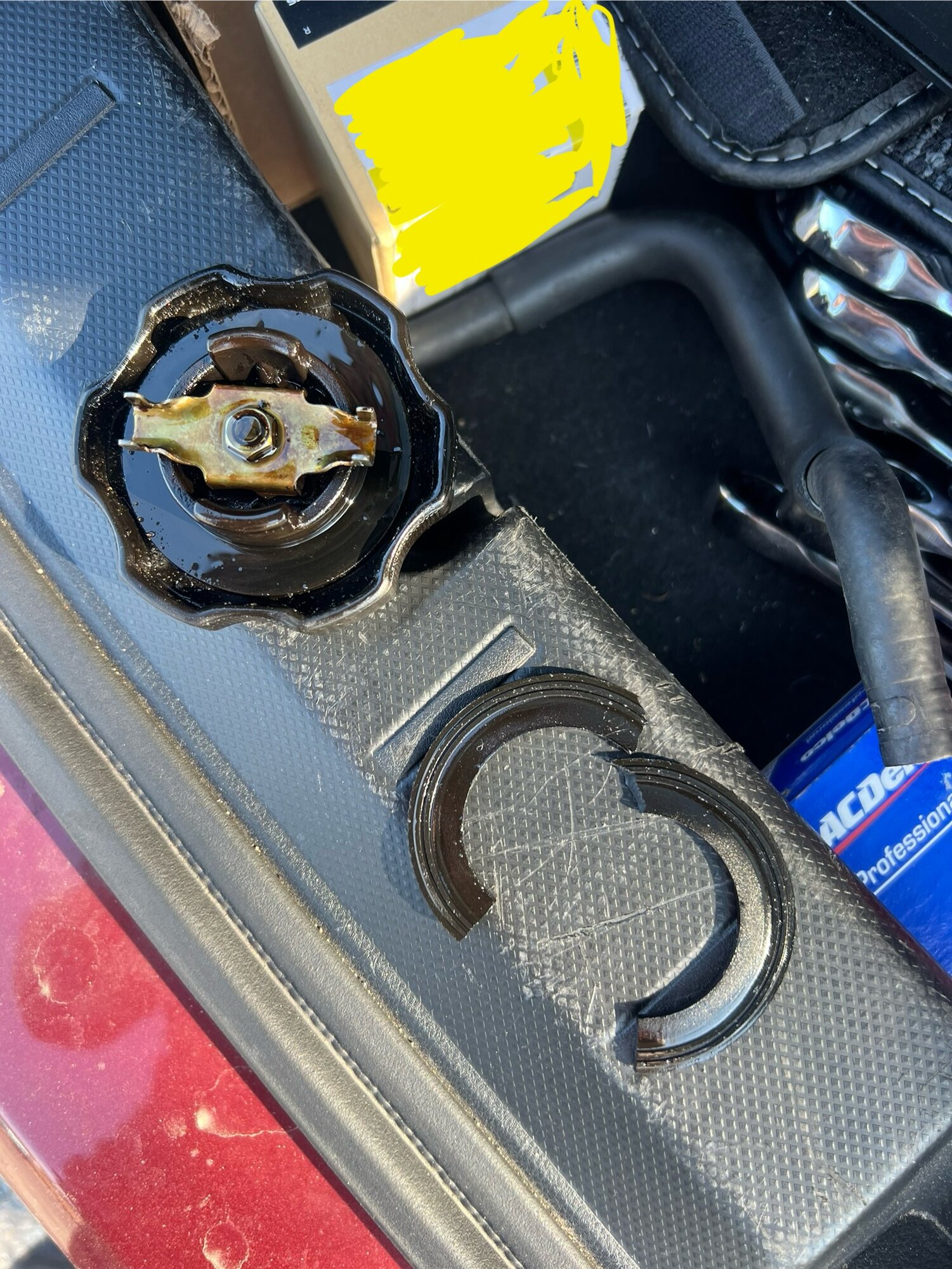

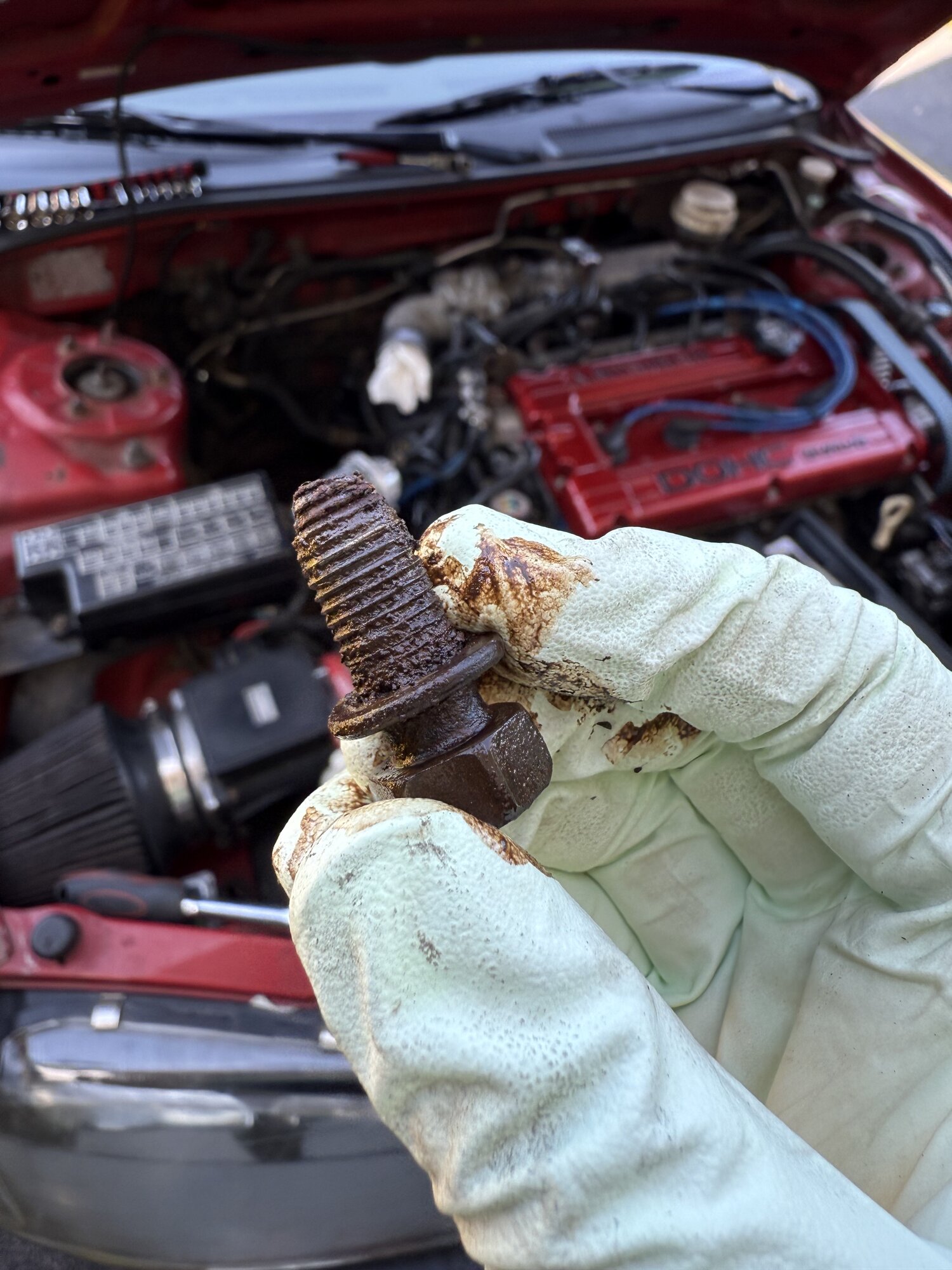

I was up at the car today on my day off of work, and i wanted to see how messed up my oil cap seal was because my valve cover on that side is soaked in oil... and i tried prying it off and snap... it snapped in half trying to take it out because it was as hard as a rock. I ordered a mobil1 oil cap and an extra seal just in case i need to double seal the cap. fingers crossed!

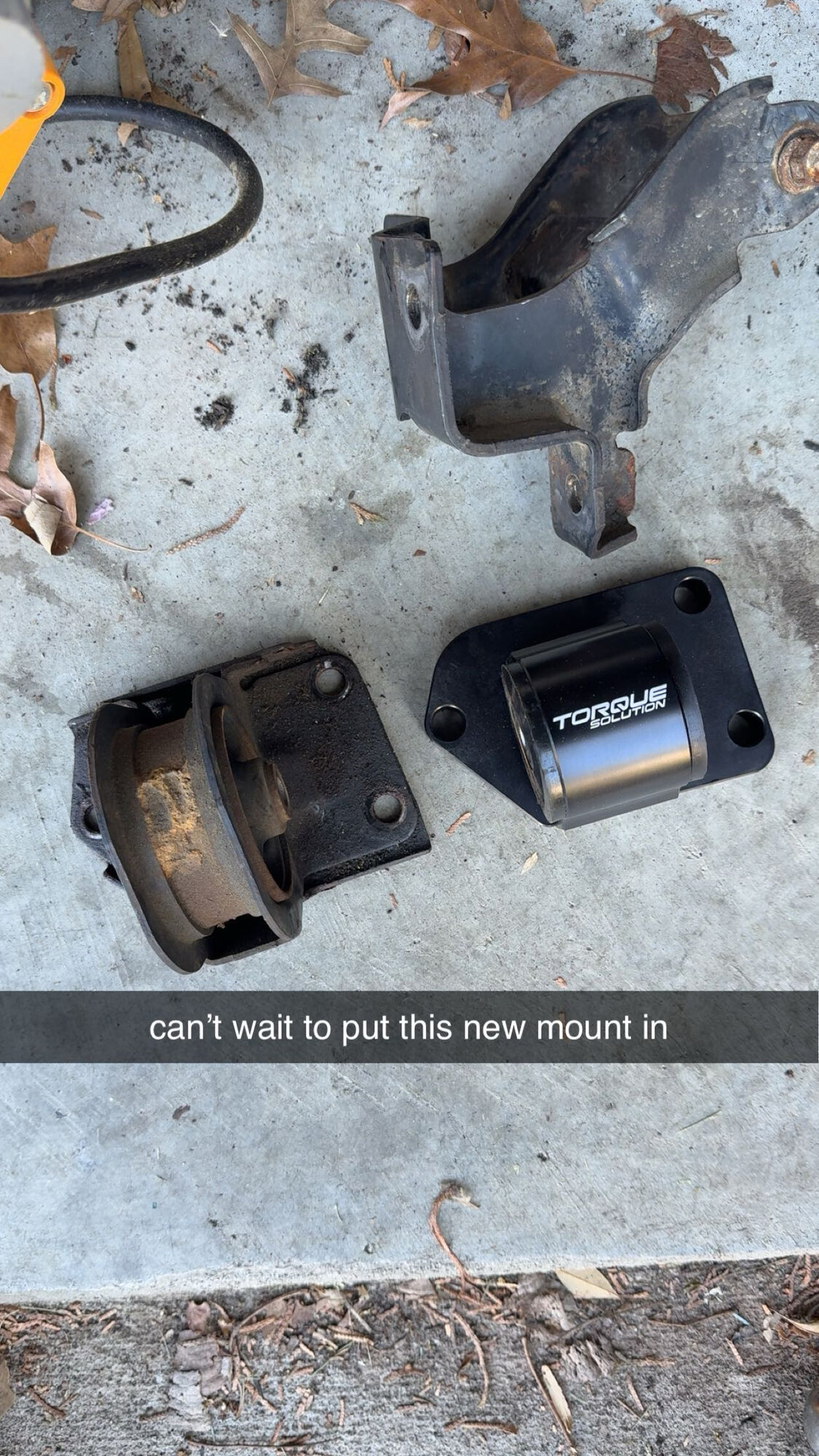

Took a break from the wiring situation and installed my rear motor mount that I've had for a couple months. Those bolts that hold the mount to the subframe were absolutely disgusting and a pain in the ass to get out. Upon the first teardown, I noticed there were no bolts connecting the mount bracket to the trans which explained my clunking and jerking while under load. Hopefully this will keep that under control from now on. I am going to try to grab a spool of wire this week for the AFR gauge wiring and borrow tools from my buddies.
