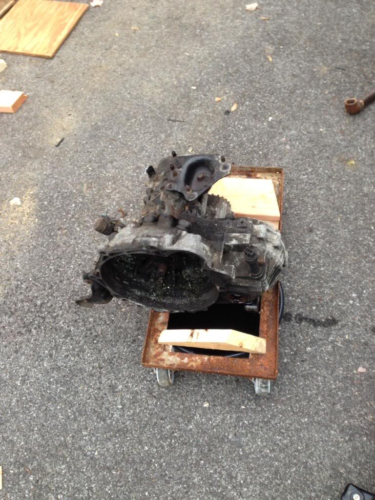

So I finally got around to pulling the tranny and replacing the clutch. This was my first time ever doing anything like this and I'm pretty proud to say I did it all on my own. Took me pretty much a whole weekend because my ball joints did not want to cooperate. Lowering it down went pretty smooth with a little help from my dad. So when I bought the car the previous owner told me he replaced the clutch and didn't do it right so it wouldn't go in to gear. Me not knowing much believed him. He also told me that was the only problem with the car. Meanwhile the tires are bald, the paint on the wheels is chipped and just destroyed and I already had to replace all the gas lines between the tank and the filler neck because there was a hole the size of the head of a nail :ohdamn: So this is what the clutch looked like when i got it out......something tells me he never did anything to it.
The starter looked like it hasn't been changed since 1998 LOL I have a new one all ready to go in.

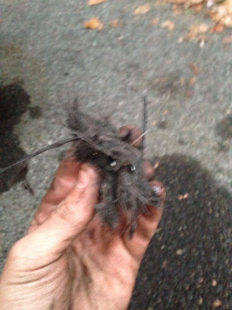

When I was going to unbolt the tranny to engine bolts I only found 3 of the 7 bolts that were supposed to be there. Does anyone know where I can get more bolts like those? After I got the tranny separated a little of this fur looking stuff was popping out of the bottom. Maybe the car was sitting before I bought it and a mouse was making a nest?

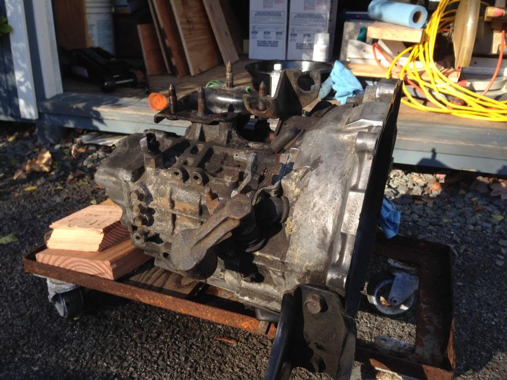

Finally Out!:hell yeah: I was so relieved. Needs to be cleaned up and painted for sure. Going to go with a aluminum look hopefully similar to the stock color.
I'll be replacing the axels while they're out.
My next plans are to get the tranny cleaned up and painted. After school on thurs I'll be doing that. Than I gotta order a new flywheel or have the old one resurfaced. Clean up as much of the engine bay I can and than put the tranny back in. I have all new brakes and an intercooler kit in my room waiting to go on and than hopefully I should be able to DD this baby!

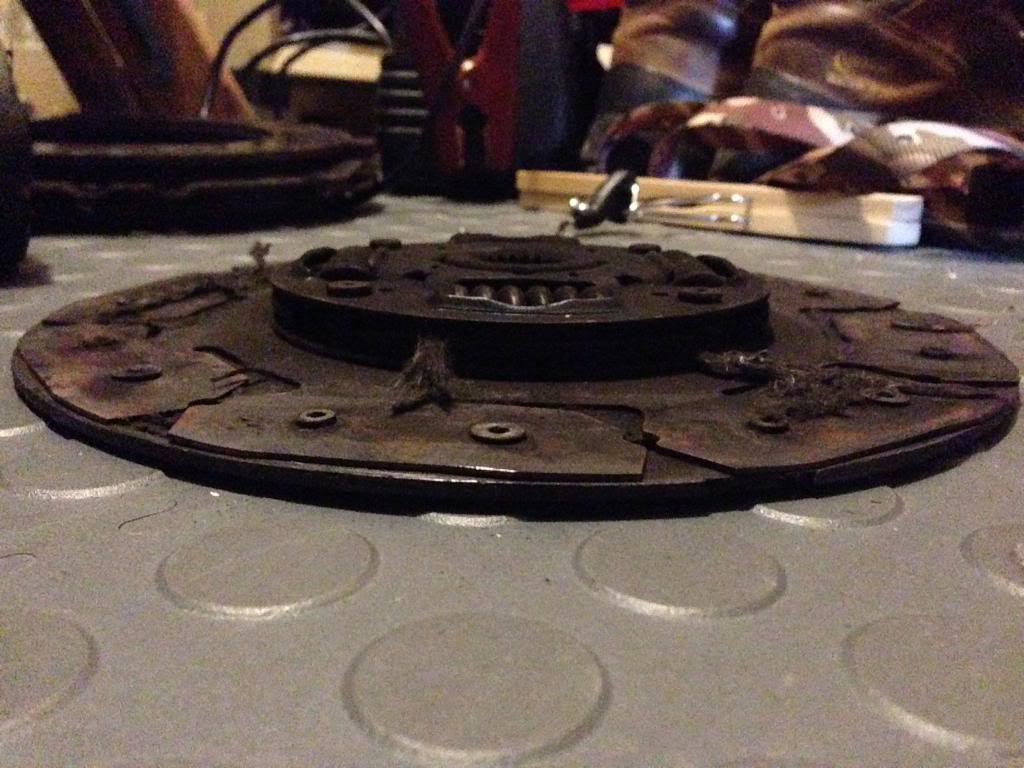

I would write down a plan of action for this car, a reachable goal, and a time limit to accomplish it. Once you do that, price it out. My suggestion is if the clutch which was supposedly "replaced" at one point looks like that, I doubt the proper maintenance has been done on it either. Thats where I would personally start your modding.

Professional mechanic for ten year here. your axle looks fine, unless it is ticking/popping.
that is an oem clutch, he was lying to you. unless he looked the type to pay big money at a dealership, which is doughtful from everything else you spoke of. Starter looks oe as well. i just picked up a 97 gst for 350 and excited to get started on it. good luck!
I honestly haven't driven the car yet so I don't know if they're ticking or popping but the boots are kinda scuffed and what not so just gunna play it safe and get new ones. And yes the previous owner was a huge asshole who lied about the whole car. Good luck on your build also!
The cv shafts will function just like a u-joint. Grab the middle shaft area and the threaded area where the spindle nut goes and try to twist them back and forth (kinda of like if you were screwing a lid on a jar on and off) and see if you feel any play. If it feels solid than there good and don't replace them. If not....again....tear it up!
LOL its all good the clutch is toast!!!! damn but another thing is which i learned the very hard way is dont skimp out on buying parts esepcially ones needed that are important. i found myself buying certain things twice becvause i wanted to take the cheap way out.dont go to light on the flywheel.11 pound is perfect for you i have one myself. get a decent clutch. i bought a fidanza flywheel and and a

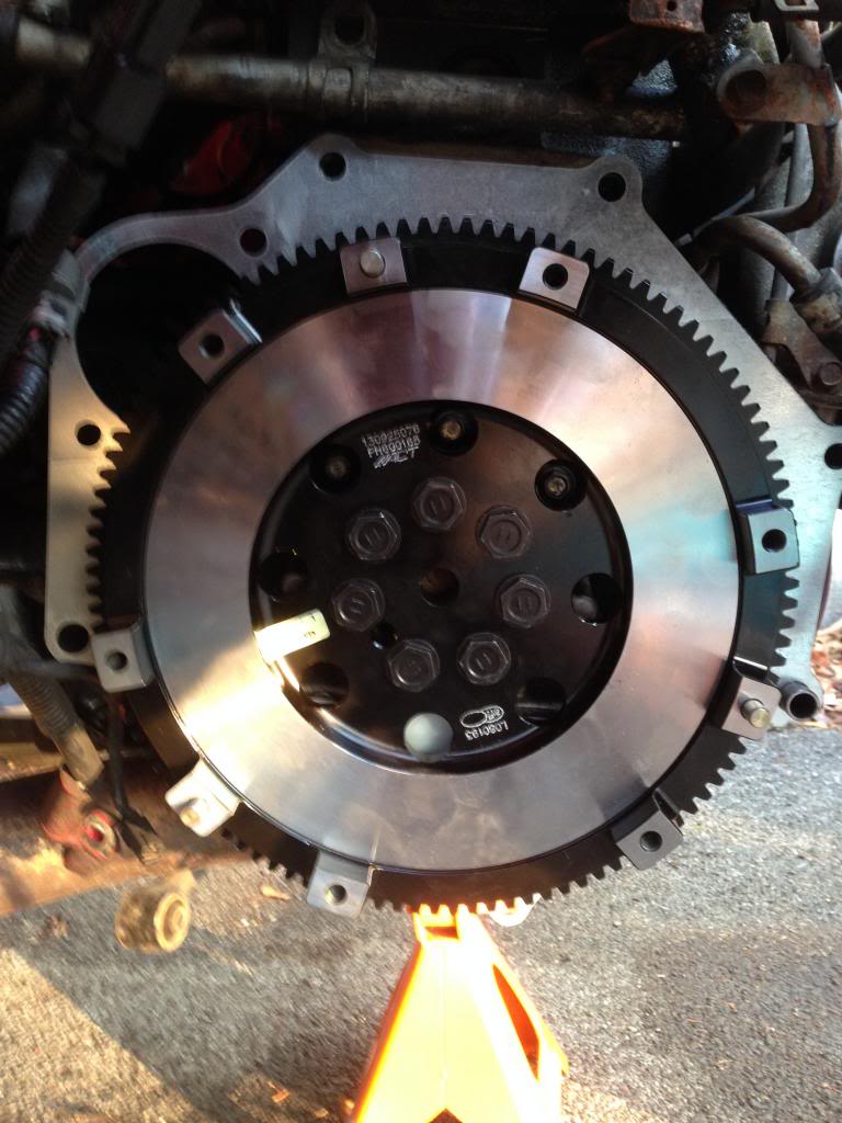

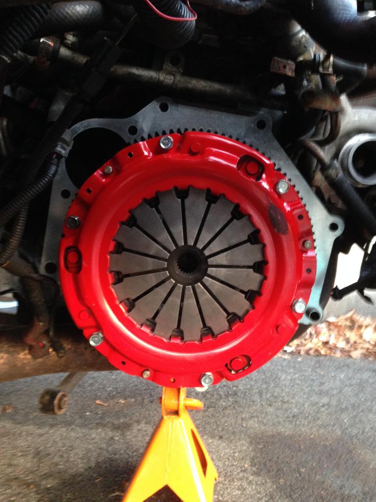

A little update, I got my flywheel, pressure plate, and clutch all mounted up and torqued down. I replaced the clutch fork, pivot, fork boot and the throwout bearing on my transmission. Everything's ready to go back in along with my new starter, I have a fmic kit I've been waiting to put in along with all new pads, rotors and calipers all the way around.

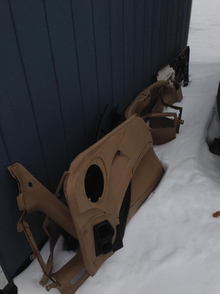

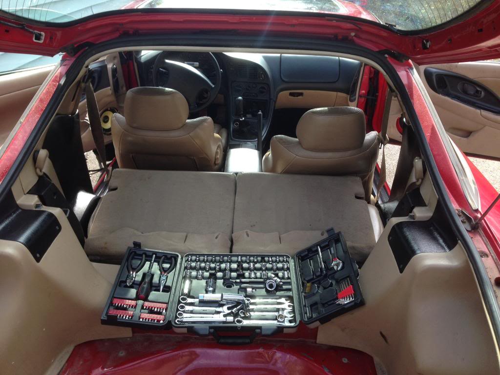

Some time in November I purchased a whole set of gray interior panels to do the swap for my car. Only paid about $200 for all the pieces and all though there's some pieces missing it was still a good deal and with a little more cleaning they'll look real good! Since the weather was real nice today in NY I decided to try to fill my tranny with fluid and bleed my clutch. Well I forgot I'd be needing a large hose to fill the tranny so I couldn't do that since I wouldn't have time to run to auto zone and get back to do it all before I had to go to work so I started to bleed the clutch when I realized I must have bent one of the hydraulic hoses for the slave cylinder since it was leaking brake fluid like crazy. New lines are already ordered and I'll be picking up a hose to fill the tranny. Since I had nothing else to do I decided I'd finally get all those gray trim pieces of out my hatch and work on the conversion and since it was like my third time install the interior I finished it real quick. I also test fit a spoiler I got from a member on here. It's in great shape and is going to be a Christmas present so it's not being mounted yet but I "test fit' it because I was too excited to see what it'd look like :D
Anyway! Out with the old in with the.....new to me! I still have a few small things to get like seat belts and the rear seats and than eventually nice racing seats, maybe spaarcos :pray:
