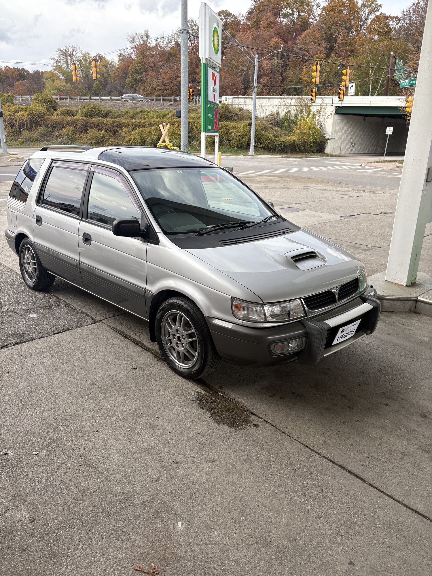

In the process of that currently, looking at it tomorrow, already have a transport plan in process and will be bringing it back to Milwaukee after that. This one is a silver 96 RRGT 5 speed.
Add me in, Tim Zimmer - https://www.facebook.com/tim.zimmer.35
I am not worried about parts, I know it will be a treat, I have numerous contacts from my business dealings internationally.
Are any of the other ones in this country a 96? Or 95's only?
There was a '96 AT for sale in Washington, but super overpriced and no report of a sale. The two other dudes in the USA, and the one gent in Guam, have '95s.
The '95s are a hodgepodge of 1G and 2G parts. I learned the hard way that my car, same production week as Chris's, has an entirely different timing belt and water pump.
Epc-Data.RU is very useful. Amayama, Megazip and Partsouq have come through.
Hope to hear good news soon!
I build DSM transmissions for a living (TMZ Performance), and I regularly use Amayama, and have many friends in Australia and contacts in Japan. I also have all dealer software for all models worldwide.
The rear subframe and control arms, shocks and spring mounting are definitely unique, I will take a look at it in a few weeks when I get the car back home.
The front is a mixture of 1g and Evo 1-3 subframe, control arms and suspension, then a 13T TD04HL turbo, 7 bolt non-split thrust block, with a 97-99 ratio final drive trans and tcase, with essentially a 2g DSM trans for gear ratios and components, then it uses an evo 1-3/RVR shift selector assembly with RVR/chariot specific shift cables.
RVR style front suspension, with unique to the Chariot rear suspension, with a 1g DSM / RVR rear diff carrier and 3 bolt 1g DSM style rear axles and viscous rear lsd diff. Its definitely a hodge podge of parts.
I am going to get it through emissions, register for collector plates, and then do maintenance then some modifications. Only current mods on this vehicle are wheels, lowering springs and a steering wheel.
It will need some minor cosmetic repairs along with an upholstery repair to the driver seat, door panel vinyl seam repairs, a little PDR and a good detailing. I will also need some heat vent flaps as this one has a couple broken ones.
I'm going to do just a light 300-350whp build on it and use my spare AEM EMS V1 , number #0001 in it. Being that it is 1 of 155, it deserves 1 off parts in it.

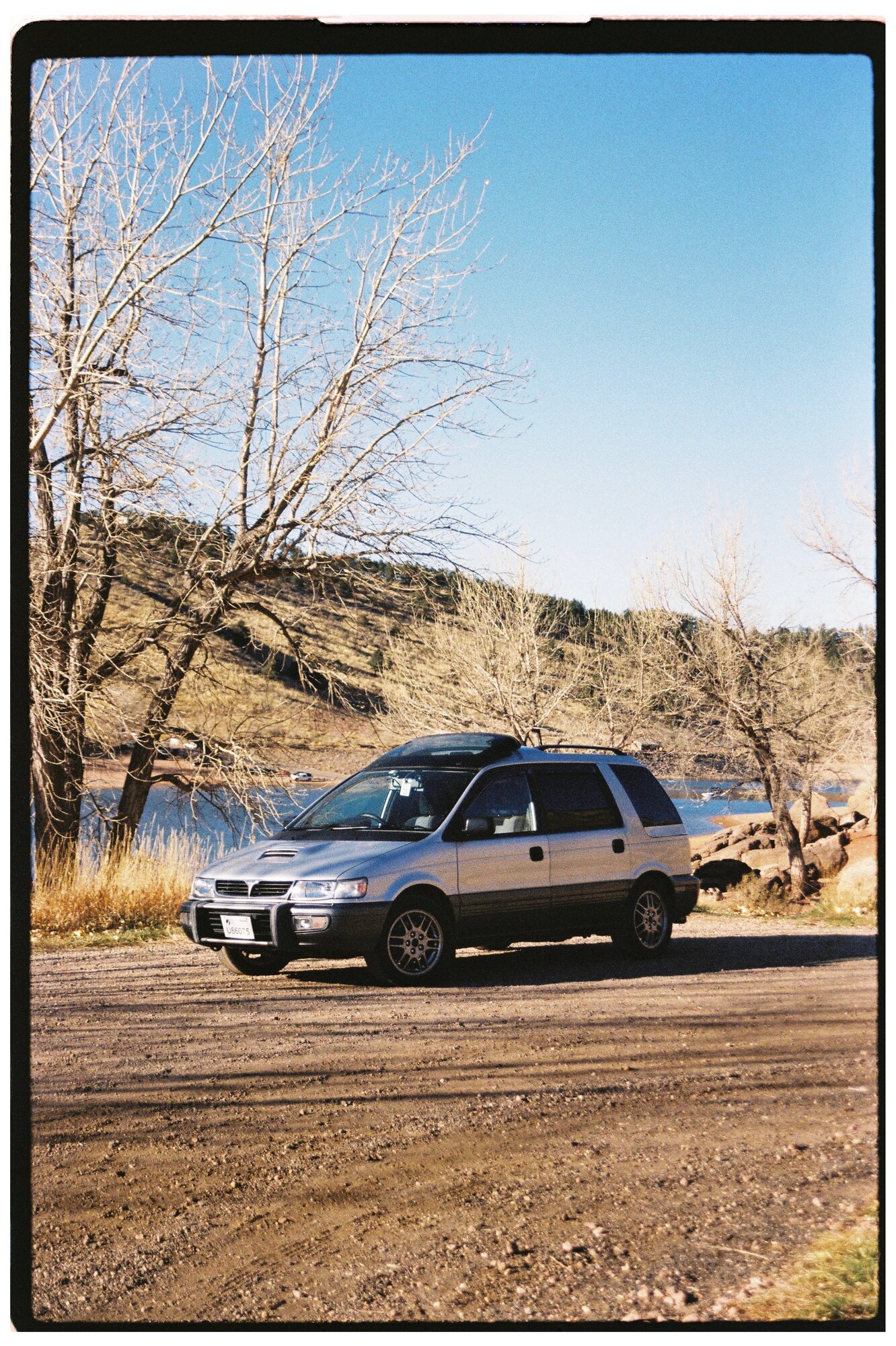

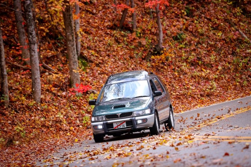

Overall, the car has been fantastic. Since I updated you guys last, I spent six months in Oregon, then drove it to Great Falls, Montana. Up to Calgary for a car show, then down to Denver and Salina, Kansas for work and play. Back to Denver for a wedding, and then a two-day haul to Knoxville for work. This car is so awesome! Hoping that my investments in maintenance will pay off in years of reliable service.
I've been hitting the Tail of the Dragon every day I have off. It's the best car autumn I've had in years.
