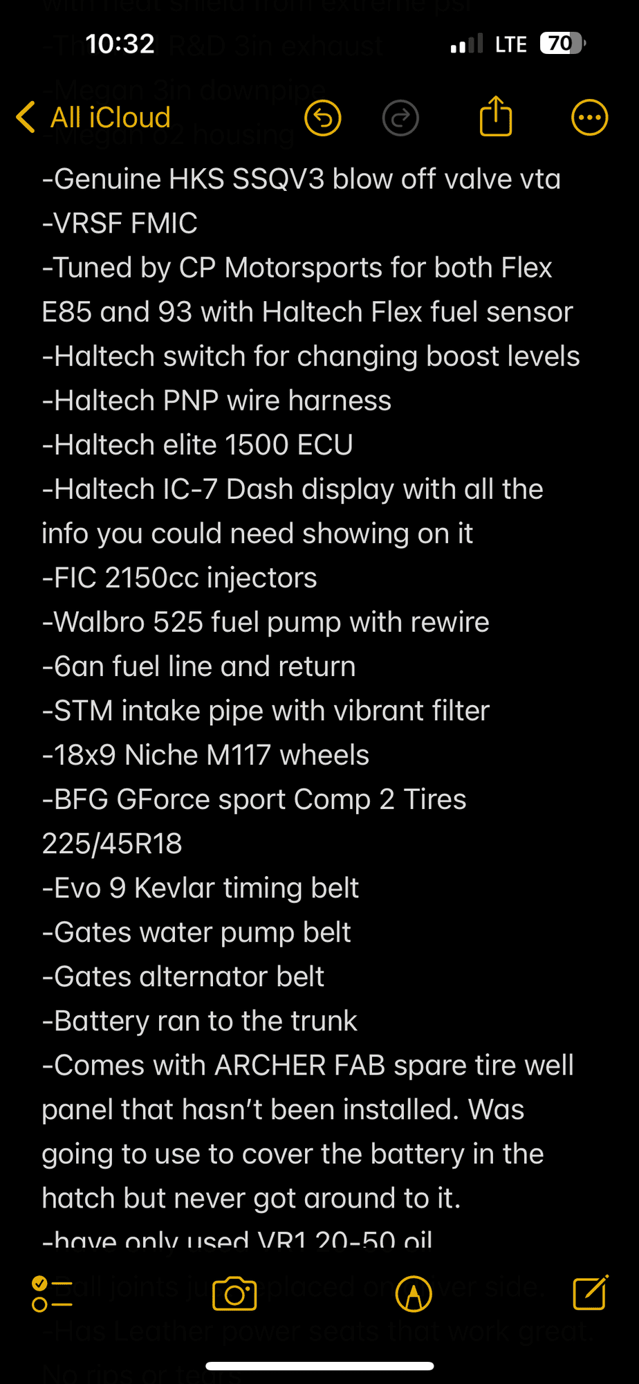

    VRSF FMIC, Hks ssqv4 bov, FP BLACK Turbo, aem fuel rail, aem fpr, FIC 2150cc injectors, AEM analog gauges, 3" thermal R&D exhaust, Megan racing o2 housing and down pipe, Walbro 525lph fuel pump, Haltech elite 1500
    Mods-Engine:
    6 bolt Block bored and honed .020 over, weisco 1400hd pistons, eagle rods, AEM TRU TIME cam gears, evo ix Kevlar timing belt, gsc s2 cams, ported and refreshed 7 bolt cylinder head, L19 headstuds with an MLS head gasket,
    Mods-EMS & Logging:
    Haltech elite 1500 set up for speed density and e85/93 dual maps
    Mods-Drivetrain:
    Kiggly 6 friction clutch pack, ipt shift kit/worked valve body
