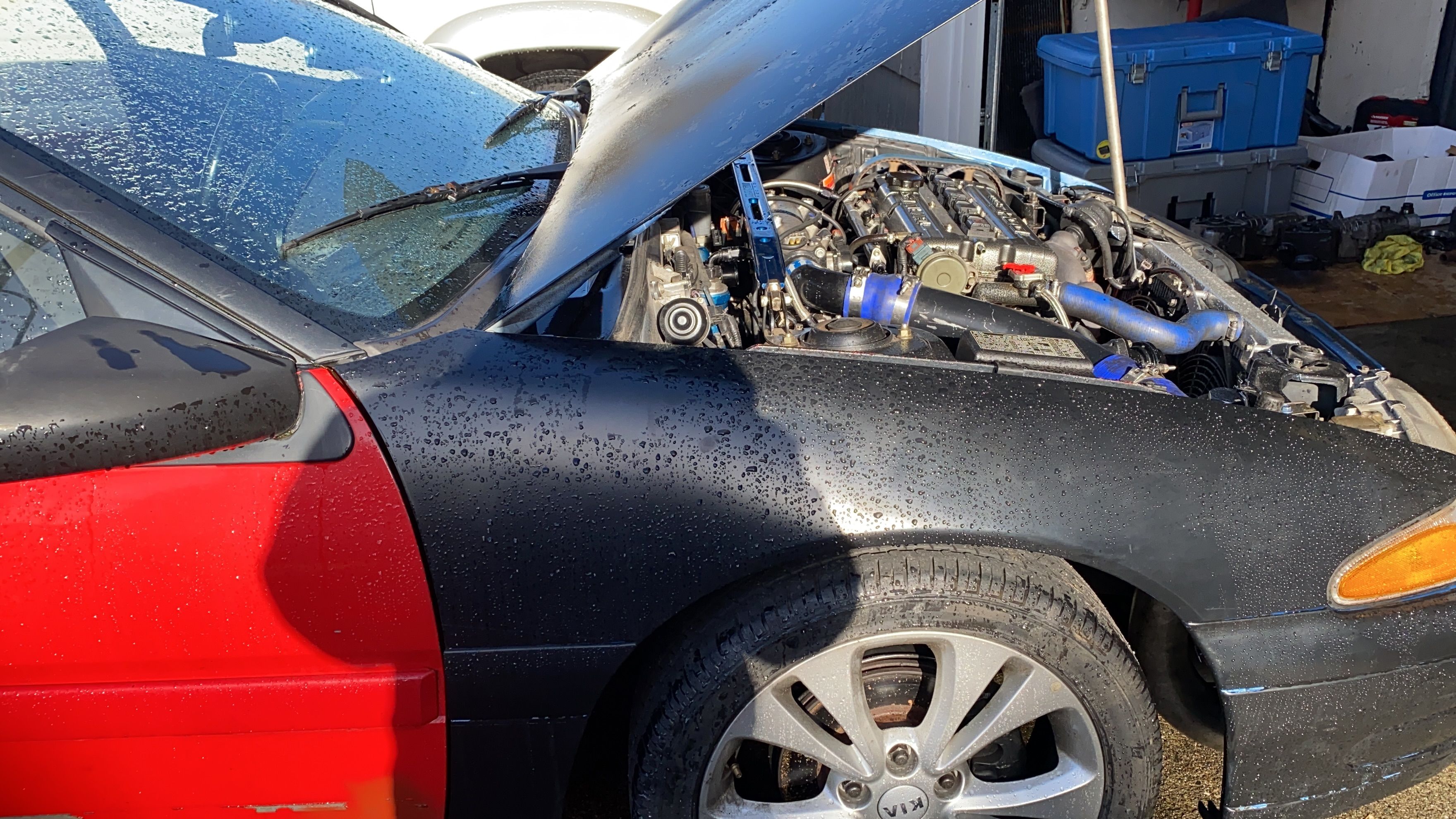

- Ownership Status
- Currently Own
- Year
- 1991
- Model/Trim
- Eagle Talon TSi AWD
- Turbo Type
- GT35 Variant
- Drivetrain
- AWD
- Transmission Type
- Manual
- Build Type
- Street
- Drag Race
- Mods-Bolt-on
- Mishimoto rad and intercooler
Snow performance water meth
Custom 3” exhaust
Custom gauges
- Mods-Engine
- Buscher racing stage 3 shortblock 2.0
Evo3 head, intake and manifold
Hks 272
Gtx3582r 67mm
Precision 880cc injectors
Fuel lab filter and regulator with russel 3/8 braided line and whalbro 250
- Mods-EMS & Logging
- Dsmlink v3
- Mods-Drivetrain
- Act 3600 clutch, stock 1g trans and case
Stock drive lines and axles
Stock diff
Energy suspension bushings
Tien coilovers
Greddy short shifter
- Mods-Handling
- Stock steering
Kia optima wheels
- Parts Wishlist
- FIC 2150cc injectors
Whalbro 450
Custom intake and nissan 90mm TB
Evo wheels
New wiring harness
Built auto with shift box, or manual
Built t case, driveline and axles
Evo rear and front diff, welded center
Straight pipe
- Background
- Got it from my brother, its my racecar but remains street legal
