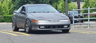

1991 Eagle Talon TSi AWD Vehicle Profile & Build Thread
Street Build
Bought a non-runner 91 Talon for $1500, and wasn't told it was a flood car until I pulled the interior and found dry silt everywhere. Everything from my "GSR4" is being transferred to this new unsinkable DSM.
The Unsinkable Taltanic

Background
5/25/25 crashed and totaled the my "GSR4", but all the important bits survived thank god, and this is its replacement shell I found the very next day.
