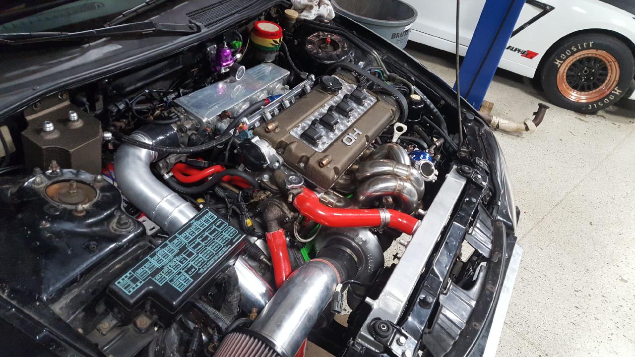

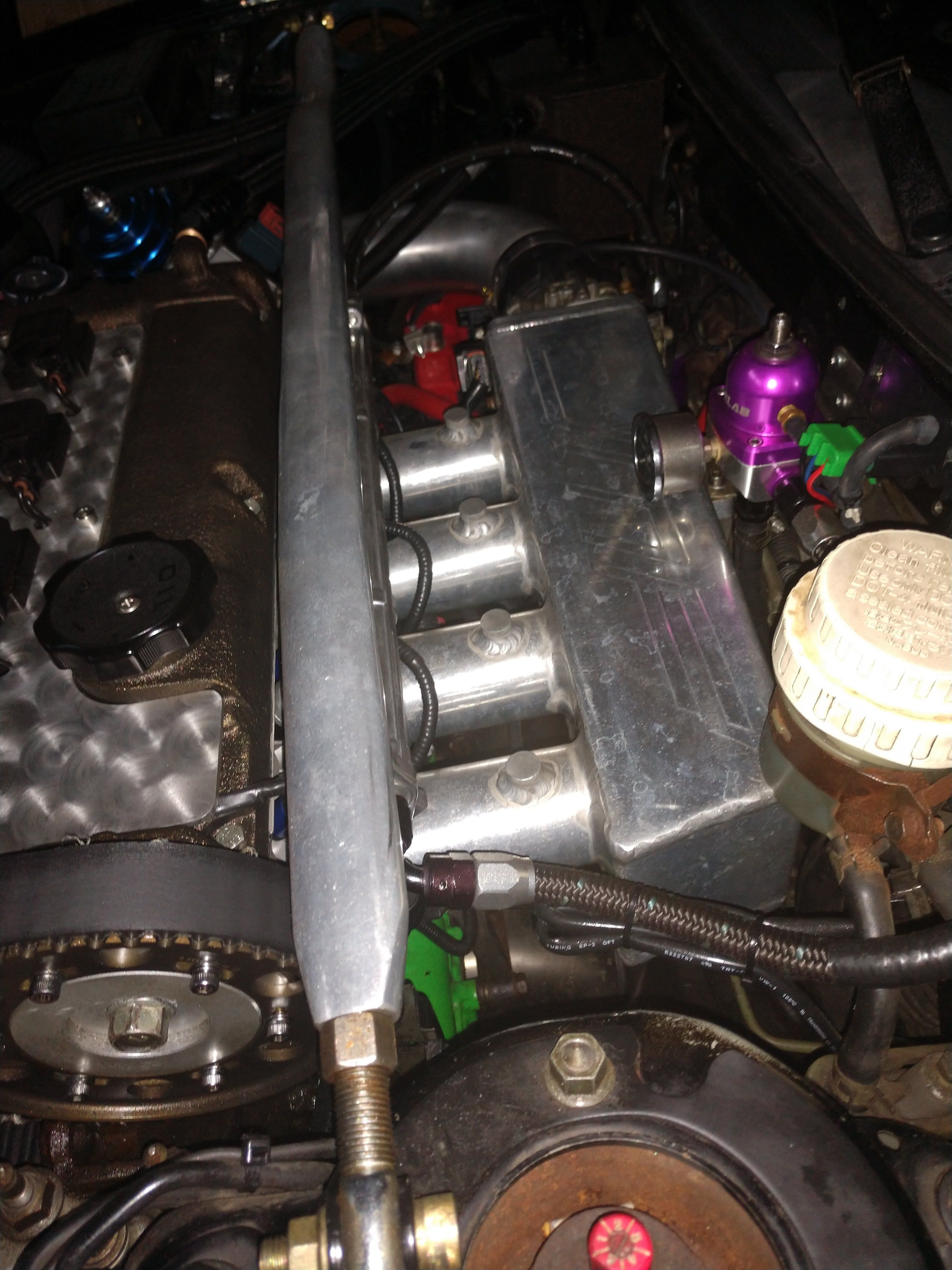

- Mods-Bolt-on

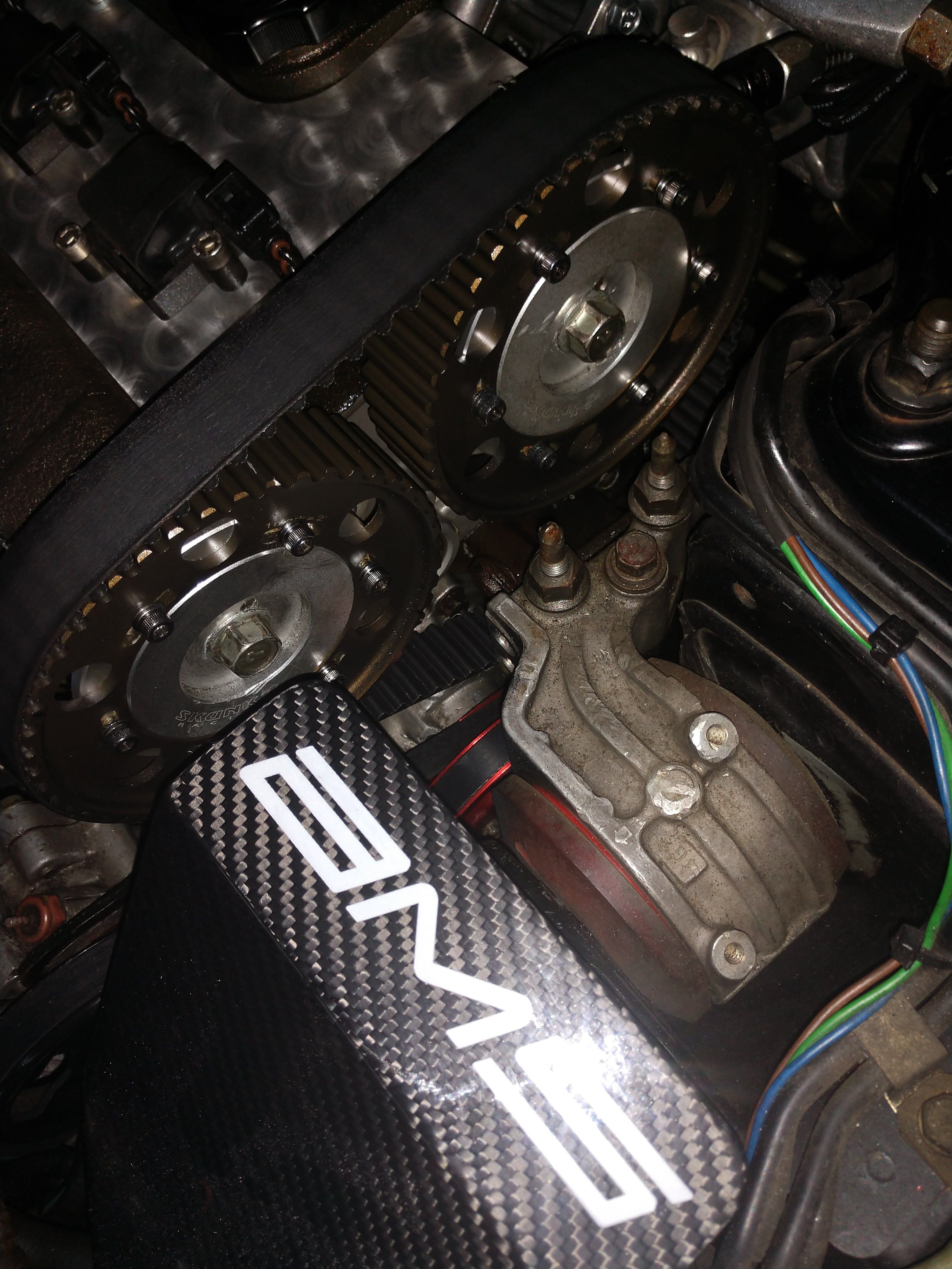

- Skunk adjustable cam gears,
JMF intake manifold,
STM motor mount inserts,
custom built three stage catch can fabbed by Dominique at AMS Performance.
custom shaved valve cover,
coil on plug setup
,2 8an ports from valve cover to catch can,1 8an back to intake,
mishimoto radiator
FUEL
E85,
walbro 255 in trunk
, Bosch 044 inline,-8 feed and -6 return lines,
fuel lab FPR,
fuel lab in line filter,
fuel injector clinic 2150 cc injectors,

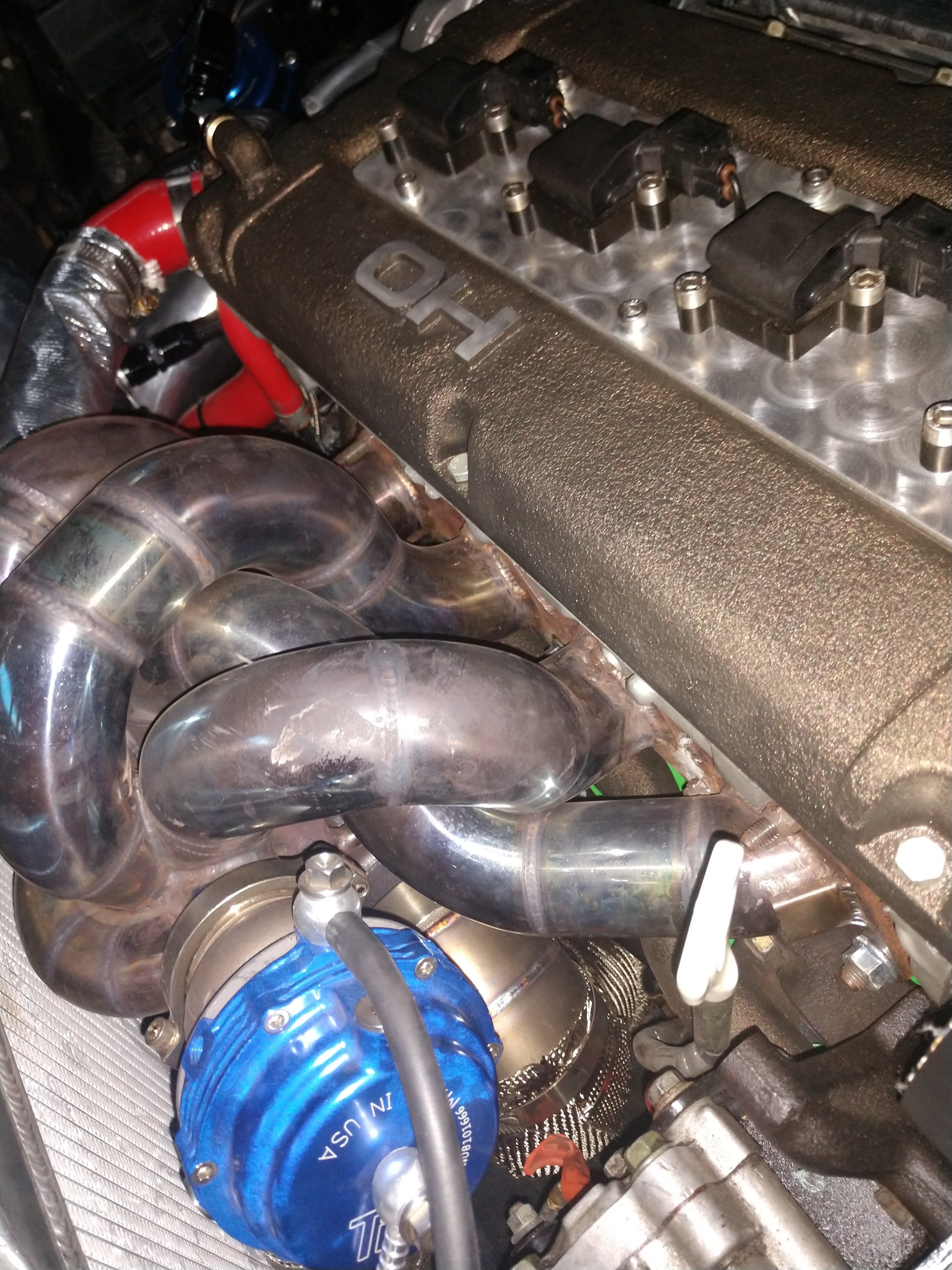

TURBO
Borg Warner S366 ett twin scroll
modified outlet,
3inch custom aluminum charge pipe,
Tial BOV,
Dark performance manifold,
Tial MVR waste gate,
custom made 3.5 inch pie cut downpipe to fit around power steering pump and alternator.
- Mods-Engine
- 7bolt block
,Evo8 forged pistons and rods (alpha edition from AMS),
Mcad dowels in cradle,
oil squirters plugged,
all ARP hardware,
black top CAS
, fully built head
cryo treated DCM valves
, 1mm over intake/exhaust valves
, bronze valve guides,
ferea beehive's,
HKS 275 cams,
7 bolt head intake ports ported to fit bigger 6 bolt intake manifold
.balance shaft removed,
- Mods-EMS & Logging
- DSM link V3 tuned speed density,
oil pressure ,
boost,
volt,
AEM wideband digital
, GM 5bar,
Apex turbo timer,
- Mods-Drivetrain
- Exedy three puck race clutch,
Fidanza lightweight flywheel
,short shifter,
built trans,
- Mods-Handling
- Front struts brace
Rear strut brace
Megan coilovers
Slotted rotors
