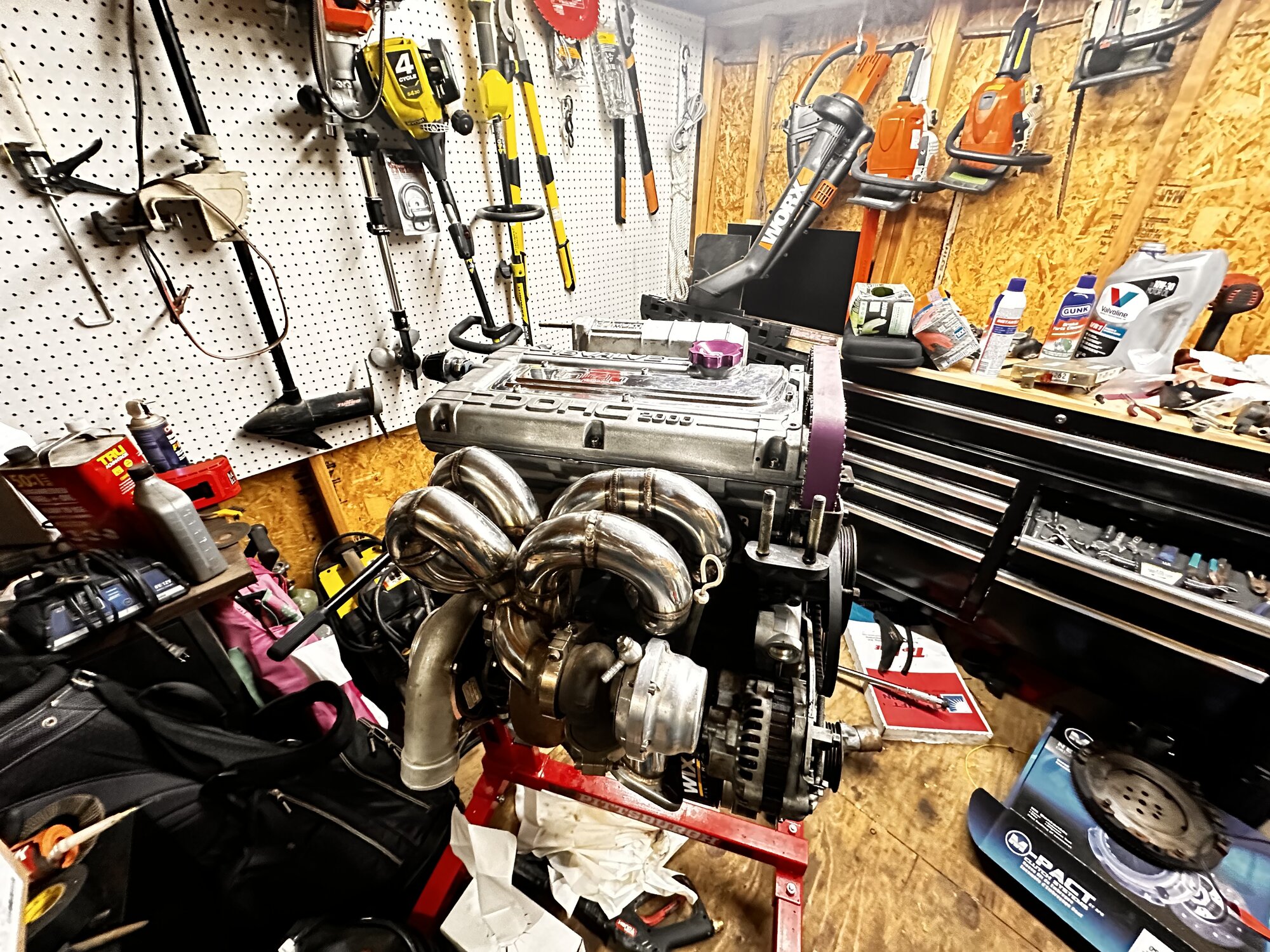

Exhaust:
3” Stainless steel hot pipe
3” Stainless steel STM down pipe
Custom 3” - 2.5” Stainless steel test pipe
2.5” HKS Catback
Intake:
3” intercooler piping hot and cold side
4” Intake to Turbo
Unknown 3.5” thick FMIC
Forge BOV
Tial 44mm wastegate
Cooling:
Unknown 2” aluminum radiator
Turbo:
Garrett 60-1 .70 a/r
Stainless oil feed from OFH
-10an vibrant oil drain

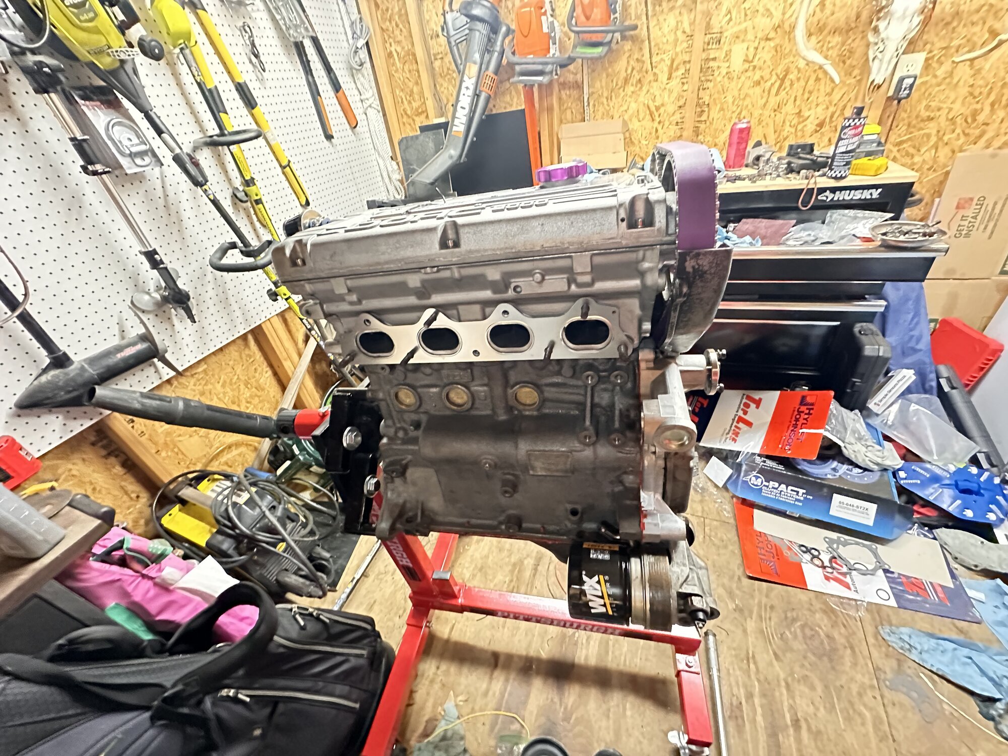

Mods-Engine
Cylinder head:
GSC STD Exhaust and Intake valves
Top line valve seals
BC Single spring titanium kit
BC 268/272 Camshafts
Ported and polished intake and exhaust ports
ARP Cam tower bolts
ARP Cam gear bolts
HKS Cam gears
Kiggly oil pressure regulator
Block:
Kiggly main girdle
K1 H beam rods
Weisco 86mm 8.3:1 pistons
Clevite tri metal main bearings
King xp rod bearings
ARP main bearing studs
ARP rod bolts
Full balance shaft delete
