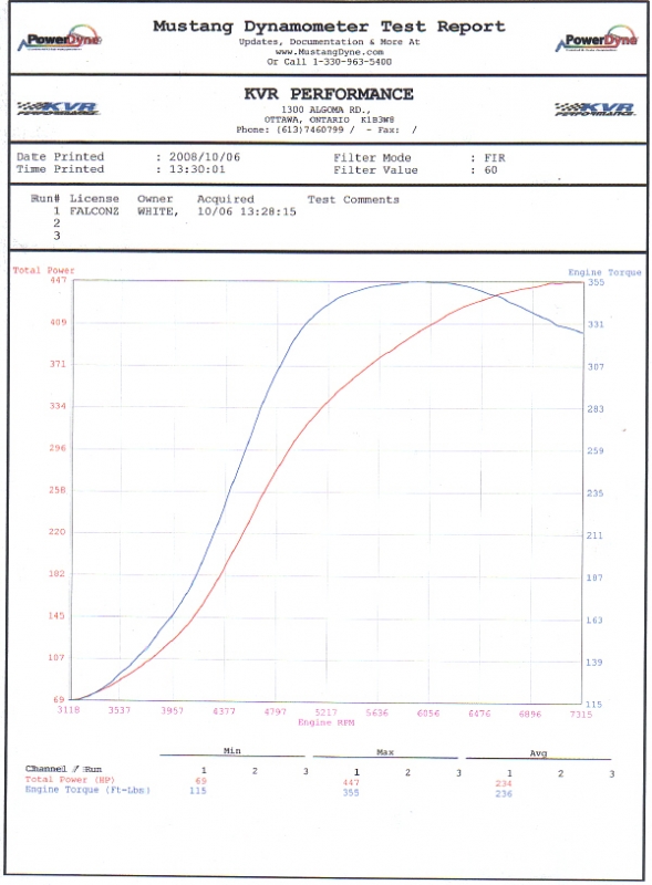

Dyno TQ
355.0 lb/ft
Dyno Type
Mustang Dyno
Dyno Sheet Photo Link
Dyno Shop Name
KVR Performance AWD dyno
Dyno Session Details
Nitrous : No Nitrous
Fuel Used : Pump gas
Turbo : FP 3065
Boost : 32
